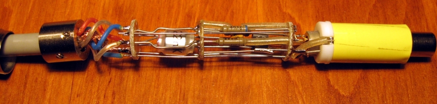

Construction-wise, bootstrapping and guarding are used in many capsule buffers to get to the required impedance levels.
You can't bootstrap out noise, the diode biasing is still limited (noisewise) by the slope through the origin which is related to Is.
The charge amplifier puts the capsule into a short the highest distortion mode and as B&K showed a small negative capacitance minimizes the distortion. So what is the source of 10% distortion if the capsule has nothing to do with it? I don't have AES access. The 0.003% rules out any real capsule at reasonable SPL from simple geometry considerations.
BTW most commercial mics use 1-5G resistors and someone claimed a few up to 50G (this would possibly be problematic with FET leakage variation). I've only ever seen one or two recording mics that use bootstrapping.

FWIW, in East Germany they didn't have anything higher than 200Meg, so Gefell had to use heavy bootstrapping of both the polarization feed and the FET bias to get a reasonable LF corner. At the cost of noise (the MV201 is way noisier than the B&K clone).
Well, probably they had higher valued resistors similar to those Victoreens but they were too expensive or too large or too scarce for use in the Gefell preamps...

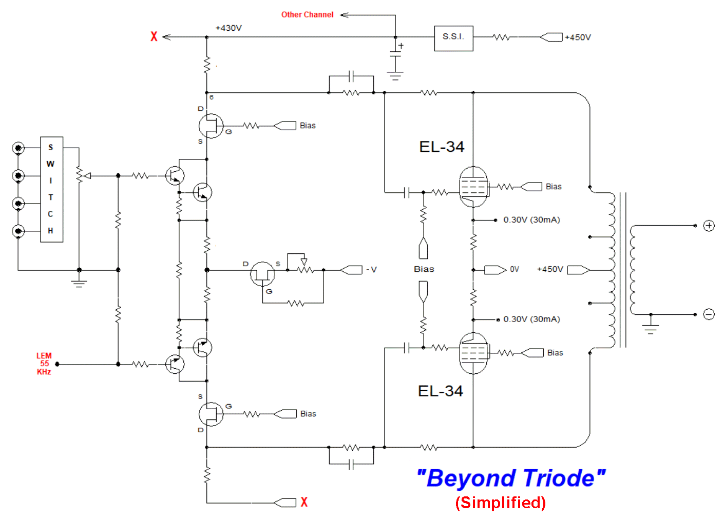

Re crediting Allen: I will add that Allen has left some interesting legacies behind. Such as a tube design that is so convoluted and complex that it will never be manufactured IMO. I can discuss the design but I cannot show the schematic (only five have it and the are the old Vacuum State gang), but at the heart of it was a tube output stage that had the Anodes impedance of the output tubes reduced to lower than that of a Triode, in fact half. Allen went "Beyond Triode" and we have since developed a design that can be manufactured. See simplified schematic attached below. The non-tube front-end was computer modelled by the head of Power Electronics, an Elon Musk company that is part of SpaceX. The design needs massive voltage swing. It uses power MosFETs and it can swing 1800V peak-to-peak.
Allen's original design was all tubes, but the front-end power suply came off the Anodes of the output tubes, so that he could double the voltage swing, hence all the power was applied at only one point, the centre tap of the output transformer. There was no separate power supply for the tube front-end. This gives you just an idea... also positive feedback had to be balanced in the output stage (via the Screens) because the Cathode coupling to the transformer slugged the gain down to virtually unity. The positive feedback was added to give the output stage a gain of two. And there is more... but I just want to give you the general idea, whew!
So a few of us, including Brian Gurr in Auckland, New Zealand, still keep Allen's legacies going and we never cease to credit him. But we have also moved on.

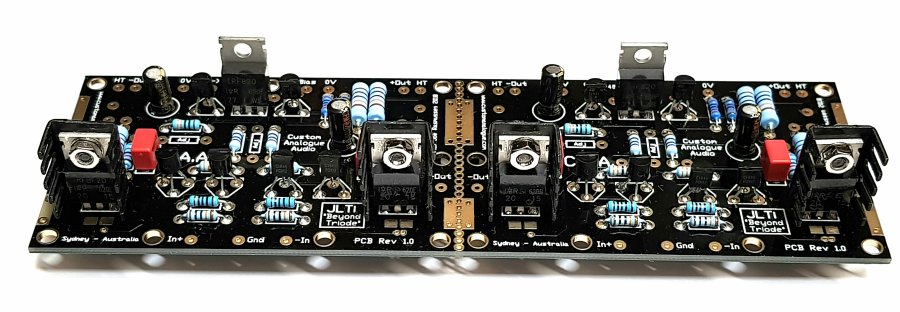

Oh, one more thing, Allen had an engineering solution to drive 75 Ohm coaxial cable with a clock signal. He never lived to find out that he was suppressing a glitch that causes secondary form of jitter. This has been (I got) confirmed by two VLSI engineers, one who is currently working for Intel Corp. If he only lived to find out, sigh.
