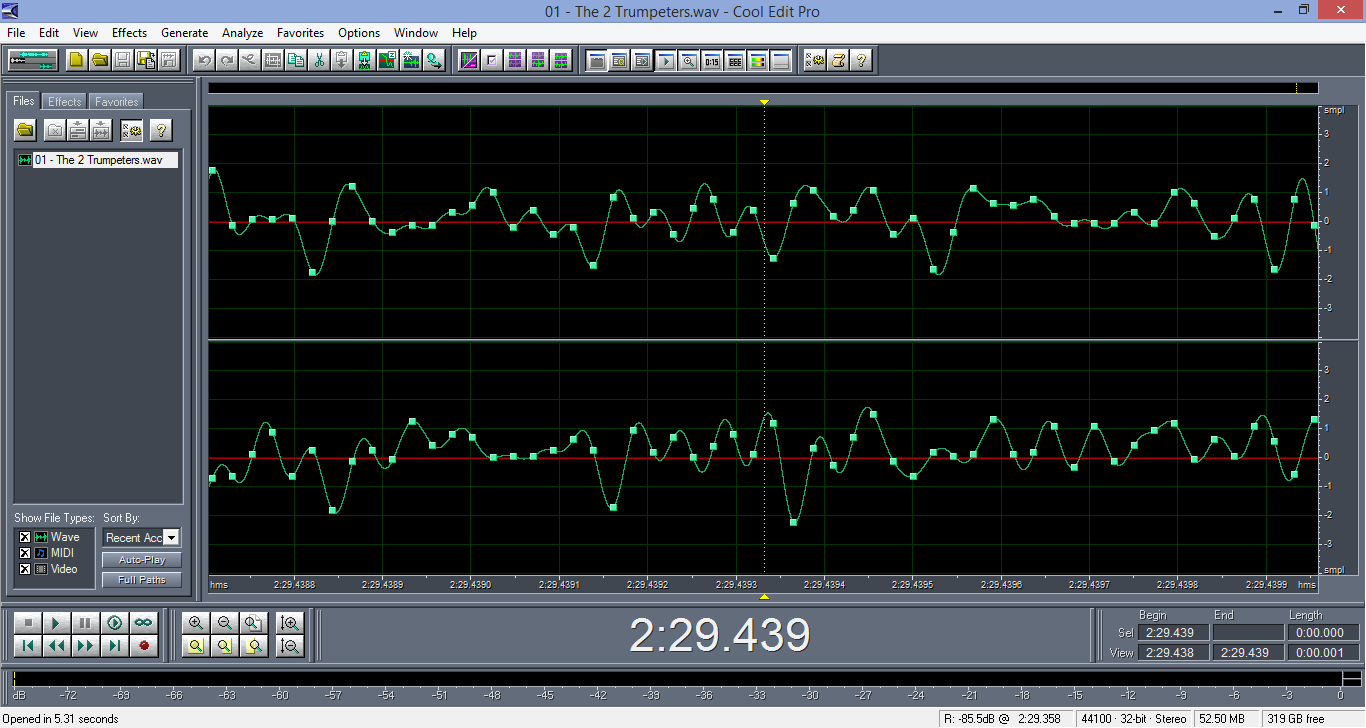

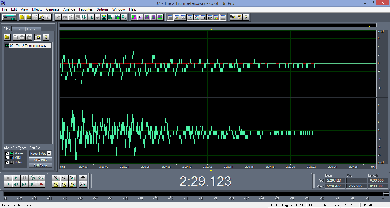

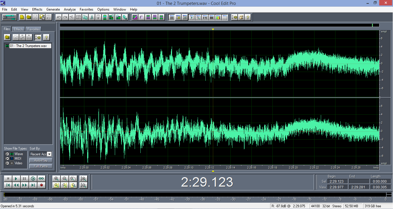

Dan, I will make my last attempt to get a meaningful information from yourself, about the files.
I am speaking about the files you linked yesterday. The two files I speak about are:
01 - The 2 Trumpeters.wav (I will call it "01")
and
02 - The 2 Trumpeters.wav (I will call it "02")
extracted from
Two Trumpeters.zip
Can you tell which is the original - 01 or 02?
01 is a 24bit coded file with 24bit LSB resolution. It can be seen when the music fades into noise. The noise might be the noise of your audio chain or the noise from the recording.
02 is a 24bit coded file with only 16bit LSB resolution. And, it has no dither. Again this can be told from the music fading into noise at the end of the sample.
My questions:
1) is 01 or 02 an original?
2) why 02 16bit file is not dithered?
3) do you realize that it is impossible to compare a true 24bit file with the 16bit undithered file? The difference goes for a different format, not the audio chain differences.
Plots attached again to show 24 x 16 bit undithered file 01 x 02.
P.S.: As a reminder, I can tell the difference in a foobar ABX with 100% success and I have posted the protocol. However, the audible difference goes for a format difference.

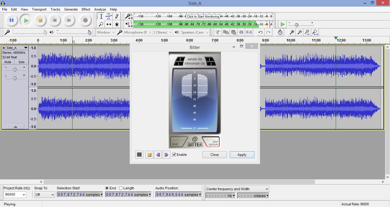

If you know how to use plug-ins with any of these, let me point you to two useful and free (!) 🙂 tools for checking digital audio for some possible problems. First one is 'biscope': Bitter << Stillwell Audio and the other one is analyzer which goes down even below 24 bits Free Spectrum Analyzer Plugin, FFT, Real-Time [VST, AU, AAX] - SPAN | Voxengo All the technical details are on the product pages.
I'd suggest you start testing your setup for possible 'behind the scenes' truncation or gain manipulation. You will probably need some dithered 24 bit test tone for that.
