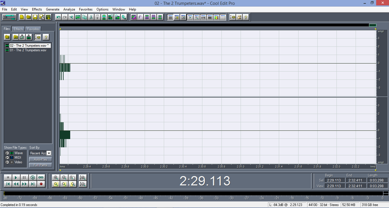

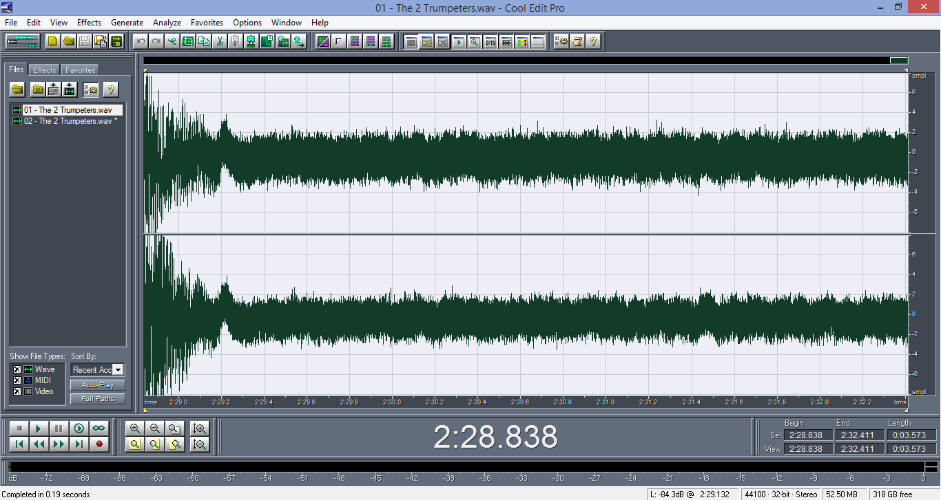

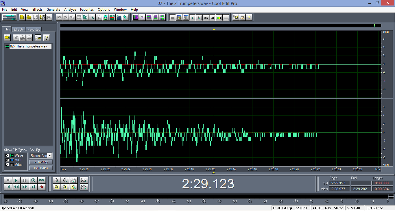

This is not the case. File "01" is a 24bit file - saved as 24bit file and has 24bit resolution, that means there are amplitude levels smaller than the least 16th bit. File "02" is saved as 24bit, seems to be 24bit, but the resolution is only 16bit and there is nothing smaller than the 16th bit LSB and worse, there is no dither on those in fact 16bit data. Scott tried to explain this, I am trying to explain this but it is not understood by the receiver. This is annoying and probably better not to try to participate.
Images attached, again. Pears and apples are compared, then.

... but the resolution is only 16bit and there is nothing smaller than the 16th bit LSB ...
which means it's the 16-bit original saved as 24-bit. Two of the files in the set must be like that, obviously.
Normally, for playback there's no need to convert a 16bit file.
The only need for this comes from preventing very simple cues which file is which, by sheer file size.
