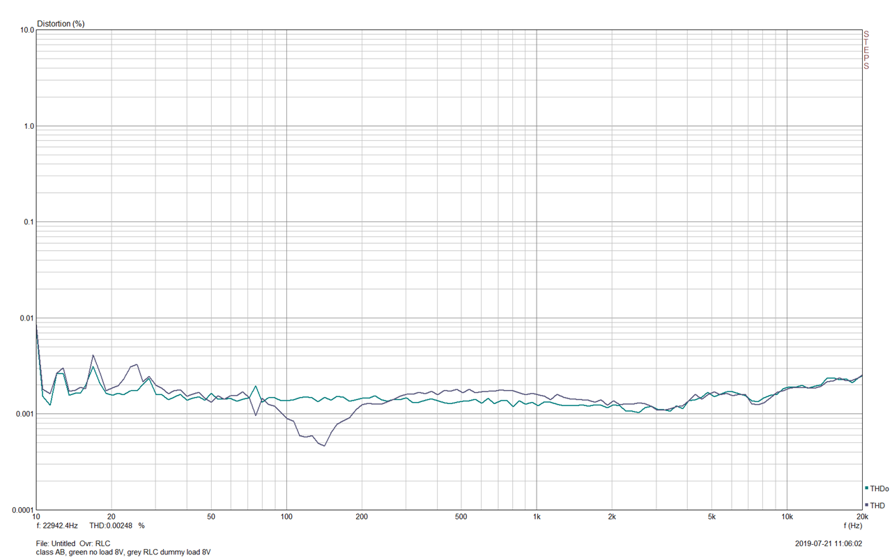

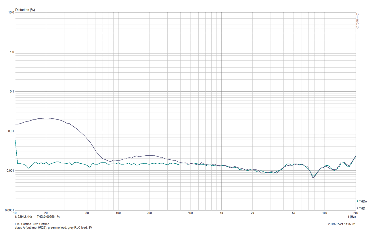

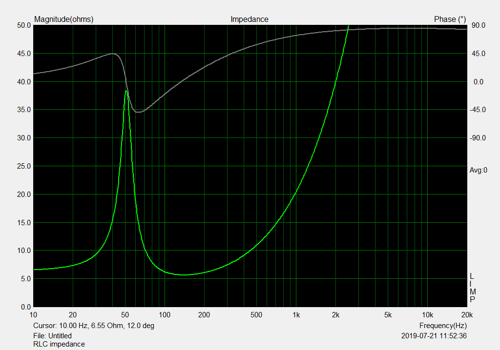

Joe, I have prepared a set of measurements especially for you. Not that I wanted to argue, but just for fun and my pleasure.
There are two amps in the test:
1) class A no global feedback amplifier with 0.22 ohm output impedance
2) class AB amplifier with strong global NFB and output impedance of some 0.01 ohm, approx.
None of those amps uses output coil.
The amps were loaded with a RLC dummy load that simulates a free-standing woofer quite well. The big inductance is a ferrite core coil, which is pretty non-linear and in this regard it simulates speaker non-linearity quite well.
The measurements into this RLC load were compared to amps distortion without any load.
Attached measurements show RLC dummy load impedance and distortions of both amplifiers into RLC dummy load and to no load. Class AB amplifier, with high NFB and high DF, "controls" the output voltage in the frequency band where coil non-linearity is present much better than the class A amp with 0R22 output impedance. Current distortion is a mere division of ouput voltage by circuit impedance and class AB high NFB high DF amp has again lower distortion. So there is no question what is better, speaking about parameters and measurements.
P.S.: 0.001% is not far from system measurement limit (about 0.0005%), so phase of distortion components may play the game and distortion values below 0.001% should not be considered.

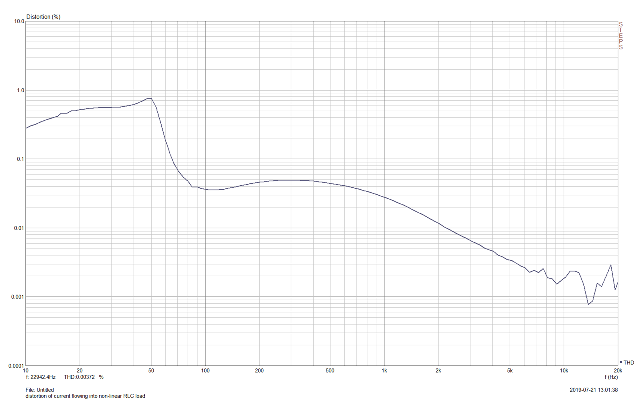

This is a measurement of distortion of the current flowing into the RLC dummy load used, at 8V. The main cause of the distortion is the ferrite core non-linearity and this dummy load is good to demonstrate effect of the non-linear impedance. Current distortion was almost same with amps (1) and (2). This current distortion reflects in amp terminals output voltage distortion as a ratio between amp output impedance and RLC load impedance at a given frequency multiplied by current distortion at a given frequency. Complex numbers to be considered. So the class A (sample under test) result is worse because it has higher output impedance.
