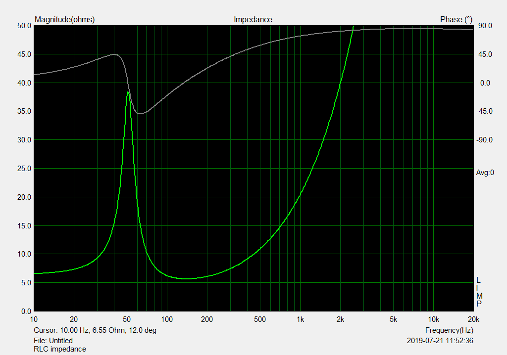

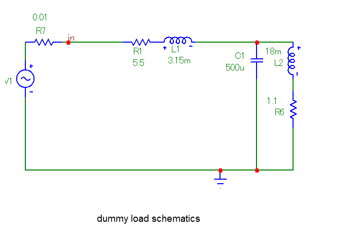

Isn't Pavel showing the current distortion caused by the varying load impedance? I'm confused by Richard's comments, is that the point?
Yes, it is the distortion caused by frequency dependent non-linear impedance. Non-linear is the key word here and it is the non-linearity of the inductance of the coil L2 with ferrite core that starts to saturate.
I think distortion - in many amplifiers- also varies considerably over speaker impedance because of the current drive requirements. At or near resonance, little current is drawn from the amp output, but at the low Z point(s) at typically a few hundred Hz, some speakers will drop to 3 Ohms and demand much more current from the amp.
Good amplifiers will show little difference in distortion over wide speaker loads (3 Ohms and up).
I would expect cross overs to use air cores - no saturation. Or are you referring to the speaker coil itself? But if it’s going heavily non- linear, surely that’s an ‘overdrive’ issue rather than an amp issue?

Pavel said : "The amps were loaded with a RLC dummy load that simulates a free-standing woofer quite well. The big inductance is a ferrite core coil, which is pretty non-linear and in this regard it simulates speaker non-linearity quite well."
