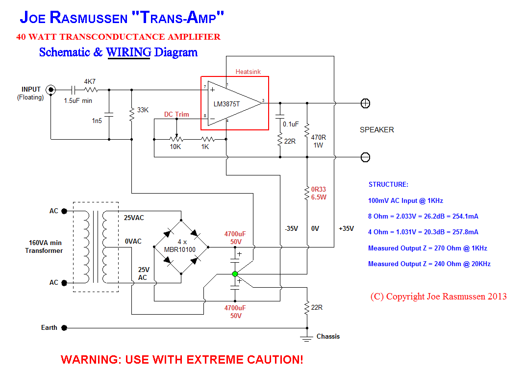

How does that relate to back-emf?
Richard, I think the issue somebody raised was about using passive crossovers with current drive. There is no way to assure that all the current that is supposed to go into a speaker will go into the speaker if a passive crossover is used. The parallel impedance of the passive crossover going to the other speaker makes it looks more to the first speaker like it is being driven by a voltage source, since the impedance looking out from the first speaker terminals towards the amp will be lower due to the presence of the parallel impedance of the crossover network. In that case the source (amp output) does not still appear to have the high impedance of a current source. Hopefully that makes sense.

is this with same circuit as I showed or something else? LIke a pure current drive.
I would not be surprised to reduce the mid or a tweeter if it had a pronounced resonance peak in Z.
Current drive is a whole other Thing. I am comparing the voltage and the current sample - phase off by 90 degrees - and summing.
If I added a C in there to get a 90 degree shift at the Fr, I would get a more complete reduction in THD.
View attachment v-I FB ckt.pdf
I hope you can read this pencil sketch I made from around 1960-something.
