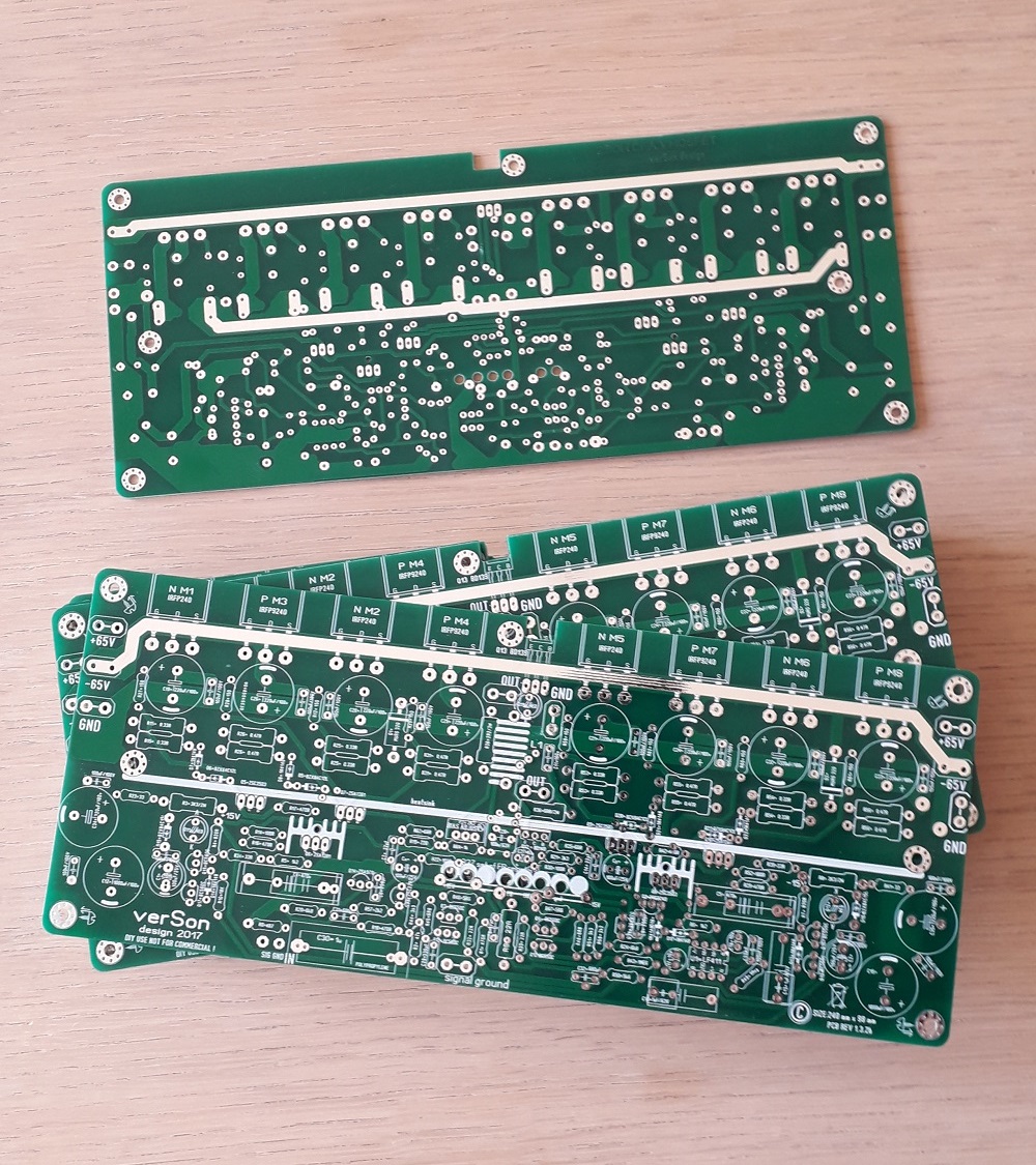

Hey Jacco, yes, monster heat sinks are milled, drilled, threaded and assembled, output stage PCBs are ready, a peek preview here: https://www.diyaudio.com/forums/analog-line-level/338635-290-db-distortion-38.html#post5816895
This will be a dual mono powerhouse of at least 600W/4ohm and 800W/2ohm with under 0.005% distortions at all frequencies. 6 pairs of IRF244/IRF9240 per channel. Atmel MC controlled and protected (load, temperature, power supply), board and software are ready up and running.
I used similar idea a few years back to make layout for 200W CFA.
It is also based on Cherry paper and different from your layout is that I put output transistors in one line to keep it on similar temperature in contrast of your layout where upper transistor will be on higher temperature (only if you mount it horizontally they will be on similar temperature).
I used alternated on N and P devices, parallel +/- power supply lines on both PCB sides.
The amp made for Richard is commercial amp with employed that idea.
