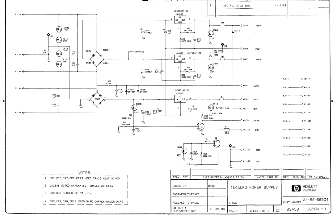

I'm not saying reference quality power can't be achieved other than batteries/supercaps - just that standard voltage regulators used as per datasheet haven't delivered the sonic quality. if people can show the voltage regulators used in the LIGO reference circuits or the Keysight meter then I would have learned something new

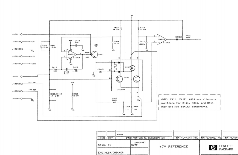

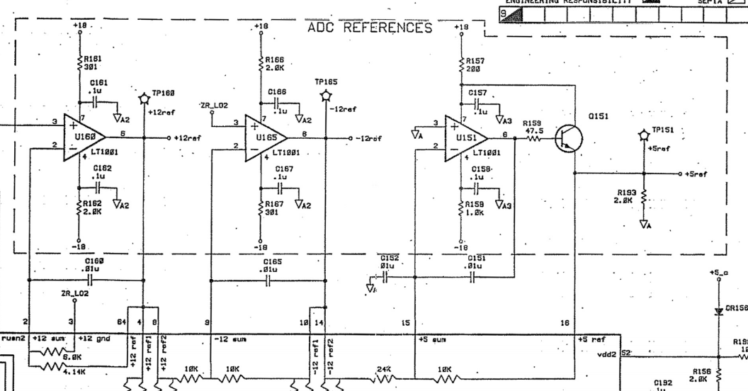

I'm not sure where to get details on the 9 digit laser supply (9 digits really? how do you verify that?) but here are some circuits from the HP3458 DVM, supposedly the most linear 8.5 digit meter.
You can download the schematics here: Service Manual - Hewlett Packard 3458A - Digital multimeter -- Download free service manuals lots to study.
The main regulators are LM317/337. The 7V reference uses an LTZ1000 which are really nice if you need stability but a real challenge to implement. The ADC references are opamp based.
This is an old design, 1987, using reasonable tech and methods. Things have not moved much since then and no magic foo, supercaps etc. to make the instrument you would use to measure Allen variance of a DC supply.

So it's not using a standard voltage regulator as a reference voltage but rather a specialist part LTZ1000 which is a temperature controlled zener & temp compensating transistors & ancillary circuitry all contained in a box for thermal stability
Does this not agree with what I was saying - for stability, maybe off the shelf voltage regulators are not upto snuff - batteries/supercaps seem to work better. Specialist reference voltage devices specifically designed as reference voltage parts probably work even better but I haven't seen these used in audio?
