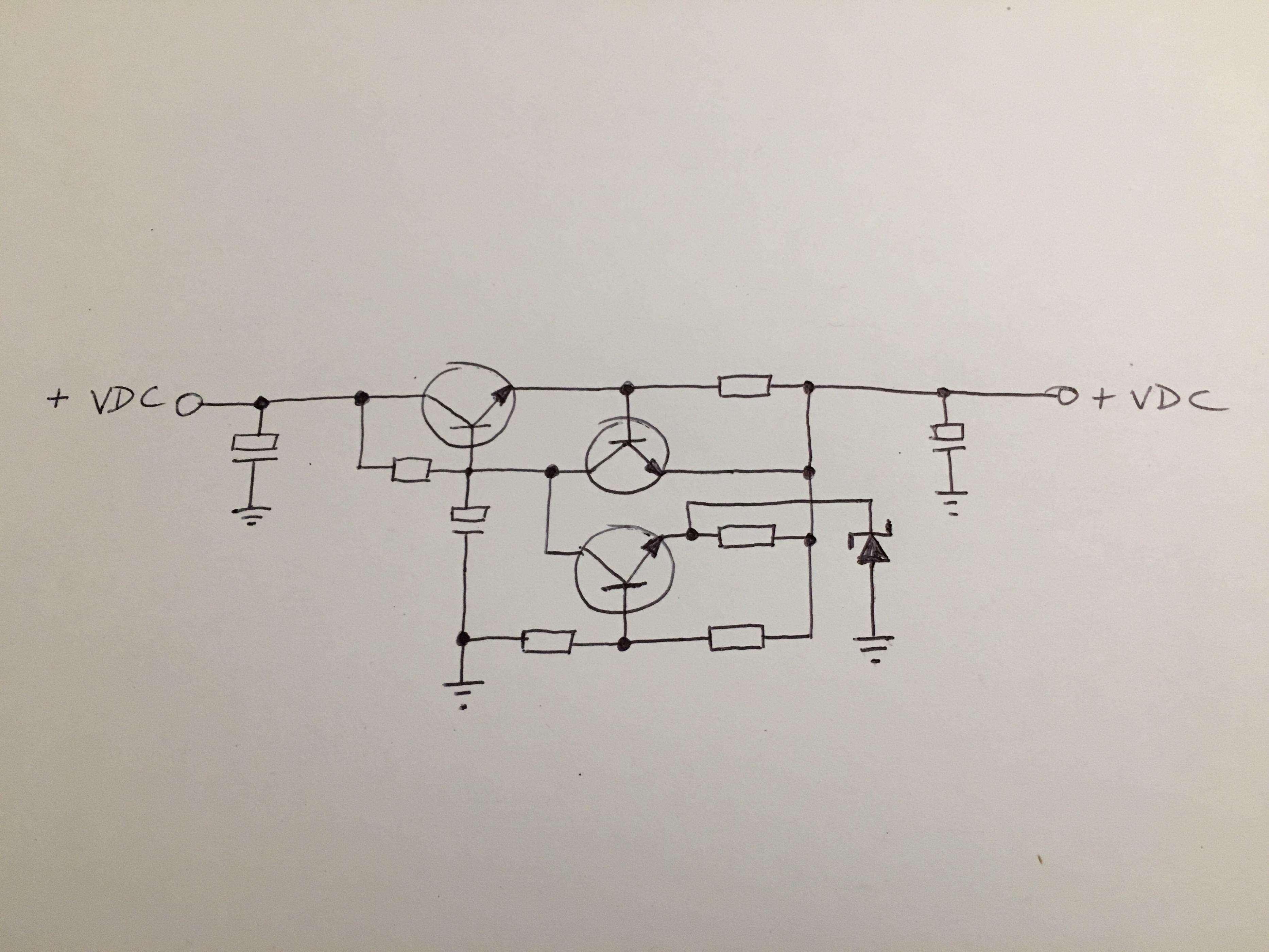

So serious. I just gave it as an example. Actually, I do like a surface mount ceramic in that position right next to the electrolytic best right now. I use the 0.01 styrene down stream right next to the pass transistor. Still in parallel with the 'lytic, just not right next to it.Why do you think 0.01uF PS is even desirable in parallel with a 1000uF electrolytic in a power supply? The value is extremely small and the series inductance of a through-hole polystyrene cap is relatively high compared to a surface mount ceramic. Look at a Z vs frequency graph of that cap and tell me what problem you are solving with it. It also has a chance of creating an anti-resonance impedance peak somewhere with the decoupling capacitors at the load.
For simple power amp rails I tend to do 15,000uF electrolytic, plus 47uF electrolytic, plus 1uF film closer to the output devices. Seems to work and sound fine.
For simple power amps I tend to do 15,000uF electrolytic, plus 47uF electrolytic, plus 1uF film closer to the output devices. Seems to work and sound fine.
Well, there is a big difference between 1uF a stacked film cap and a 0.01uF polystyrene cap. There is no need to speculate, you can put the equivalent circuit into LTSpice and see what happens on a load step.
It would probably work just fine without the 47uF or the 1uF honestly depending on location and layout. Working fine and sounding fine is a really low bar to clear when we're talking about power supply reservoir caps. It helps to know why you are using 15000uF and why there is a 47uF and a 1uF cap.
Try the biggest mica cap value you can fit right next to the raw voltage entry point of the pass regulator element (if you have any, otherwise maybe the finals or the front end). Give that mica cap a dedicated thick solid core wire return to the circuit ground entry point.For simple power amp rails I tend to do 15,000uF electrolytic, plus 47uF electrolytic, plus 1uF film closer to the output devices. Seems to work and sound fine.
Why do you use 0.01uF? Why polystrene?
Especially when you start looking at the lead/package inductance on power amp output transistors, bypassing to the pin with a large'ish x7r (10 uF, overrate the voltage a lot) generally yields the widest bandwidth PSU bypass. 100 nF on the pins of opamps is common, and good practice.
Surely this must be some sort of joke. What is the function of a shunt capacitor most likely under 10nF attached to some length of wire...
We know what an ideal power supply is. Why do you not just find out what brings your power supply closer to that instead of throwing **** at the wall and hoping it sticks as a design philosophy?
But that's engineering, so not appropriate here. 🙂

Yeah, I was going to find more links but this is a good one from Gerhard:
http://www.hoffmann-hochfrequenz.de/downloads/experiments_with_decoupling_capacitors.pdf
It's a good'un. Plenty of app notes from all the major manufacturers out there that discuss this aspect, albeit in terms of high speed circuits. So it's daunting to recommend just one.
As to the point I was making:
http://www.nteinc.com/specs/2900to2999/pdf/nte2920.pdf
Lead inductance for this to3p is quoted at 5 nH on the drain, and source at 13 nH. Common cited number is 10 nH per lead for something like a to-220, so in the general range we'd expect.
Here's another one to explain in clear terms that the lead inductance will dominate any tiny capacitor's effect. (from a gentleman who lives in infamy on this thread, haha)
LM3886 chip amp supply decoupling.
