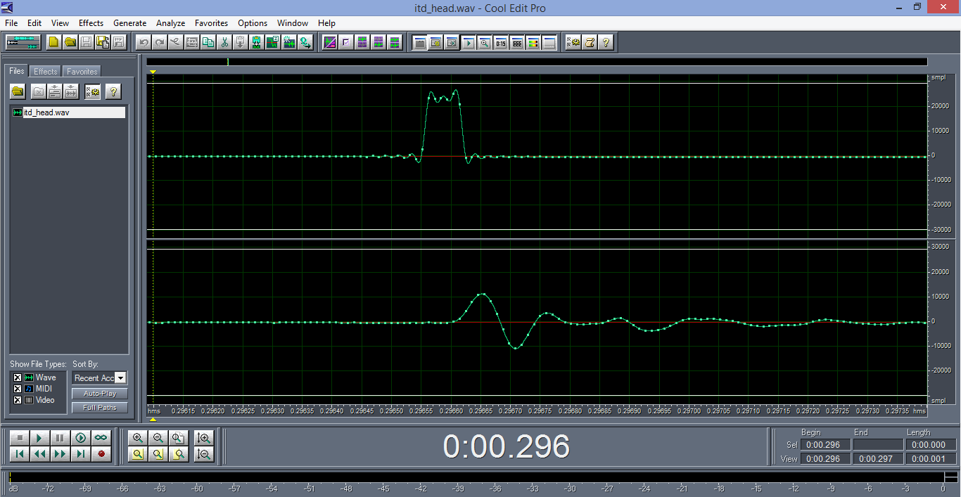

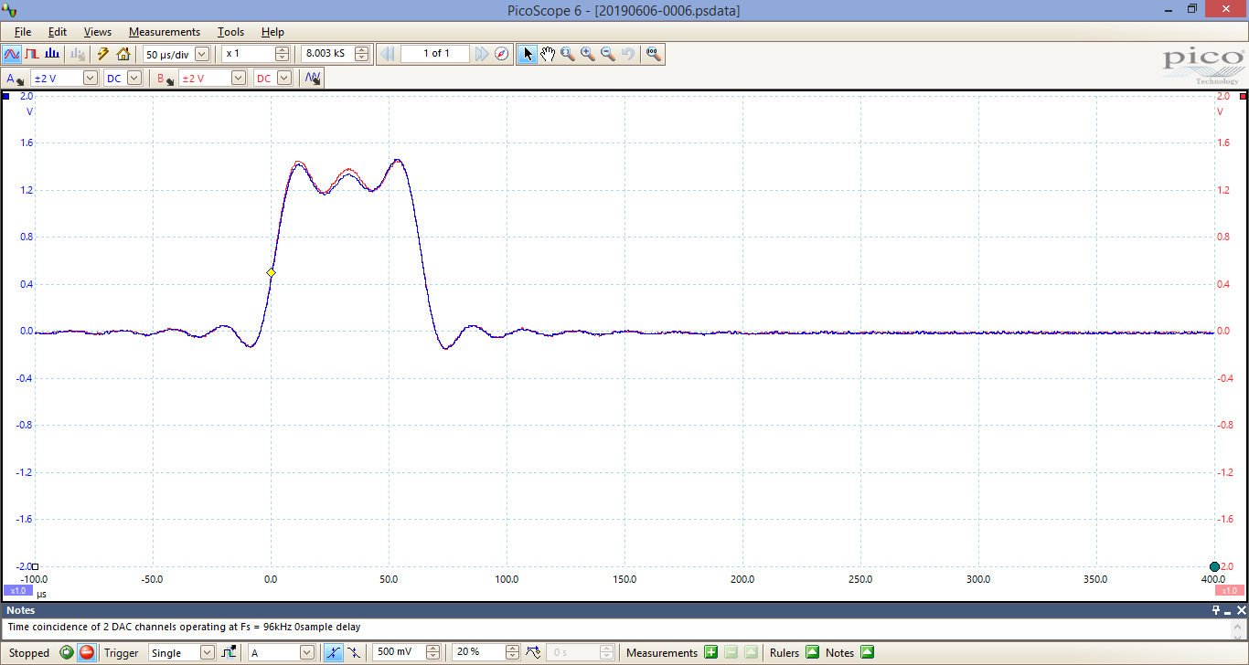

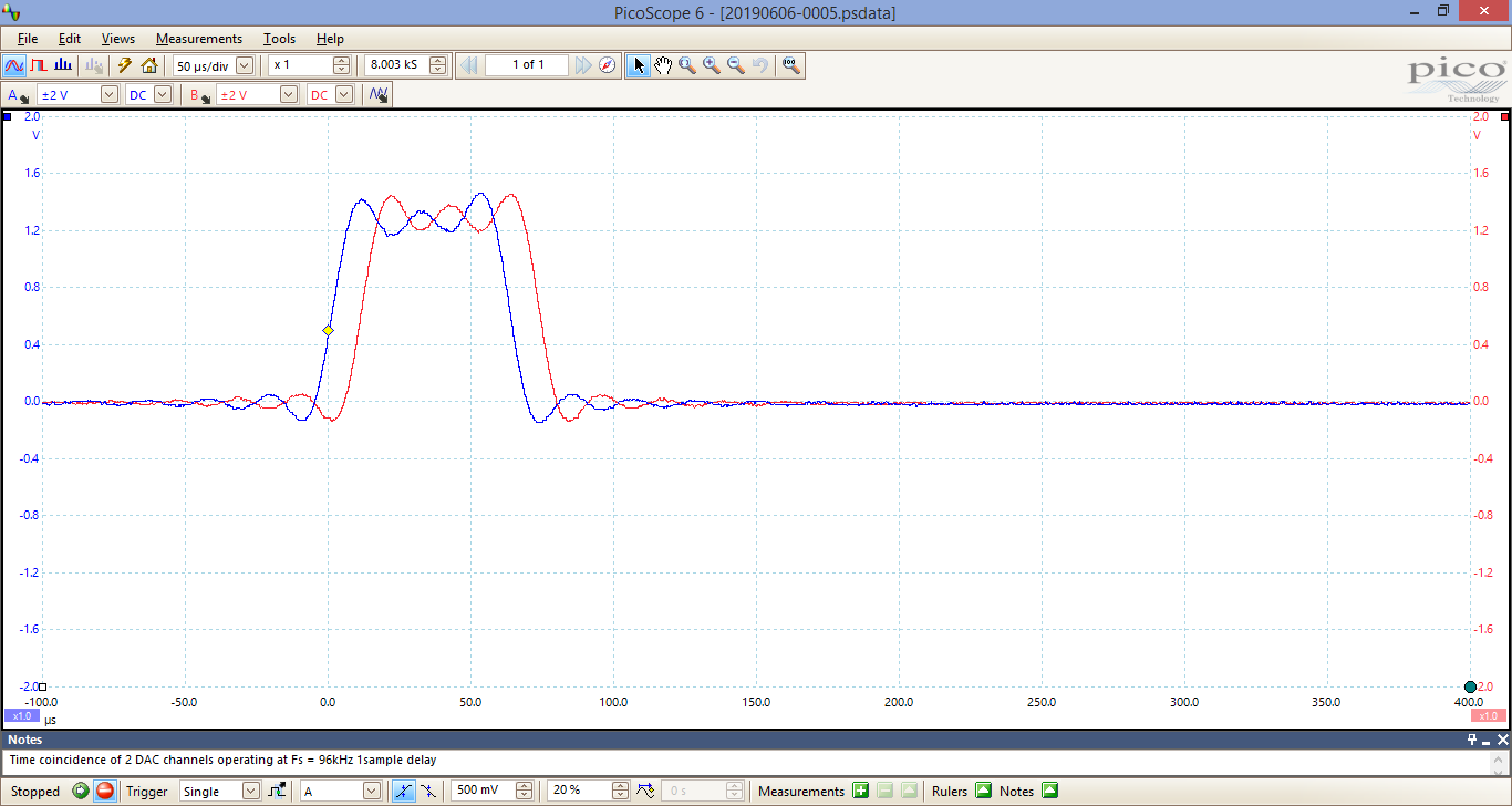

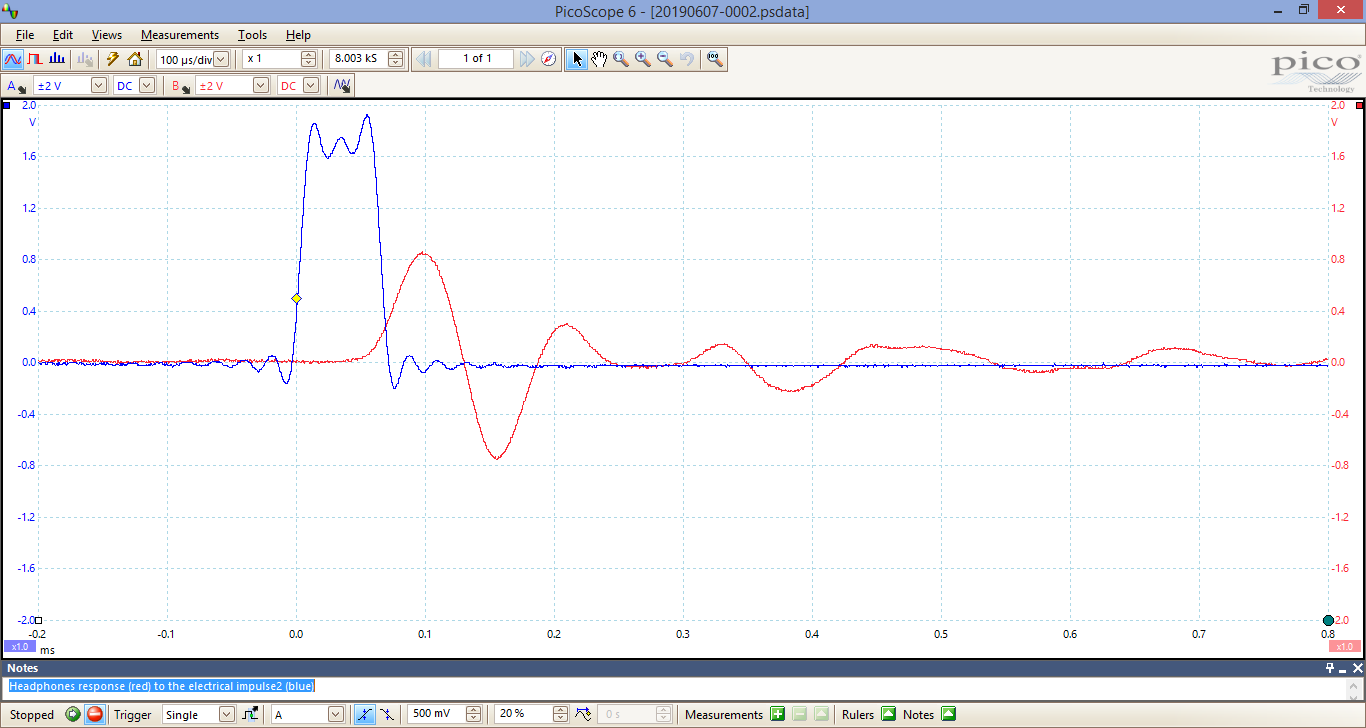

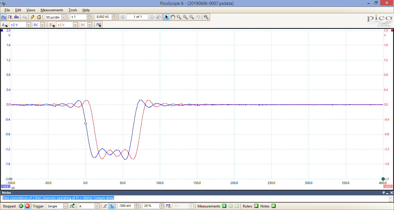

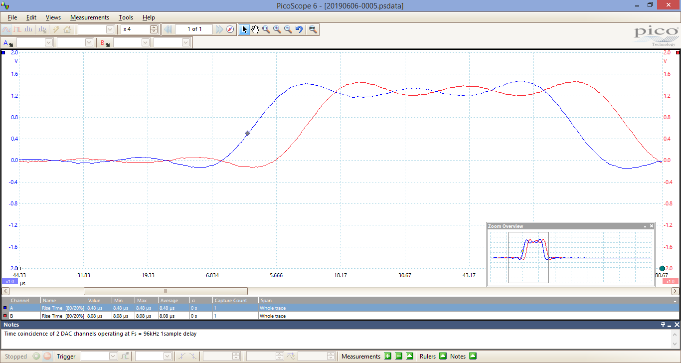

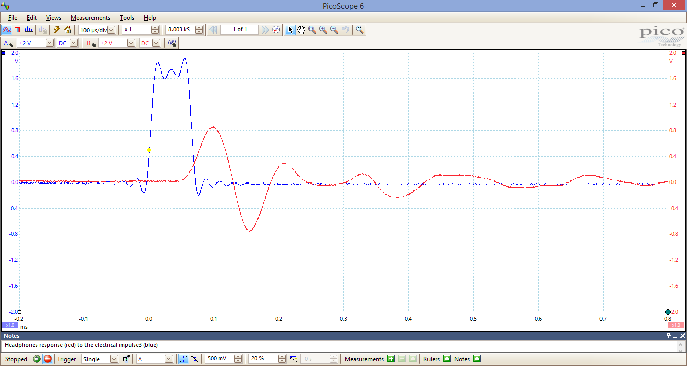

Thank you for participating in the test. To answer your question, I would say maybe. Yes, it was initiated by the cable-induced ITD discussion. I created 3 groups of 3 impulses in each, #1 are L/R coincident, #2 have R channel delayed by 1 sample (10.42 us) behind L channel and #3 R channel ahead of L channel by 1 sample, this means that there is a 20 us difference between #2 and #3. Then I created inversion of these 3 groups, because of those absolute polarity discussions. The test file is in 96kHz/16bit format and measured plots from my DAC output are attached for group #1, #2 and #4 impulses. This is about the signal.
What we hear might be questionable. First, we must be sure that our system does not re-sample the signal, which may easily happen in Windows. I am afraid that only a measurement at DAC output gives an answer. Second, what will be acoustical output from our transducers (headphones, speakers)? They are in no way able to reproduce the impulse shape, even headphones are unable to do the job. In case of speakers, room reflections will be added to the speaker bad time response. Will the transducer be able to give same time response to the positive and negative impulse? And what about our ear, how it responds to the impulse train? Is not the perception of 2nd and 3rd impulse different from that of the 1st one? Literature supports that it is different.
And we know that localization of the impulse source is not only about ITD, but also about ILD (time, level). At least the level in the test signal is kept stable enough. The rest is on our sound system, transducers and ears.
P.S.: The last plot shows headphone response to the test impulse.
