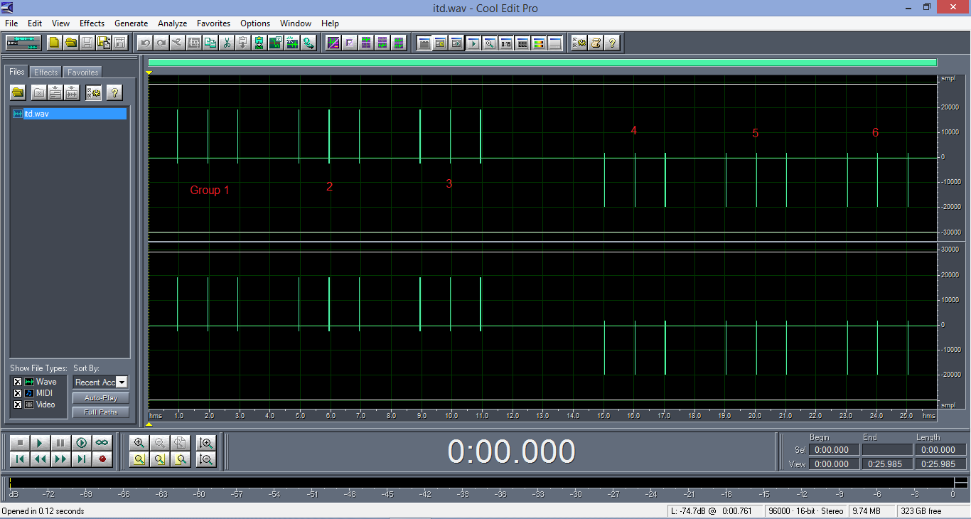

Straight up the first half of the file sounds sort of like the real thing (the starts of the sounds are not immediate), and the second half of the file the sounds are inverted and 'all wrong'/not possible for a pulse sound.
I then read your post #21108 and can report that I did not note L/R change or other changes but I did loudly notice the timbre like change characteristic of polarity inversion.
Dan is correct, groups of impulses #4 - 6 are a direct inversion of groups #1 - 3. However there are still differences inside the groups #1 - 3 and #4 - 6 (which cannot be seen from the image posted) and that's in fact the main reason why I posted the test file. This means, group #1 is not identical to group #2, group #2 is not identical to group #3 and #3 is not identical to #1. Same for #4 - #6.

I'm glad I spotted a difference 🙂, I'm not totally deaf then 😉 Would that explain my impression of groups 4-6 being "out of focus"?Dan is correct, groups of impulses #4 - 6 are a direct inversion of groups #1 - 3. .
Yes, maybe yes. I also do hear some difference, with good headphones and soundcard. On a tablet + headphones, it starts to be worse defined. It might be quite complex - DAC, headphones/speakers, ears. More observers would be appreciated.

Are you sure "3 impulses in one group are all same.".....the first set of three sounds different ABA maybe, third group has different order like BAB or something.Thank you for trying, do you hear any left/right move or timbre change between the groups of impulses? There are 6 groups of 3 impulses in each, spaced of 1s between impulses. 3 impulses in one group are all same. The question is if groups of 3 impulses audibly differ. Time interval between groups of 3 impulses is 2s. So, 3 same impulses with 1s spacing, then 2s silence and further group of 3 impulses. There is a longer 4s silence interval between first 3 groups (group 1 - 3) and second 3 groups (group 4 - 6) of impulses.
These are faint differences on headphones, I will try speakers tomorrow.

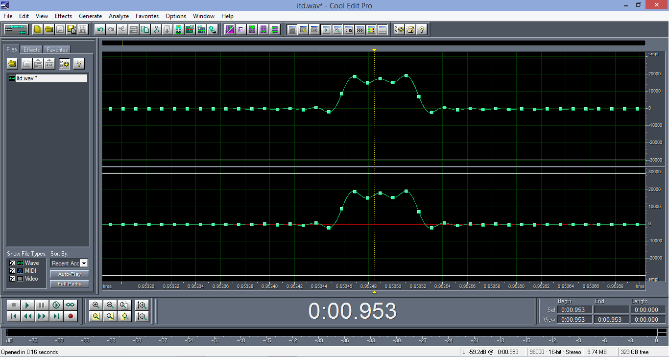

Well yes, pretty much same. Groups are copies of the 1st one, with interchannel time shifts added. However, dac filter response or headphone response or ear response under repetition may make a difference.
The file is in 96kHz, sample interval is 10.416us. Sets differ in time shift between L/R channels. This may reflect as timbre change for you. I have read peaks in 3 of impulses, two from #1 and one from #3. Their sample levels are
18426, 17293, 19125
18425, 17293, 19124
18429, 17292, 19130
This is not enough difference to speculate about. This test should say something about time shift audibility, not about sample level.

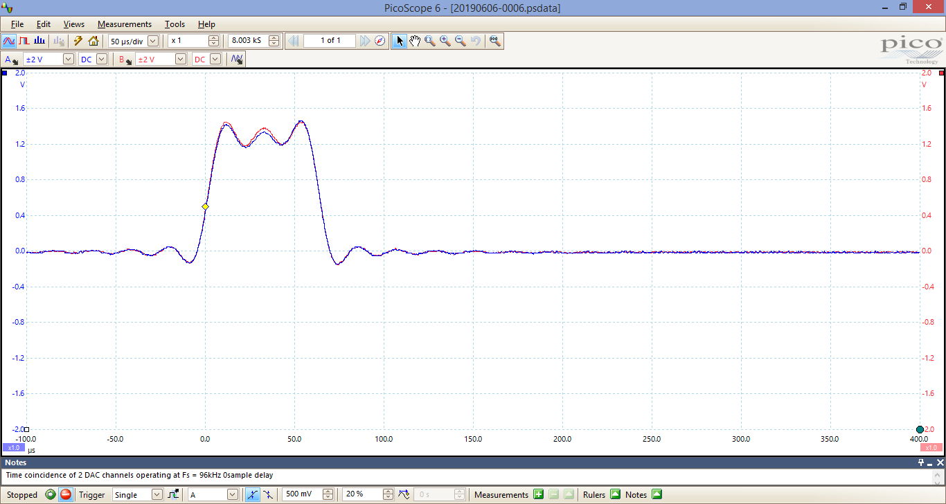

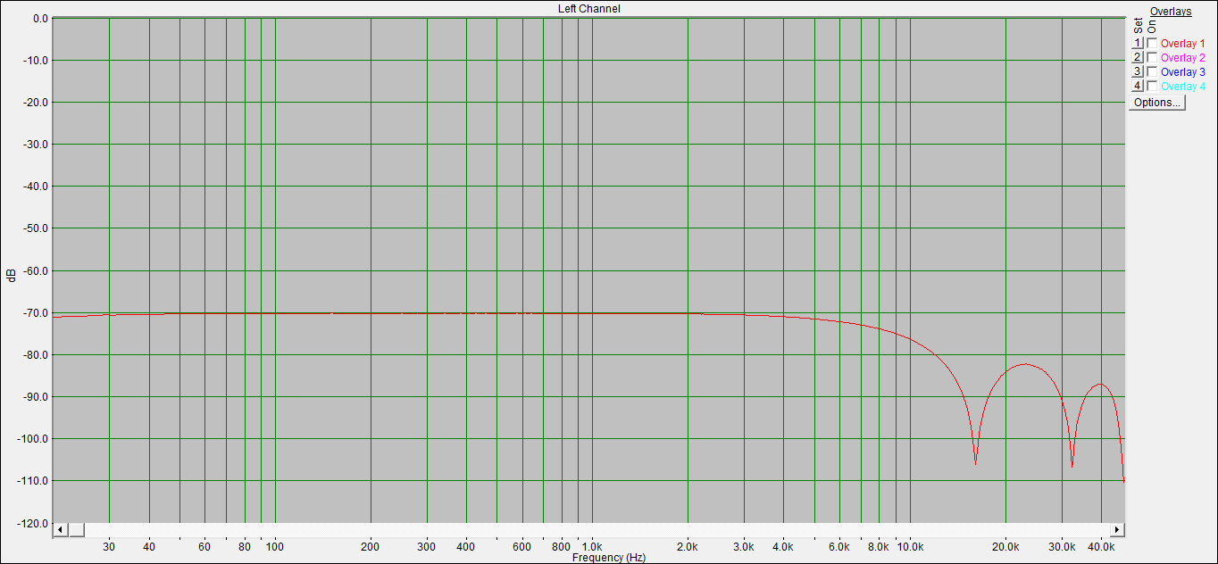

Attached are data samples form group #1 and also measured impulses 1 from group #1 (DAC out). Also an impulse spectrum.
I am not disclosing time shift values at the moment. Just that the groups #1 and #4 are time coincident.

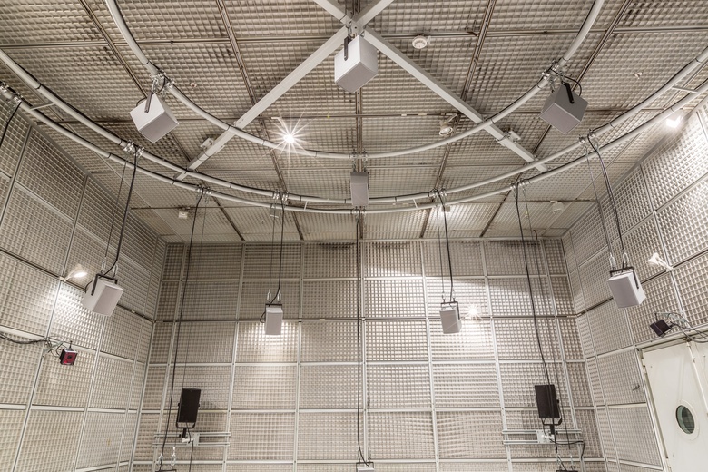

It seems to me that the music business is not much interested by the 3D spacialisation. Apart for film music mixing.
In France, The IRCAM (Radio France ), STMS and the CNRS as well as the is University Paris Descarte are studying the subject since decades.
The first result of their researches were using complex algorithms, playing with response curves differences and delais on a stereo system (2 Speakers) SPAT. I don't remember the name of the Japanese company that produced a gear for studios: not a big commercial success ;-). I had never seen any gear from them in production studios.
It was based on vertical positioning as well as front and rear. Mainly based on headphones listening for their desmonstrations.
It is more the movie business that imposed 3D with the 5+1, and the researches are more oriented on this system. But I know only 2 modern plugin for mixing desks that works all in one for 3D specialisation in 5+1 : Panoramix and SPAT revolution. Very confidential ;-)
Note the "Elevation" knob.
For the moment, all this is still experimental and stammering. Interesting more the experimental music composers than the industry. A strategic error of the IRCAM since decades, on my point of view.
I never seen any up/down knob on any mixing desk in a pro studio, on my side. And it seems most people in music industry is interested only to a spacialisation on an horizontal plane. This can be explained by the fact that most of the time, in concerts halls, the musicians are not situated in the sky, but in front of the audience ? ;-)
