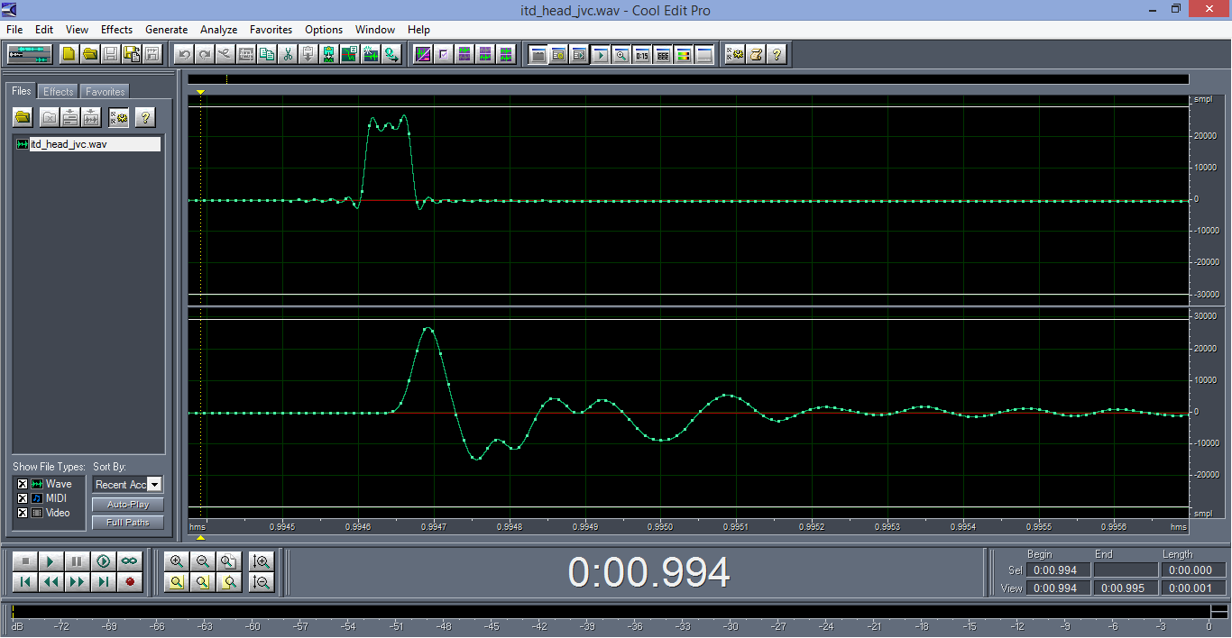

I tried another, smaller headphones. The impulse response is faster - smaller transducer. Shape of positive and negative impulses is the same, so we may speculate if we hear phase inversion in some cases. However still the headphones are unable to follow the input impulse - no wonder.
P.S.: test file to test absolute phase audibility attached. Same impulses, positive and negative. No L/R shift. My ABX result is ZERO.

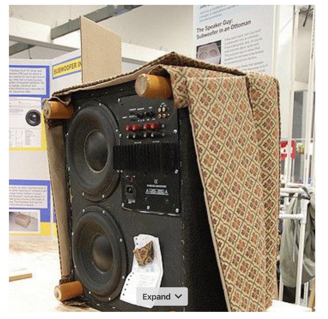

Who gets to sit on it ?......that reminds me of a story about the office girls sitting on the workshop beer fridge until they got found out lol.There’s no stopping us hi-fi guys !!!
Bluetooth Ottoman

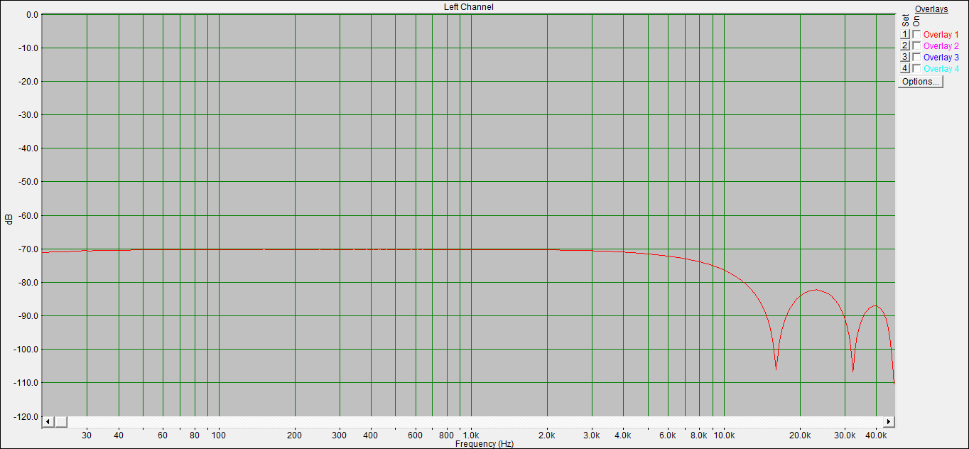

Testing with impulses is difficult, I agree. Using a high passed step is more revealing as it contains sufficient low frequency energy.
As you know, the test impulses used have flat frequency spectrum from 20Hz to some 4kHz. -6dB at 10kHz, deep notches at 16, 32 and 48kHz 😉.
However I know what you mean.
