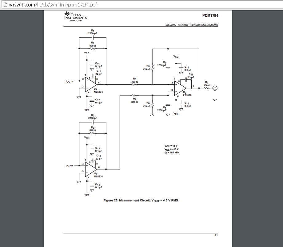

Hi George, I am fiddling with a Chinese PCM1794 board at the moment. Reason is I want to hang some good DAC's behind a MiniDSP Nanoshark to see if that can be better than the analog active xovers I cobbled together. So I came across this schematic a couple of weeks ago. The combination of NE5534 and LT1028 was very amusing to see.
Btw, the PCM1794 can easily be beat on distortion by ES90x8 and AK4497.
WRT easily beat - yes, by someone who doesn't know what they are doing.
If you know what you are doing, all of those DAC's can offer similar performance distortion wise. They all have their own particular trade offs in a real world (complete DAC) application.
WRT those experts taking pot shots at the 1794 data sheet OP stage (5534 etc), who can tell me what the DR of the DAC really is?
I am watching your work on DACs with fear. Fear for my Wallet :) I have miniDSP 4x10HD and, although the DACs are adequate (and certainly better than some of my sources) I know better can be done and there are I2S headers on the board...
Bill, for about 100 Euro's you can buy 3 ES9018 boards, plus a handful of LM4562's and electrolytics, which, after being shoved together in the recommended fashion, will give you around -110 dB distortion. This will require a bit of juggling with your soldering iron. There also is a cheap PCM1794 board that will approach this performance with just replacing some opamps, but it will do so in mono mode only, so you will need double the number of those and so that will cost you about 140 Euro's, all in. I broke a ES9038 that could be brought up to -113dB distortion, have order a new, different board to see how far I can get. Three of those, plus some opamps that will do it, will be around 200 Euro's.
