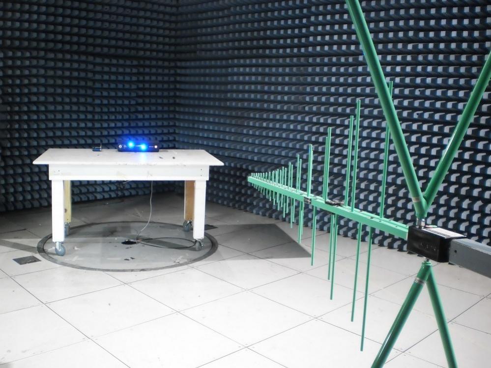

As for EMC, just pull the trigger. I have and it was great fun. 🙂
(general pic harvested from the web)
That's it the dreaded turn table. I remember the solid core coax going into the quasi-peak detector and S/A test gear.
