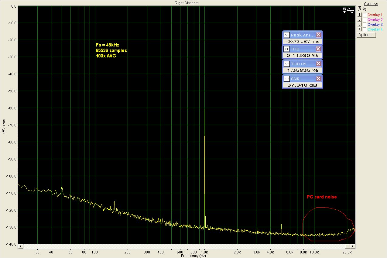

Noise measurement on my latest phono preamp. Complementary-differential JFET input, MOSFET output, 3 stage power supply. S/N is about 88dB re 5mVrms/1kHz input voltage, for 24kHz BW, unweighted.
PMA, is this with the input shorted, or with a cartridge on the input?
With cartridge equivalent series resistor (and signal generator). No series coil, but for the reason of input JFETs the current noise is not an issue. The preamp is for MM.
P.S. Voltage gain set at 36dB/1kHz
Thank you, John. I believe it is not bad, and I like the sound. I have a direct comparison with OPA627 + buffer based preamp (my older design), and I believe you can imagine which one I prefer. Anyway, I have learned a lot in discussions with you here, about circuit topologies, and without that I probably would not design a discrete phono preamp.
