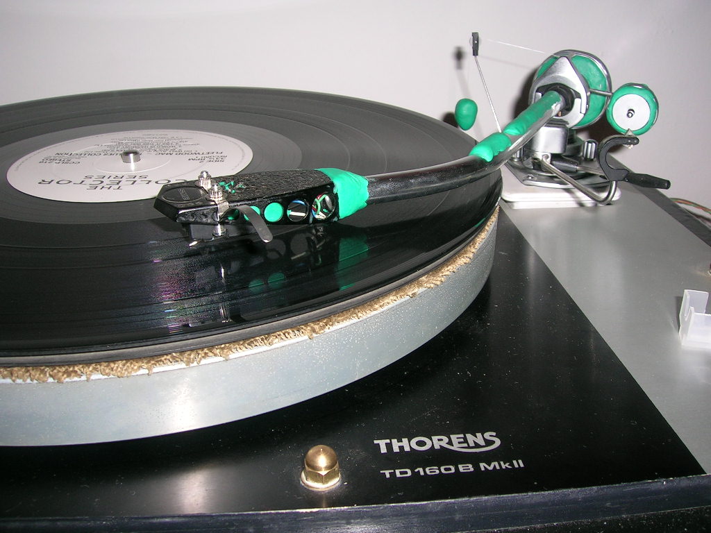

It really depends. IF the lateral and vertical compliance are the same (not a given, try a Decca pickup) AND the arm has the same effective moving mass in both planes, yes, the resonances will be the same.
In practice I cannot remember a single arm/cartridge combo where they where the same, though usually quite close (using HFN Test Record).
Ciao T
With the SME 3OO9 Improved and the DL103 (both a bit “touched-up”) using the HFN Test Record, I had the peaks on 9Hz and 12 Hz, but I do not remember which was of the vertical and which of the horizontal resonance frequency.
Regards
George
