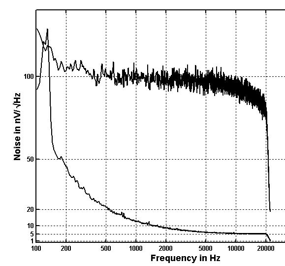

Scott here are some measurements I made of those big fets compared to the Toshibas. Measured at 10 Volts on the drain about 4 mA. The circuit is very similar to the one you did but biased without the Vishay parts. After CES I want to look a little closer using my HP signal analyzer now that my HPIB is running.
I'm a little confused by the plots. They look a little different than I would expect. usually there is a flat noise floor to some lower frequency wher the 1/f curve start and it rises below. A HF rolloff is usually indicative of the amp circuit running out of gain, not the noise falling.
Calibration with a 600K resistor is a good trick, until the input C of the part rolls off the noise from the resistor. With the 200 pF input C that could happen at a pretty low frequency.
You only need a baseline to set a reference, the resistor with no DC current will be flat down to very low frequency. If it starts to roll off at even a few kHz just take a reading at 500Hz or whatever. You would need to verify that there was no generation recombination noise contributing to these plots.
A quick example, it's pretty easy to eyeball the flat portion of the noise spectrum of the circuit with resistor added (top plot).

Thanks I might have been overly ambitious in picking 604K, some of the feedback I got was that some folks were flumuxed by the concept of un-root sum squaring two noises so I picked a resistor that would totally dominate. I expect those Interfet parts to seriously roll off due to Miller effect. It's hard to present things so they are unambiguous to any level of reader.

I forgot the most important thing, this eliminates the need to compute the noise BW of your filter bank. Even with the FFT you neeed to take into account the number of bins and the windowing, but now all that factors out by having a reference based on first principles right at the input. The temperature correction is so small that I usually ignore it (root(4KTR)) since temp is in Kelvins its ~300 degrees plus minus 5 or 10 degrees difference in room temperature.
