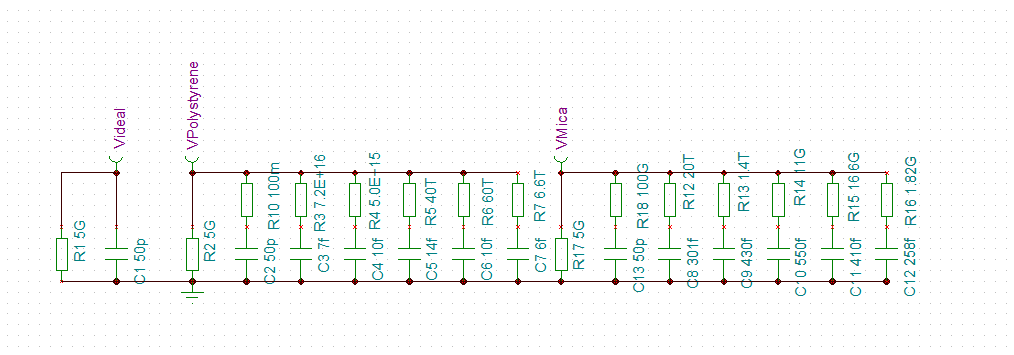

First, what this broadband noise will be interesting to determine.
Second, I entered Dimitiri's shown circuits into my Simulation Software. This showed a very minimal difference in noise, much, much less that either Scott's Measurements or Dimitri's simulations suggest. Also, Dimiti's simulation is for 1uF/5GOhm, not 50pF/5GOhm. So I would careful using this Sim as evidence, it may better to run your own.
I have performed a simulation much closer based on Scott's circuit, with added RC Networks based on Bob Pease's Capacitor Soakage article (Mica - estimated) and based on the numbers in Dimitri's Sim for Polystyrene. The noise shows so little difference between ideal, RC ladder simulated Polystyrene and RC Ladder simulated Mica that I omitted labelling the traces...
Simulations are a notoriously dodgy area, however if take cognisance of the origins of Johnson/Nyquist noise, we find that if we parallel additional RC Circuits where the R is much greater than the main R in the circuit and C is much smaller, the noise is essentially unaffected, Thevenin, Kirchoff, Nyquist, Johnson and all, nothing more than EE201 should be needed.
Of course, if one knows not the underlying theory and instead yokes oneself to questionable believes, it is easy to jump on false evidence seeming supporting one's viewpoint, but that is hardly better than clutching at straws.
Past that, as I pointed out, that certain types of capacitors (or resistors for that) are noisier than others (though it only shows up in extremely low level and/or high impedance situations which are rare) is hardly news, nor is that certain capacitors are much more microphonic than others.
Ciao T

Well, since Dimitri's sim is closer to experimental results than yours, perhaps it's a better model.
edit: Is the value of R18 correct?

Sy,
Or perhaps it is a simulation error, caused by running the simulator under conditions it is not designed to correctly handle? Simulatons are just that, math based on certain simplified models.
So perhaps is is a better model if you want to believe into your thesis, which, as it cannot be sufficiently reconciled with basic electronic theory, would seem extraordinary....
Well, why don't you tell me what the correct value should be, given my stipulations given in my original post, if you disagree.
Ciao T
Ciao T

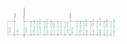

100 milliohms.
Hi Sy,
Ahh, you are right, it was originally 100m, I upped it to 100G so I could quickly run a set of AC transfer curves (to be sure which trace was which).
It was at 100mOhm for the traces shown in my post and indeed should be when running the traces with any other Sim...
Ciao T
100m.
Ciao T

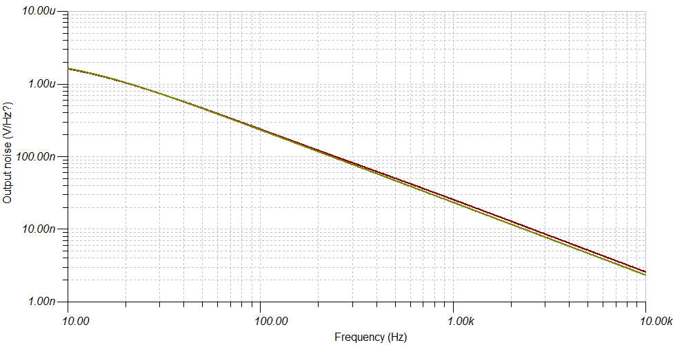

Thanks, Thorsten.
I'd appreciate two more bits of clarification:
First, I would expect three lines on the sim chart (I'd run it myself, but I have about zero ability)- the ideal, the polystyrene (which should run fairly close to the ideal), and the mica. I only saw two. Is it the resolution of my laptop screen? The scale?
Second, what equations did you use to derive the values in the model? Yes, you said, "Pease," I've read his stuff on soakage, but were your values derived by taking into account the experimentally observed DA behavior of actual mica caps? If so, could you explain your calculations? It would be educational for us, and I would be personally appreciative.
Given my limited experience with simulation, I am agnostic about the accuracy and applicability of that model, especially at high frequencies, but could certainly be convinced one way or the other.
There are three lines, two are so close they only visibly diverge at extreme zoom factors.
First, the general equations for scaling are on the screenscrape by Dimitri. I scaled Bob Pease's Mylar model, as he shows mylar as pretty much "as bad" as Mica.
I find that simulations generally work acceptably for "generic stuff" (AC Frequency Response, Gain, DC Operating points), but are at best "ballpark" for HD, Noise and other more complex stuff. In general this is due to the fact that neither models nor simulator implementation seem very "realistic".
I have been using PSpice since the mid 90's and Electronic Workbench prior to this (and have made many custom models for PSpice over the years based on curve tracing real devices) and have had plenty of occasion to compare simulation to actual circuit.
I would say that I find Sim's good for first cuts, to try out if something stands a chance to work at all. But I also find that it is constantly essential to perform reality checks on the results, often small mistakes can give drastically unrealistic results. It is one of the reasons why I rarely if ever publish results from Simulations, not because I cannot, but because I know they are unrealistic...
I usually find that real circuits need manual fine tuning from Sim's, often quite substantial, to perform as intended.
Ciao T
Ciao T
