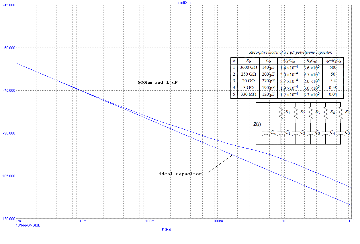

The silver mica is the bad (excess noisey) one. The Pease model uses an R/C ladder which would give a fractional power of f noise. The low frequency limit is just the 5G resistor rolled off by 50pF with a simple RC time constant. The lower plot conforms to this very closely.
A good question is the mechanism, a quick search of the literature does not turn up anything. The easy argument is "if it looks like a resistor it is", but DA comes from complex dielectric electromechanical interactions.
Here are some simulations for 5G and 1u

It's a distraction, just that I tacked the cap in and left the leads long. At 5G Ohms any movement makes for some charge induced. SY is right the mica cap has several KOhms of real impedance midband due to DA loss and this is what is important.
ESR/DA I'm not sure they are distinguishable except that an ESR would act like a fixed resistance not a distributed RC with a frational f dependence. An ESR would be a flat vs f noise floor just like in the plot where the amplifier noise floor is about 3nV/rt-Hz.
Please don't be distracted by these details because I can't help trying to explain every one of them.
