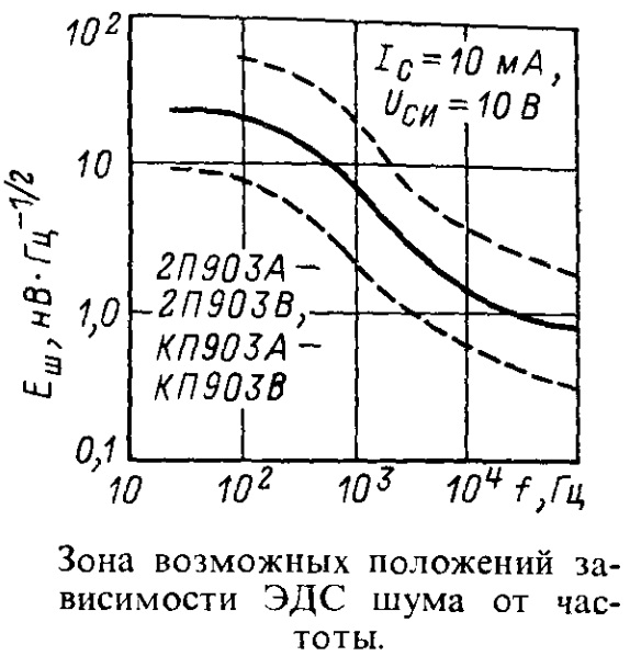

For the 2P903A, the noise range is 0,5...1 nV/sqHz, typical value is 0,7.
I would also like to have independent confirmation of these data, hope that the member of this forum, the BEAR , will be able to report the measured results (he is doing tests now).
Is there any plot of voltage noise density vs. frequency? Frankly speaking, I am quite suspicious to soviet/russian parts and their specs. I know what I speak about, I had worked on mil. projects in deep past.
Here it is, Noise EMF in nV/sqHz, vs frequency in Hz, Id=10mA, Uds=10V
The 2P903A parts are close to the lower curve.
