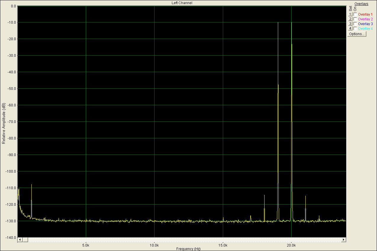

I get this from my player with CS4397. Is it "bad"?

They claim 24bit resolution. Maybe the modulator is only 9.5-14 bits, but with oversamling and decimation, you still end up with >110db dynamic range.
Of course they do. And even then they do not even deliver 20 Bit analogue performance... So I guess it is best described as a DAC that accepts 24 Bit Data, but does not offer 24 Bit analogue performance (like almost all DAC's out there).
