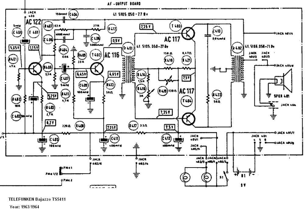

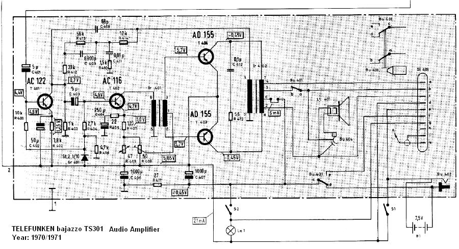

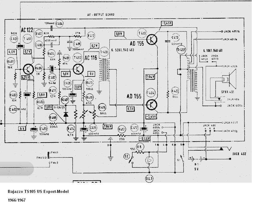

The early transistor amplifiers were designed by guys who were used to vacuum tubes. So they often used driver phase splitter transformers that had a center tapped output to provide bias. Of course with PNP transistors the supply rail was negative.
I have a Telefunken radio that I use daily that uses a circuit very similar to this. I have used this sort of radio on a daily basis since 1965, when after a search of quality portable radios, in London, Paris, and finally Munich, I found this particular radio.
It is a Telefunken Bajazzo and is was partially designed by none other than Dick Sequerra.
It sounds very good, MUCH BETTER than you would expect. It has a 'non fatiguing' quality that always surprises me, because sometimes the IM can be almost overwhelming with a low battery or high levels, but it still does not give me listening fatigue. Quite surprising, actually. And yes it has both a driver and output transformer.
Mr Curl,
According to data from Antique Radios, 120 000 Antique Radios on display, there are 60 models of Telefunken Bajazzo spanning from 1950 to 1978 !
Can you specify the exact model please? (I am surprised that Dick Sequerra designed for Telefunken).
A large part of the great sound of these radios is to be attributed to their very good large and oval speaker unit.
Regards
George

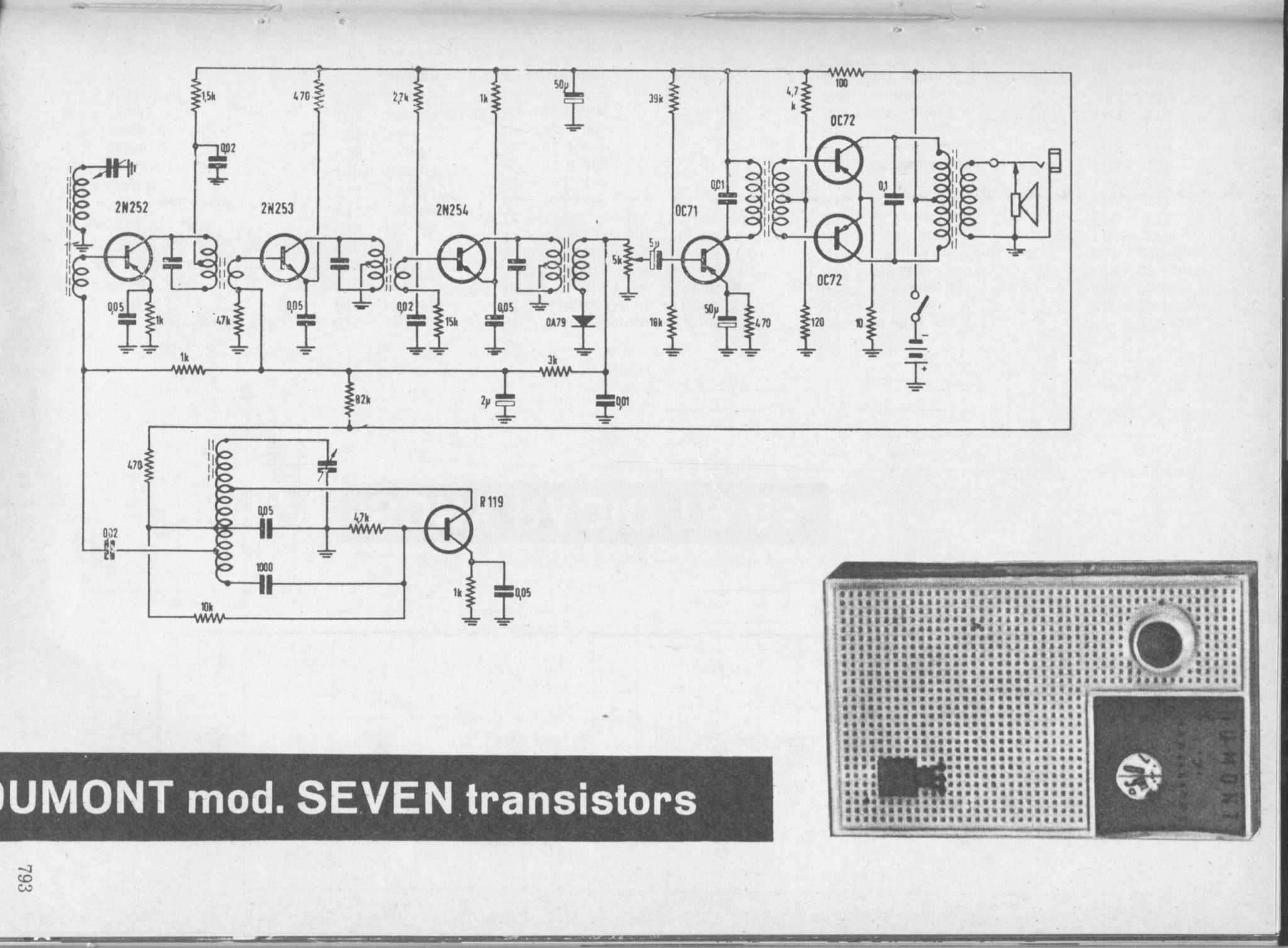

I remember all the little Japanese AM/FM portables (the very small ones - I bit bigger than an iPod - Silver, Hitachi, Sanyo et al) also used transformer coupling - but they did not sound as good as the Telefunken table top portable which we had a a family radio.

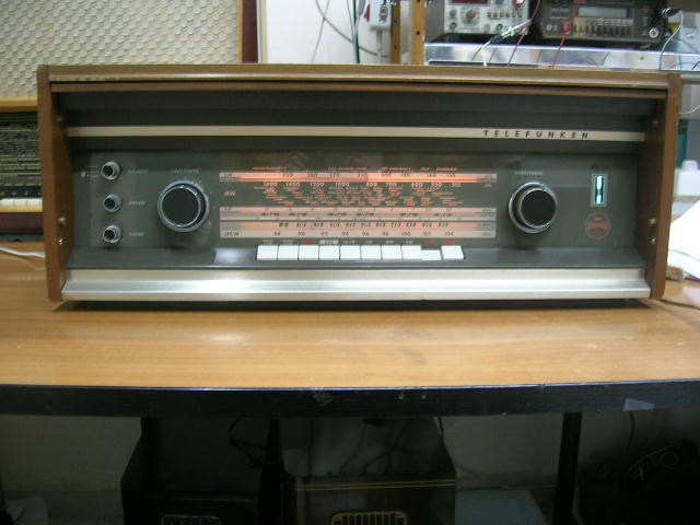

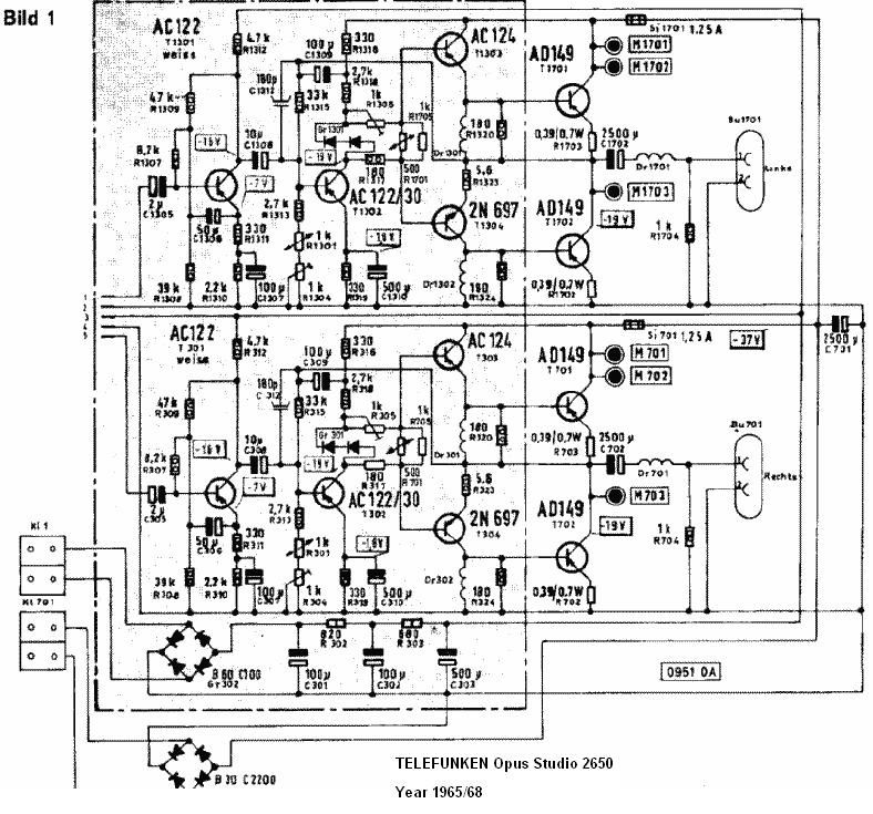

Here is an exception.

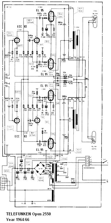

TELEFUNKEN OPUS STUDIO 2650 (Year 1965/68) *.
The audio frequency section built around semiconductors, while the earlier TELEFUNKEN OPUS 2550 HiFi (Year 1964/66) was all tuby
Schematics from Antique Radios, 120 000 Antique Radios on display
* Nominal output 2x15W/4 Ohm (DIN)
Freq. Resp. 40Hz-16kHz +/- 1.5 dB
THD (1kHz, Nominal Output):0.2%
IMD (250Hz/8kHz, 4:1, Full Output): 2%
Regards
George
I don't think think was a portable though ('radiogram'?). I saw many of this style Telefunken in my youth.
The audio amp section looks vaguely like a practical wireless amplifer from I think about 1969 or 1970. The PW was built on veroboard or strip board using same AD16x devices and the circuit looks familiar (I am trying to recall back 35 years here). IIRC the PW claimed 10W per channel. Maybe someone has the article.
Wonderful old circuits. Thanks for sharing.
