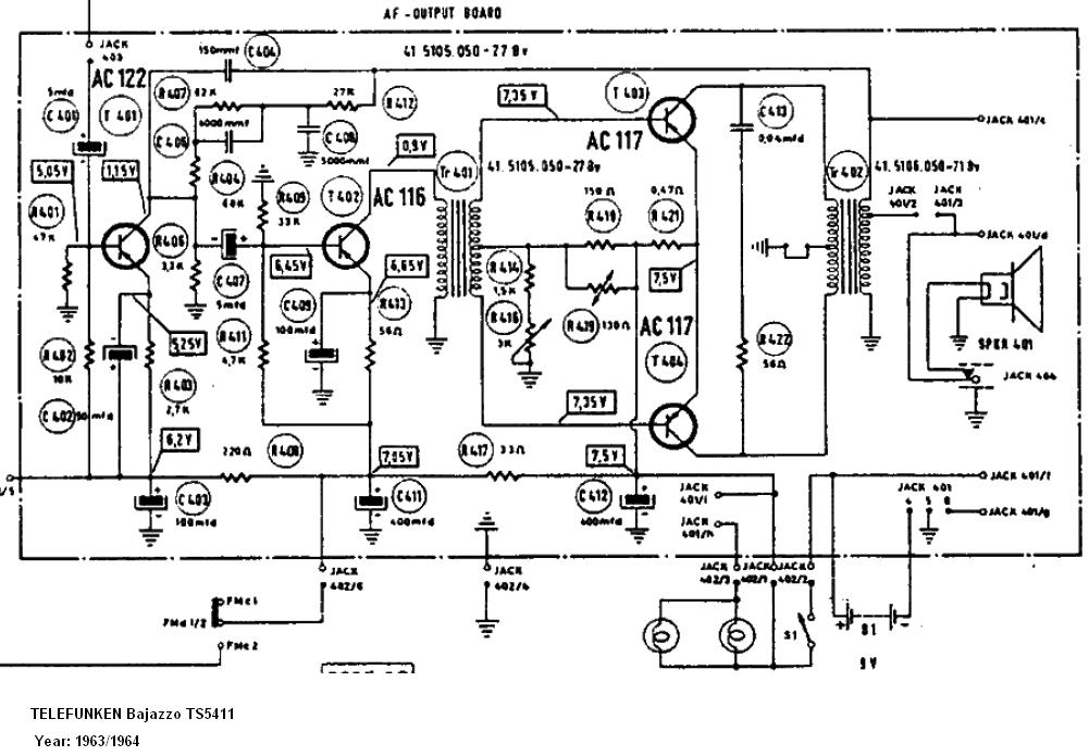

The portable radio that I listen to, almost daily, is like the Bajazzo TS5411 amp stage. Please note the lack of a global feedback loop.
On Bajazzo TS5411 (http://www.diyaudio.com/forums/analog-line-level/146693-john-curls-blowtorch-preamplifier-part-ii-1642.html#post2734795 ) , global feedback is from output transformer secondary tap, from the same coil that the speaker is driven (typical).
On Bajazzo TS301 and TS105 ( http://www.diyaudio.com/forums/analog-line-level/146693-john-curls-blowtorch-preamplifier-part-ii-1642.html#post2734760 ) global feedback is from output transformer secondary coil. This coil is only to provide the global feedback signal.
The speaker is driven through taps on the primary of the transformer. Quite odd.
It was BV post that made me look closer to the schematics.
I have used both examples. I am currently using the TS301. However, is it really 'significant' global loop feedback. Look closer at the complex network, and caps to ground in the feedback loop.

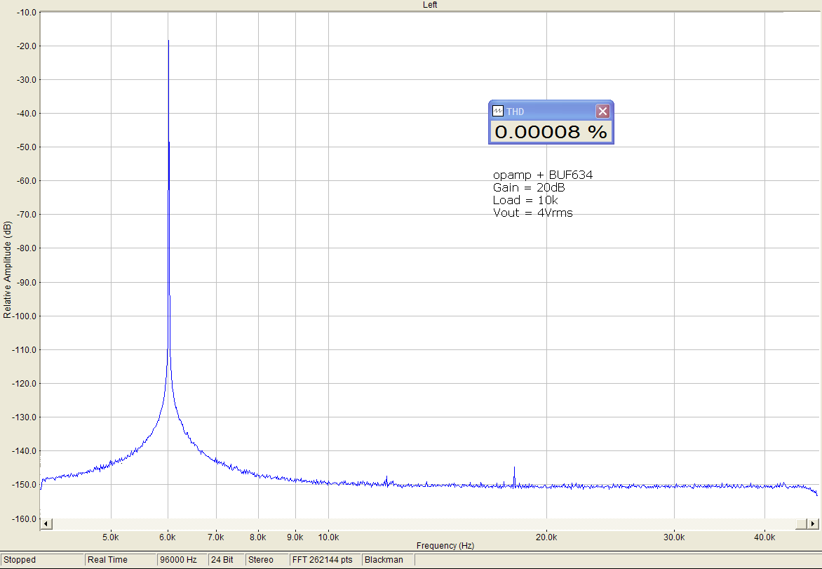

But -80dB at 9th harmonic would indicate EXTREMELY POOR design ...

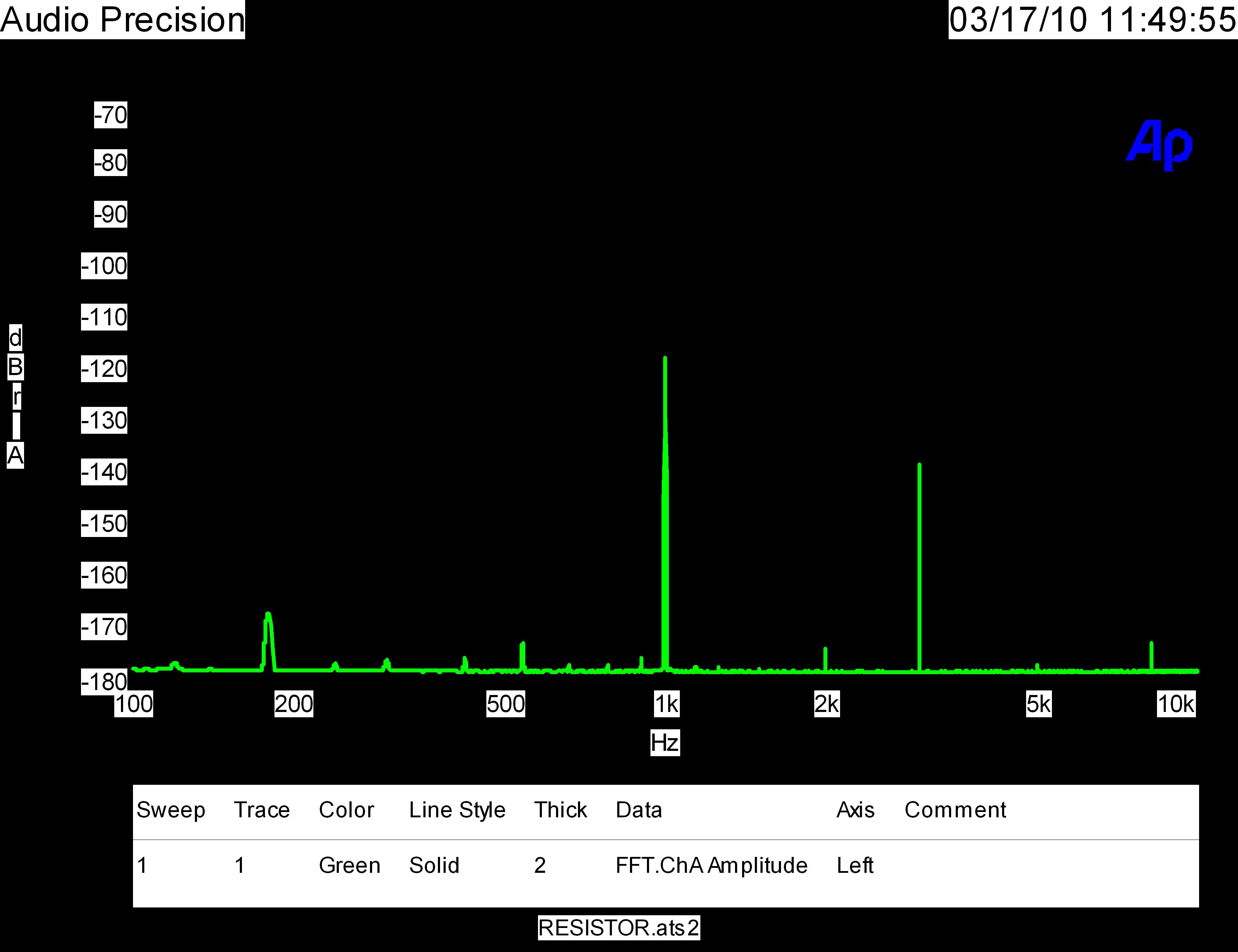

Pavel this is the distortion of a single 1/4 watt miniature metal film resistor. It has ninth order distortion all by itself. If you use a bunch of these at closer to rated power in even a preamp operating at 100mV or so I think you could get -80dB of 9th, with even a decent circuit topography.

Ed, in case I do not measure such plots on a completed amplifier/preamplifier, then I probably do not have this kind of problems, right? The smallest resistors are metal 0.6W 1%, and none of them is operated at power dissipation close to its rated power. In fact 10x less and more. So I do not see any problem here.
For the transformer coupled design
I would consider this Bajazzo circuit as a reminiscence of 'good ol' days'. Nothing serious for highend design 😉

I assume you don't have the problem,as you understand the issues. But it was surprising to find reputable brands (two of them actually) of resistors that I have seen used in others' circuits do have these properties.
ONE MORE TIME !
Distortion is not cumulative !
You may (or not) have ninth order cancel ninth order ...

Without an inverting stage distortion from the same mechanism is in phase and does add. (Keep in mind double the voltage is only 6 db.) But the third also passing through the second device goes to ninth. If you look at the plot you will see fifth! A result of the second and third.
