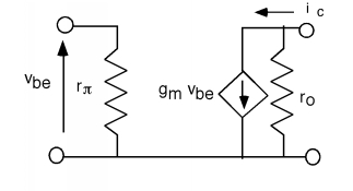

I don't think you can talk about loop gain in an emitterfollower in the sense that you imply.
If you look at the attached, and hang an Re off the emitter, I can't really see a loop, although there is clearly feedback visible.
I posted this before:
Vout=Ve= Ie*Re
Ie=(Vin-Vout)*Gm
thus Vout= (Vin-Vout).(Gm*Re)
reworked to Vout/Vin=Acl=(Gm*Re)/(1+Gm*Re), for DC and ignoring base current, no load?
Which approaches '1' for Gm*Re >> 1.
(With Vin between B and gnd, and Re to gnd, and Vout between E and gnd).
For me the feedback factor is the fraction of the output voltage that is fed back to the input voltage which in an EF is 100%.

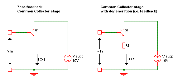

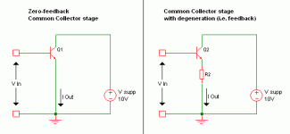

When trying to figure out the loop gain of a common collector stage, it's useful to think in terms of output current rather than output voltage.
In that case gain = output current / input voltage. In the zero-feedback circuit below, gain is simply 1 / Re. In the second circuit, gain is 1 / (Re + R2). So gain has been reduced by a factor of (Re + R2) / Re. The feedback factor (or loop gain) is about the same, depending on your definition and pickiness about the exact math.😀
I appreciate that the zero-feedback circuit would be completely useless, but it is generally recognized that emitter followers have "a lot" of voltage feedback. Thinking about it this way lets you quantify that better.
E.g. If the transistor is biased at 1mA, Re = about 25 ohms. If the follower is driving a 250 ohm load, the loop gain is about 20dB.

Thanks Godfrey, that clears up things for me.
I do want to note though that your Re is the 'internal' emitter resistor (1/Gm) while in my posts I have used Re for the external emitter resistor, which in your 2nd circuit is R2.
jan
Yes, thanks for pointing that out Jan.
To continue....
This allows us to do "distortion vs feedback" calculations in much the same way as with other circuits.
E.g. If you have an emitter follower with an idling current of 1mA driving some or other value of load resistance, you might want to halve the distortion by adding another 6dB of feedback. To do that, you need to increase the open-loop gain by 6dB, and to do that you need to halve the intrinsic emitter resistance by increasing the idling current to 2mA.
I can't get excited about that kind of thing, but what I do find interesting is that it can also give quite a clear insight into stability considerations for followers. Suddenly "mysterious" oscillations aren't so mysterious and avoiding them becomes less of a black art relying on folk remedies such as "putting a coil on the output usually works" or "you might have to add base-stopper resistors", which leave a lot of folks not having any idea how to calculate appropriate values and either just copying what somebody else did or figuring it out by trial and error.
To do this kind of analysis, we need to take into account a couple of second-order effects. Doing that we get something like:
Open loop gain = output current / input voltage
= 1 / (intrinsic emitter resistance + (intrinsic base resistance + source impedance) / current gain)
So at high frequencies, where the current gain is rolling off at 6dB per octave, the open loop gain is also rolling off at 6dB/oct. If the source impedance is inductive, the open loop gain will be rolling-off at 12dB/oct at high frequencies.
Now if the load is resistive, the demanded closed-loop gain is frequency-independent. However, if the load is capacitive, the demanded gain is increasing at 6dB/oct.
The end result is that if the source impedance and load impedance are both resistive, the loop gain will have a first order roll-off. With a resistive source impedance and a capacitive load, the loop gain has a second order roll-off and you may be in trouble stability-wise. With an inductive source and a capacitive load, the loop gain has a third order roll-off, and you're almost certainly in trouble.
Anyway, the point is that looking at followers this way allows you to plot gain and phase vs frequency for the open-loop gain, closed-loop gain and loop-gain (or feedback factor).
