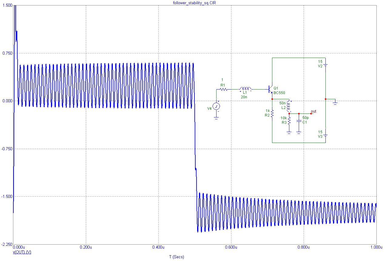

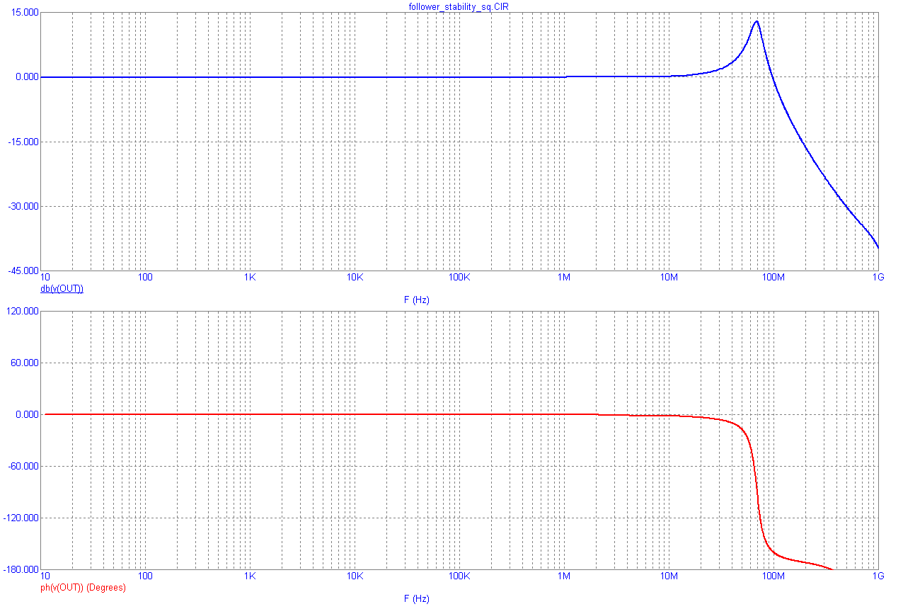

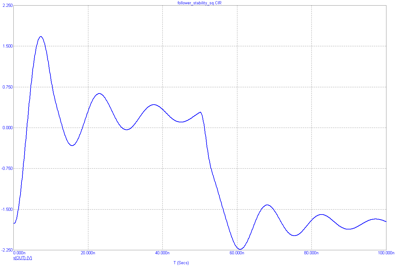

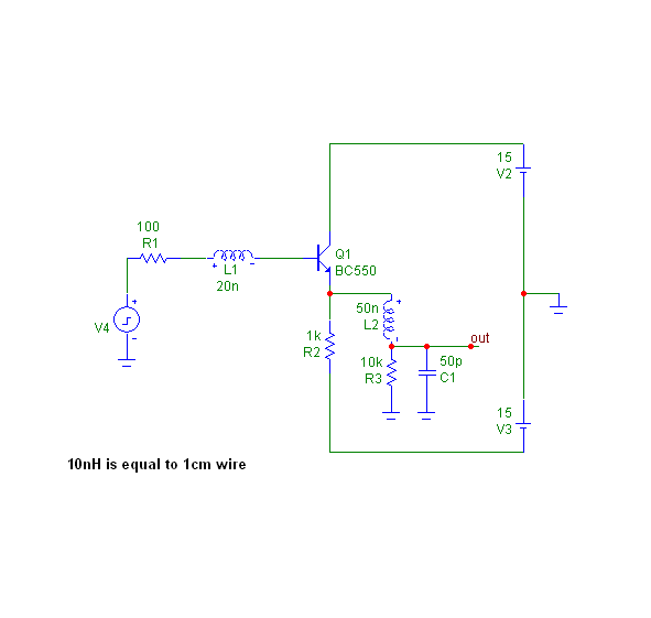

We can sim the follower sensitivity to oscillations when considering real life topology. 1cm of wire or PCB track has inductance of 10nH approx. Following example is quite realistic. The oscillations are damped in this case.
Very special case is a JFET follower. But there are another experts on this issue, so I am not disclosing its behavior.
