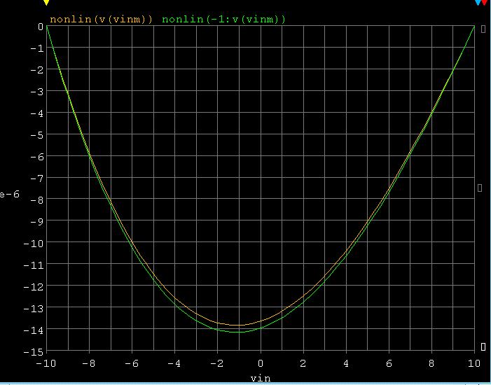

In any case, you will love this -
The elimination of the resistor to ground did little to alter the results.
What did make a difference was precisely compensating for the amplitude
and phase shift between the input and output fundamental.
The result was a fairly pure second harmonic which looks like the
degenerated case. I don't doubt that there is some 3rd lurking down there
somewhere, but you can't see it visually - it's certainly a lot less than
Baxandall's curve.

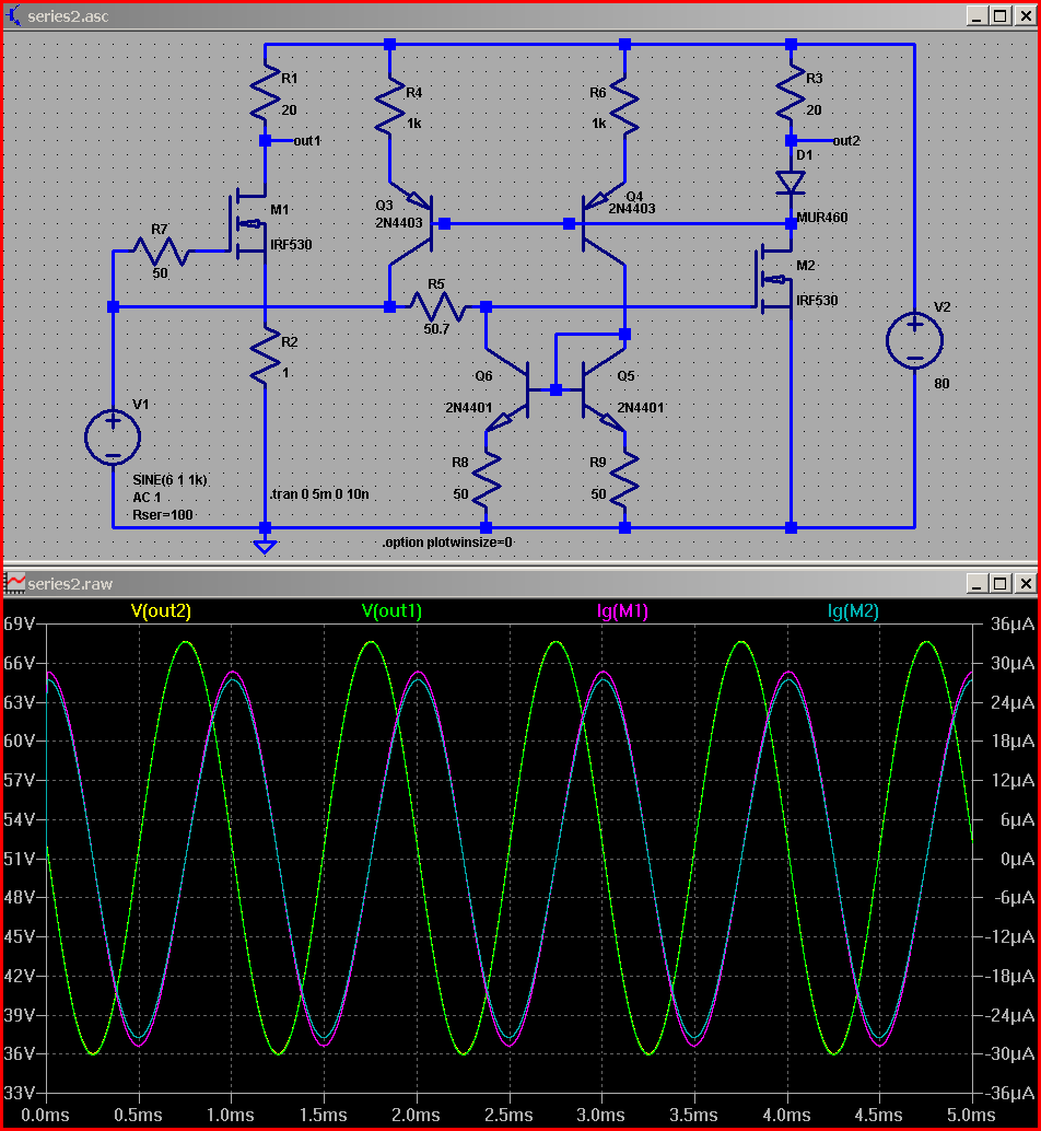

again with showing how to get "the same" response as degeneration with "loop feedback"
this time I used power Mosfet to be closer to Nelson's sim, actually used "real parts" to measure, transfer, float the feedback in series with the M2 gate across the 50 Ohm R5
the waveforms, distortion profile match very well: the "big" (ie visible) 2nd harmonic diff is ~0.9dB
the "real" input current for the M2 circuit is dominated by the bjt mirror errors
a "curious" behavior is that the Ltspice included IRFP240 model gives a deep notch for the 2nd harmonic in M2's output - which goes away when the supply
V is boosted to 200 V - I wouldn't think the small Vds AC difference due to the degen R would have an obvious effect

a "curious" behavior is that the Ltspice included IRFP240 model gives a deep notch for the 2nd harmonic in M2's output - which goes away when the supply V is boosted to 200 V - I wouldn't think the small Vds AC difference due to the degen R would have an obvious effect
Given that the load is fairly high impedance, I think you were seeing the
load-line cancellation of 2nd harmonic - the variation in gain due to Vgs
cancels that of the Vds, also known as the "sweet spot". At higher voltage
that point will correspond to a somewhat higher load impedance and vice
versa (IIRC).

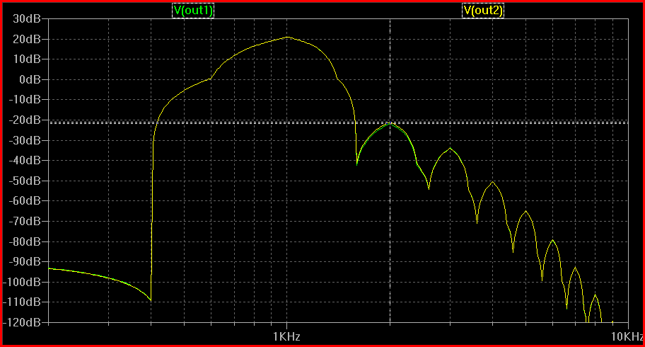

I took my loop feedback example down to 10 Hz to remove most of the phase delay, and here is the resulting waveform. You can see the 3rd harmonic compression more clearly.

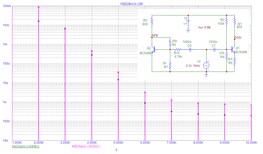

Some simulations with MOSfets and low power bipolar transistors
Interesting. How "real" are these models?
Also, could we make both either 10dB or 25dB Gain, not two different ones, so we compare as much as possible equal systems?
As it stands, it is hard to say why the differences fall the way the do, between BJT and FET. I have my suspicions, but rather see more data...
These comparisons are only valid in situ. The source and load impedance interactions are not the same. In circuit there are no ideal generators except at the input and then only in simulation. Note the subtle complexities of Middlebrook's work on really breaking a feedback loop.
