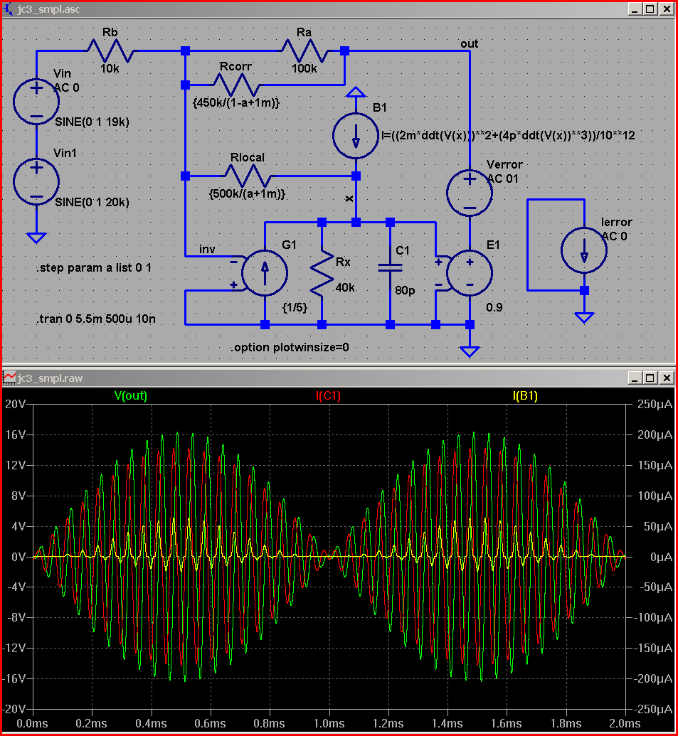

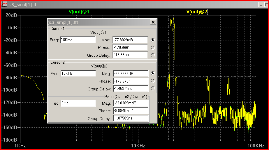

Scott, I may have wasted more time than you:
If the discussion is centered on the JC-3 power amp schematic: http://www.diyaudio.com/forums/anal...ch-preamplifier-part-ii-1570.html#post2703152
the specific claim is that the inner local feedback loop was added to reduce PIM through the local feedback reduction of the impedance driving the unity gain Darlington output
This is I believe a claim “testable” in sim – meeting Scott’s criteria
The result is that however John understood it at the time it is easy to show that in a simplified JC-3 sim the local feedback doesn’t reduce at least one simmed source of PIM
I claim a useful but highly simplified model is in the sim below
The input fets, “VAS” Q are modeled as a pure gm
The output is modeled as a Voltage buffer with Av 0.9 to sim speaker loading
The node “x” has estimates of reflected speaker load, Q parasitic R, C
The local feedback Rlfbk is switched in the .step param statement
at the 1st sim “step” parameter a = 0 and the Rfdbk is essentially out of the circuit by being multiplied by 1000x and Rcorr is added in parallel with Ra
at the 2nd ”step” the local feedback active with Rfdbk at the nominal value of ~500kOhm
compensating Rcorr is added in parallel with the outer gain R to correct for the closed loop gain reduction with the local feedback R
I see it as using pretty much the same total loop gain to get the same closed loop result – just “moving” the feedback between inner and outer loops
The added Isource at node “x” is the classic “disturbance injection” of Bode sensitivity analysis – as Putzeys points out it can sim anything about the components connected to node “x” that result in a current change into that node
This could include Q output conductance, driver Q base current, nonlinear C… for AC testing the classic Bode frequency response of the Ierror sensitivity would use the source I put on the side (you have to short, gnd your spare spice cs)
likewise Verror can sim anything that results in a difference between the idealized model and whatever we can write a model equation for taht gives a series V diff - like Vbe, Re V changes with load current
to play with the sim you should look at the classic Bode sensitivities – for the values I guestimated there is virtually no difference in V(out), or V(x) for Ierror AC sweep (move Ierror to the B1 position) despite the swapping in/out of the local feedback - the AC value of all sources except the tested sensitivy should be changed to 0, the active source AC should be 1
in the AC analysis frequency sweep of Vin the input error V(inv) differs by ~1 dB when the local feedback is moved
but looking at Vout, AC sweeping Verror frequency we can see that sensitivity to Verror is reduced ~40 dB when the local feedback isn’t used – just so you don’t miss it these distortions are much lower (~100x) without Rlfdbk
These should tell you a lot if you understand Classical Bode Analysis, the disturbance injection analysis logic – but expecting intellectual resistance I did a transient sim with the B1 nonlinear C model for the “disturbance”
For the transient sim my B1 source is used to model nonlinear C current with the derivative of the voltage, V(x): ddt(V(x)) I then add 2nd and 3rd powers of the derivative in the behavioral source equation
The wave plot shows the relative magnitude of I(C1) and I(B1) – the yellow I(B1) is clearly in phase with red I(C1) trace and plenty distorted
To see the (PIM?) IMD products I simmed with 19+20 kHz 1:1 and looked at the fft plot
By using V(out)@1, V(out)@2 syntax you can look at both feedback conditions, place measurement cursors on each
@1 = no local feedback, @2 = with John’s local feedback Rlfdbk = 500 kOhms
The IMD product at 18 KHz is examined with the cursors – displaying the relative phase, magnitude of this product with and without the local feedback – giving deltas of mdB, ns
There is no meaningful difference, all distortion products are “the same” in the simplified JC-3 power amp sim with or without the local feedback - in amplitude and phase to very high resolution - not at all by the 20-40 dB expected if the local feedback change of node x impedance was significant

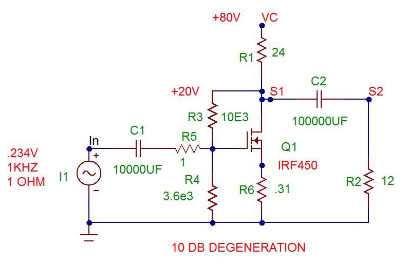

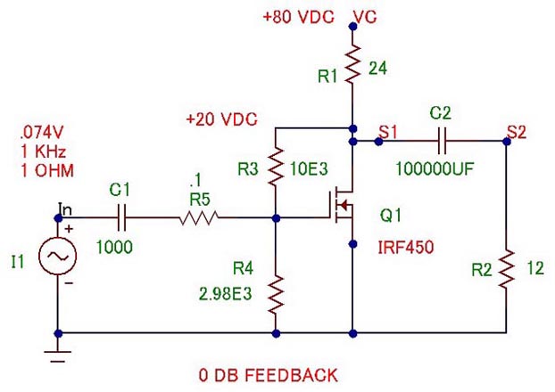

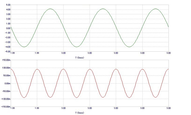

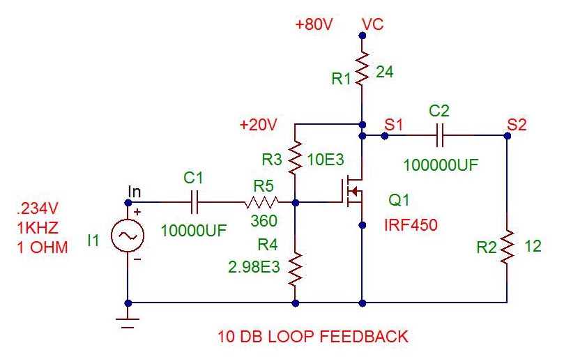

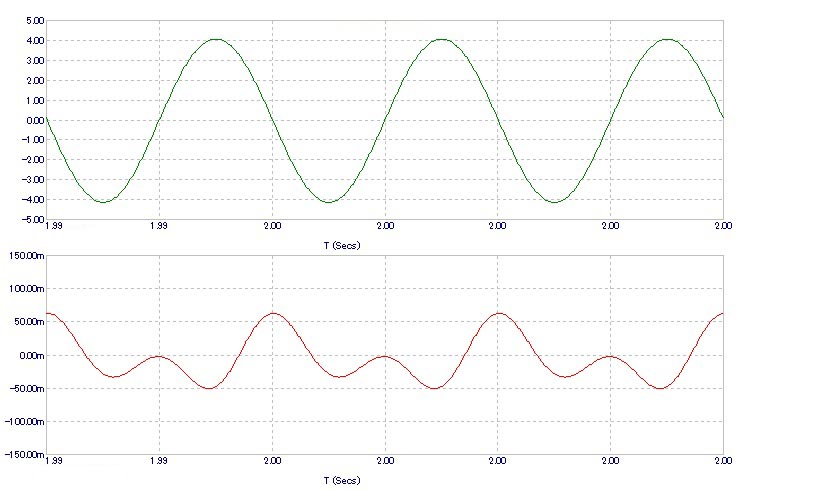

care to point to a circuit that shows the difference between degeneration, negative feedback that you're asserting?
I was waiting for you to ask.
First I have constructed (in MicroCap) an example of a nice little common
Source amplifier without any feedback (except for DC stabilization).
I have done it in a way that a DIYer could build and actually listen to -
obviously I could have made it simpler.
Then I have an example with 10 dB degeneration via a Source resistor.
Then I have an example with 10 dB of loop feedback.
All are driven for a +/- 4 volt output, and the transistor in each case
experiences approximately the same load line.
If you don't think think this is reasonable, let me know.

You REALLY don't get it, do you. Nelsons argument and mine is that 10dB Gain reduction applied through degeneration and 10dB gain reduction applied through looped feedback are VERY DIFFERENT, while everyone here seems to assert equivalence.
They are commonly referred to as "negative feedback". I prefer to call one "degeneration" and the other "negative feedback". I assume Nelson knows feedback theory, I do as well, certainly it seems we know the difference. Neither Nelson nor myself claim the two types of to be the same, but we claim them to be DIFFERENT.
What DOES feedback Theory say about the Circuits that Nelson and myself illustrated? And no, I am NOT interested in your Sim, because it precisely fails to address the subject.

Since you have done them in MicroCap, no doubt you would also show us the distortion spectra ??
Since JCX has disposed of my examples as not representing loop feedback
vs degeneration, I don't see the point.
But of course I will anyway.
I am only going to show you the distortion waveforms created by subtracting
the scaled input from the output.
The first is no feedback, the second is degenerated, and the third is loop.
