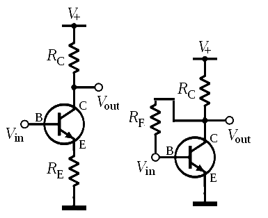

PMA, it would be better that you used the guideline stated by Otala if you are going to make a comparison between what he got and EXACTLY what you are getting. You don't appear to be paying any attention to the original test that I felt was 'interesting'. Your voltage gain is off, your bandwidth limitation is off, and you are using a different part. What would you expect to 'compare' to the original work?
care to point to a circuit that shows the difference between degeneration, negative feedback that you're asserting?
Let me first say that reading the last page I am feeling like it is the day of the bewilderbeast. Gentelmen, YOU HAVE GOT TO BE KIDDING!
As for the challenge, see attached. Would anyone like to assert the equivalency of these two circuits given the same amount of feedback?

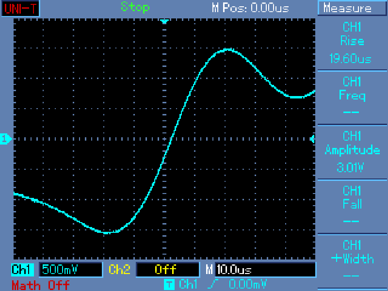

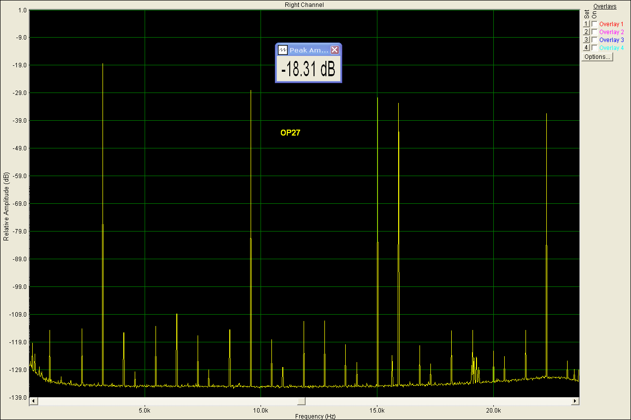

It is bandlimited at 24kHz.
I am sure I can get enough information, for the reason that I have much higher dynamic range in the FFT analysis, compared to the original paper. The question is if the efforts would bring any new and usable information and insight.

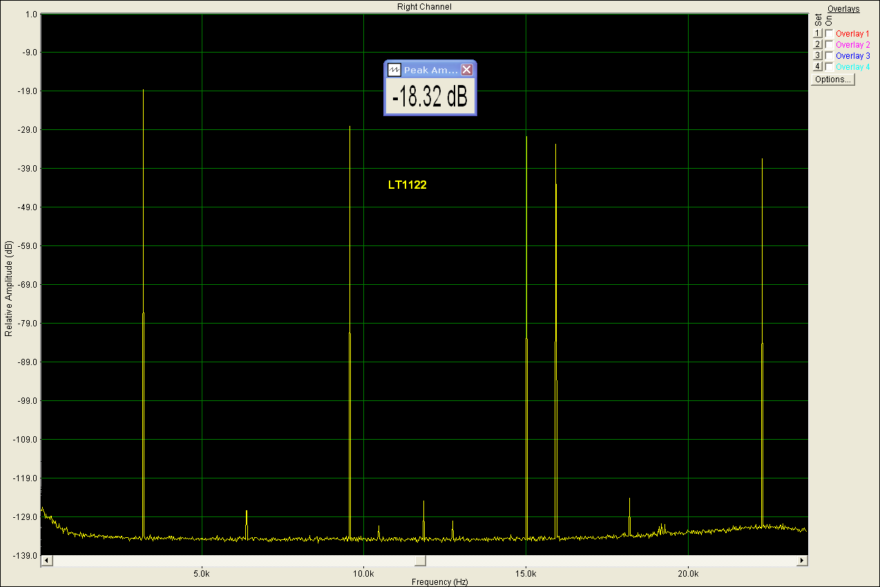

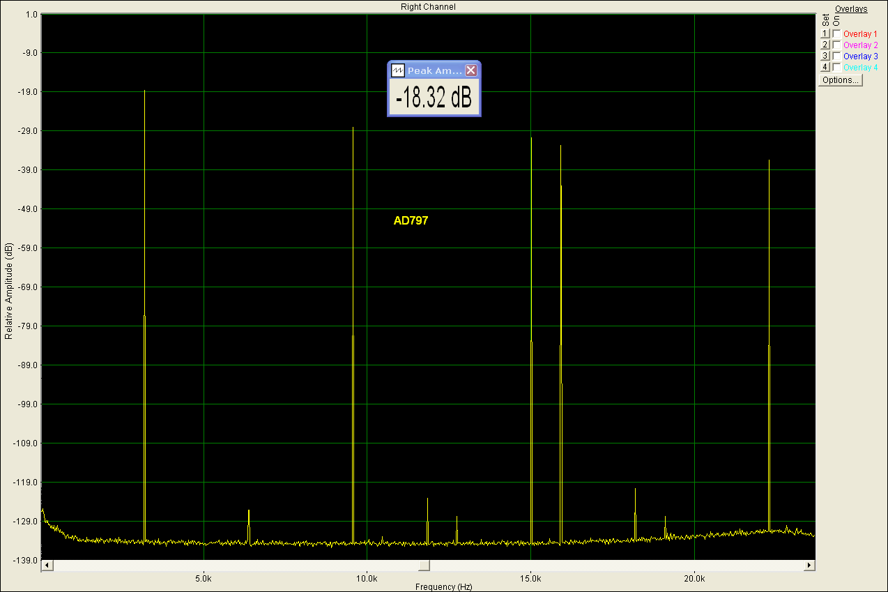

AD797 gives very good results, and LT1122 is the best from several opamps I tested, regarding TIM. Slew rate matters, even for bandwidth limited (24kHz) DIM test.
This method seems to be a useful additional test method to standard THD, SMPTE and CCIF tests.

Degeneration and loop feedback are not the same thing, one of the issues
I have with Bruno's article, as he has made statements that imply that
they are.

If I take two gain stages and apply global feedback, and compare that to the same two stages each with local feedback for the same gain and compare that to two stages with partial local feedback and overall global feedback to the same gain, you support that all of these will have the same final distortion spectra?

You again are putting words in my mouth, I never said the same. In fact if you apply the JC-3 trick to the AD844 the distortion is WORSE. That is inverting gain of ~10 with the Tz node used for local feedback to the inverting input. This is freshman year stuff. The major source of distortion (the tanh function of the output diamond) is inside the global loop but not the local one. Less global feedback more distortion. DUH!
BTW if you load the Tz to ground it is also worse.
What Cherry does is show you how to ADD gain stages and still make things stable. As the two series opamps with VERY high OLG and an initial 40db/dec roll off.
Quel dommage! You mean the AD797's performance is SID/TIM limited?

no, I do not think so. It behaves very well, and both AD797 and LT1122 measurements are close to the limit of my method/instruments.
Regarding "SID/TIM limited" term, it is always a question of a "measure", how close we are to component's slew rate. And, it is not easy to distinguish between influence of slew rate and common "static" non-linearity.

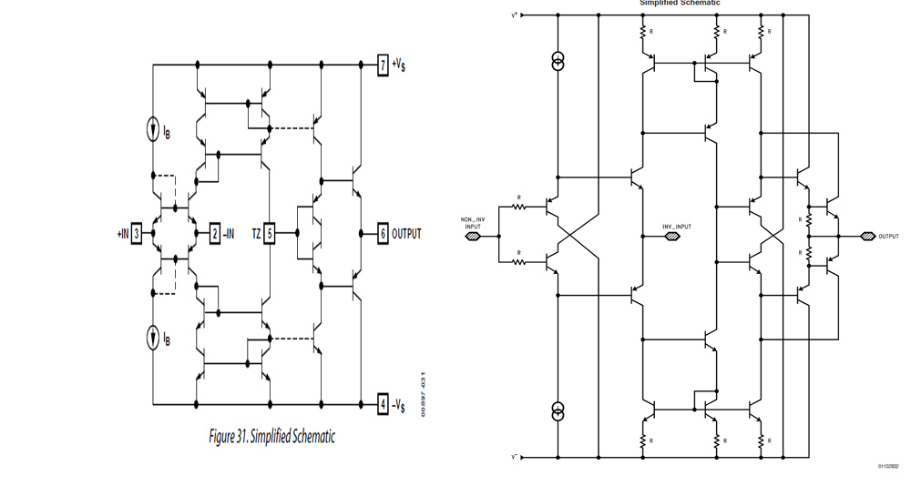

The AD844's "single stage" current feeedback design means that not only does it have rather low opan-loop gain (can't be bothered to calculate it) but I suspect that the output stage is pretty resolutely "class B".
How about a more conventional topology?

Charle's Hansen for one. Actually the gain is rather high, several thousand, probably higher than the JC-3 with the vintage devices and no cascode at the high Z node. The AD815 is not matierially different nor are any one of the other basic CFA's. We needed the DSL business to light a fire under the designer's seats. And please don't obscure the point, the output stage induced distortion is WORSE no matter where it starts.
Thorsten's NOT equivalent circuits are a Strawman

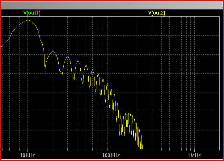

The sim below shows a equivalent feedback formulation of the CE gain stage with “output current sampling” – using a spice E dependent source to transfer/scale the collector R voltage to the emitter of Q2
this is "the proper" way to create an equivalent to the CE V gain amp, and addresses Nelson's claim that degeneration has inherently different properties
You only see two traces because the other two colors are over written by the same waveform from the two versions of the circuit
the overlaid Q1,2 I_b plots show that input Z is the same, out1,2 also completely over lie each other
The fft plot shows identical distortion spectrum
Correctly understand the feedback classification system, apply it consistently, and the results really do work, we can show emitter degeneration R gives the same result as “output feedback” in the CE amp at frequencies where the loop gain is large

The AD844's "single stage" current feeedback design means that not only does it have rather low opan-loop gain (can't be bothered to calculate it).

OK folks AM I wasting my time? If we can't agree on what topology means it's going to be rough. HINT: the diode vs follower input devices is a trivial difference (offset considerations). AD844 vs. the LM amp just mentioned.
These are simplified, the AD844 has degeneration resistors and short circuit current limit not shown (making the two schematics even more the same).
