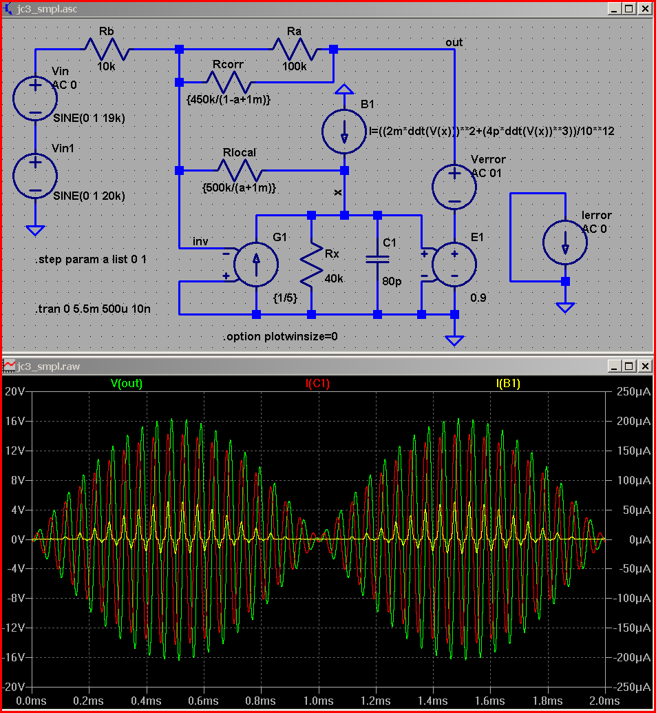

my big post on modeling the JC-3 inner loop feedback http://www.diyaudio.com/forums/anal...ch-preamplifier-part-ii-1581.html#post2705814 was apparently largely ignored – 2 downloads?
it is a abstract, spice sim but I claim it does follow the JC-3 topology and is sufficient for addressing this question of what does the inner loop feedback do for the circuit via any "reduces the drive impedance to the output stage" heuristic
Bode sensitivity analysis shows next to no effect from the "inner loop" on current disturbance at node "x" in my sim which is equivalent to the EF driver Q input, "VAS" interface node
this sensitivity analysis “disturbance current” could be tweaked to follow expected load current/hfe induced base current at this node
but considering it an independent source we can just plot the response of the amp and compare with the local feedback in place or disabled
the plot is really boring - no difference (33mdB difference on 30+ dB base ) with and without the inner feedback R (swap B1 and Ierror, do AC analysis, look at Vout - asc in long post linked above)

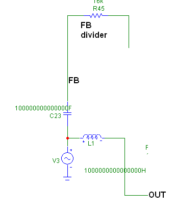

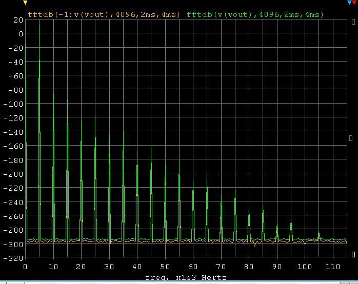

I had time for one more example. So now I made a complete little JC-3 by adding a simple EF output and only making it drive the 80K feedback resistor.
I also fiddled with the input sin wave so with/wo the inner loop the output was exactly the same.
Same answer down to double precision noise. The inner loop is ~1dB worse because is has to drive the 1M resistors (extra 10uA peak). I also did this at 5kHz to bring into play all sources of distortion in the VAS. Don't be fooled by the resolution the worst harmonic is <-100dB. Our simulator has a feature for getting -300dB noise floor, others might too but some don't.

only if you're not holding out some claim that PIM was reduced without affecting IMD - you can see that isn't true from my Bode sensitivity analysis - and additionally where I did a .tran with a nonlinear C current injection - surely that results in PIM?
there was No Difference with the feedback in the inner vs outer loop with the simplified JC-3 topology for the simmed nonlinear Capacitive current B1 model
care to propose another mathematically model-able source for PIM that I could add to the sim to explore whether the inner feedback loop helps?
maybe another stimulus? - most examining the issue believe the 19+20 KHz 1:1 is quite sufficient to show PIM - but I can do a lf + hf, or even duplicate Quan's measures in spice - although that seems like a lot of work for rather obscure numbers
