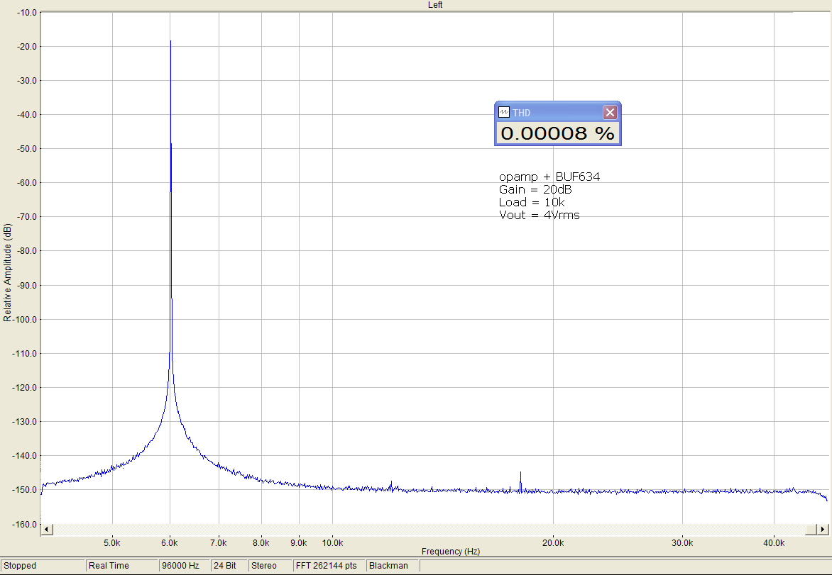

I do not believe in any 'connector distortion'. The contact just has to be clean, without oxidation. This is measured with cheapest low end RCA connectors. Their change has absolutely no effect.

Nice plot. Try it with a signal of 15 mv and still look at -150 into a high impedance load. I think at those levels something shows up.
Of course the real issue is why would you run a system at those levels?
