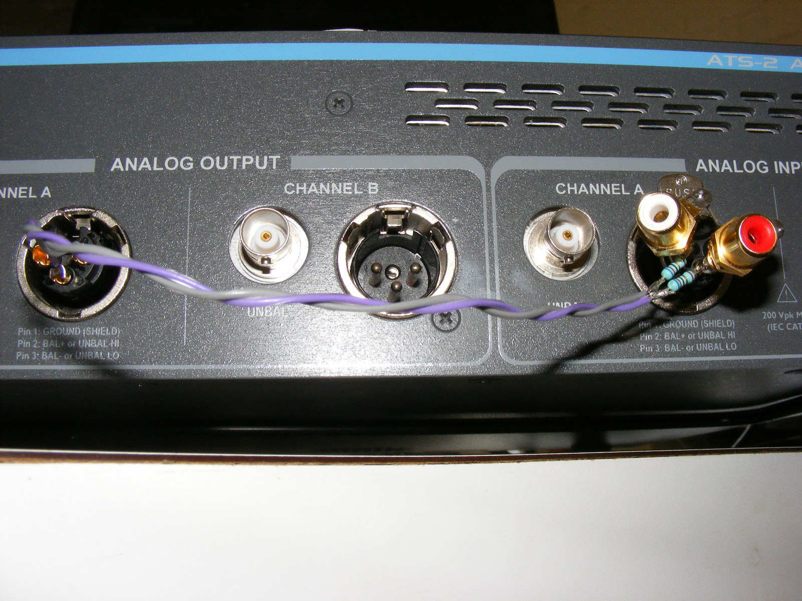

Well I took two XLR inserts and made an adapter for my AP System 2. The female has a 62 ohm 1/4W 1% MF resistor going from pin 2 to the males pin 2. Pin 3 of the female also goes through a matching (.1%) resistor to pin 3 of the male. Attached to pin 2 of the male is an RCA jack the same as pin 3. Both jacks are grounded to pin 1 of the male.
John if you prefer I can easily change the grounding.
Attached is a picture of the setup.

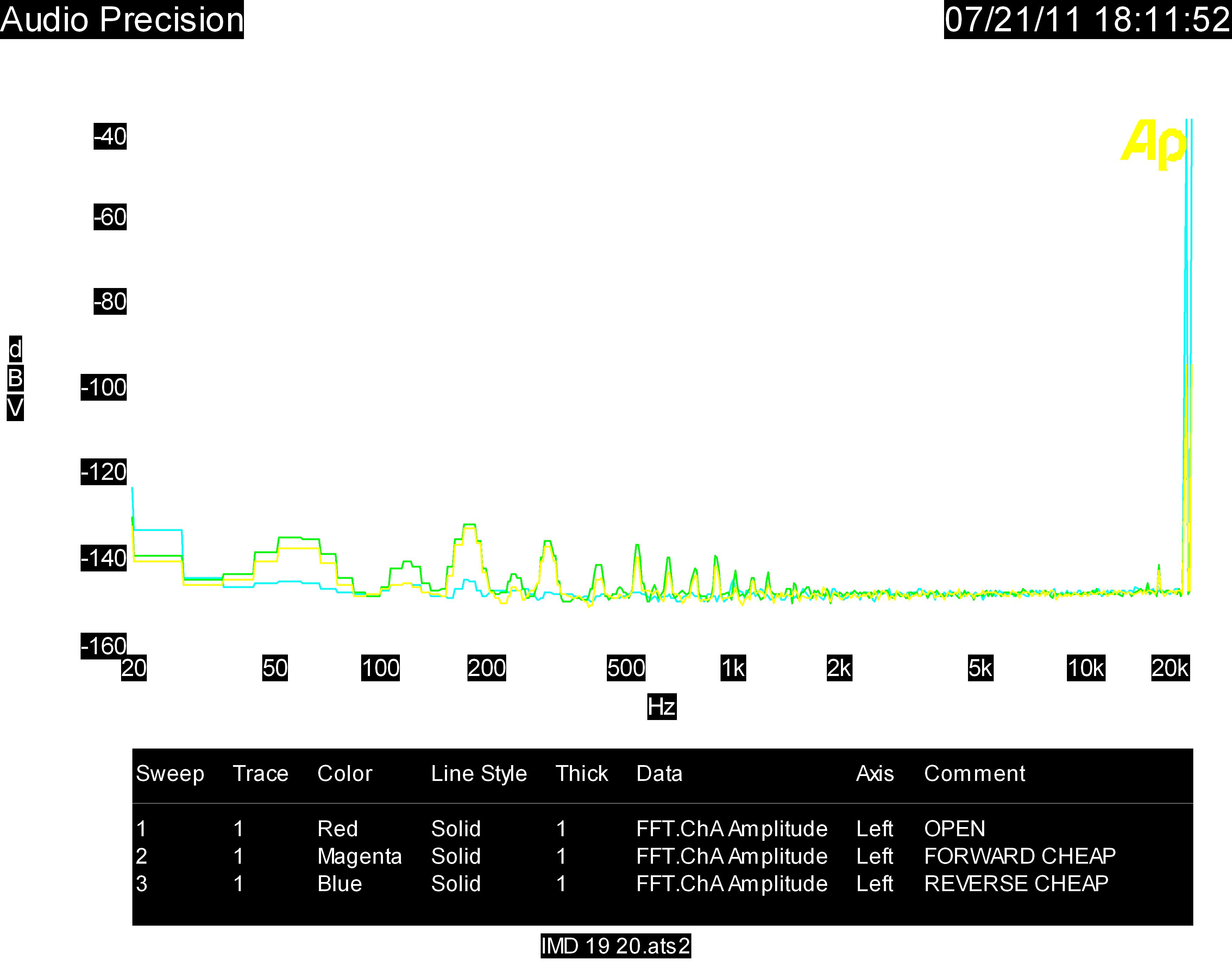

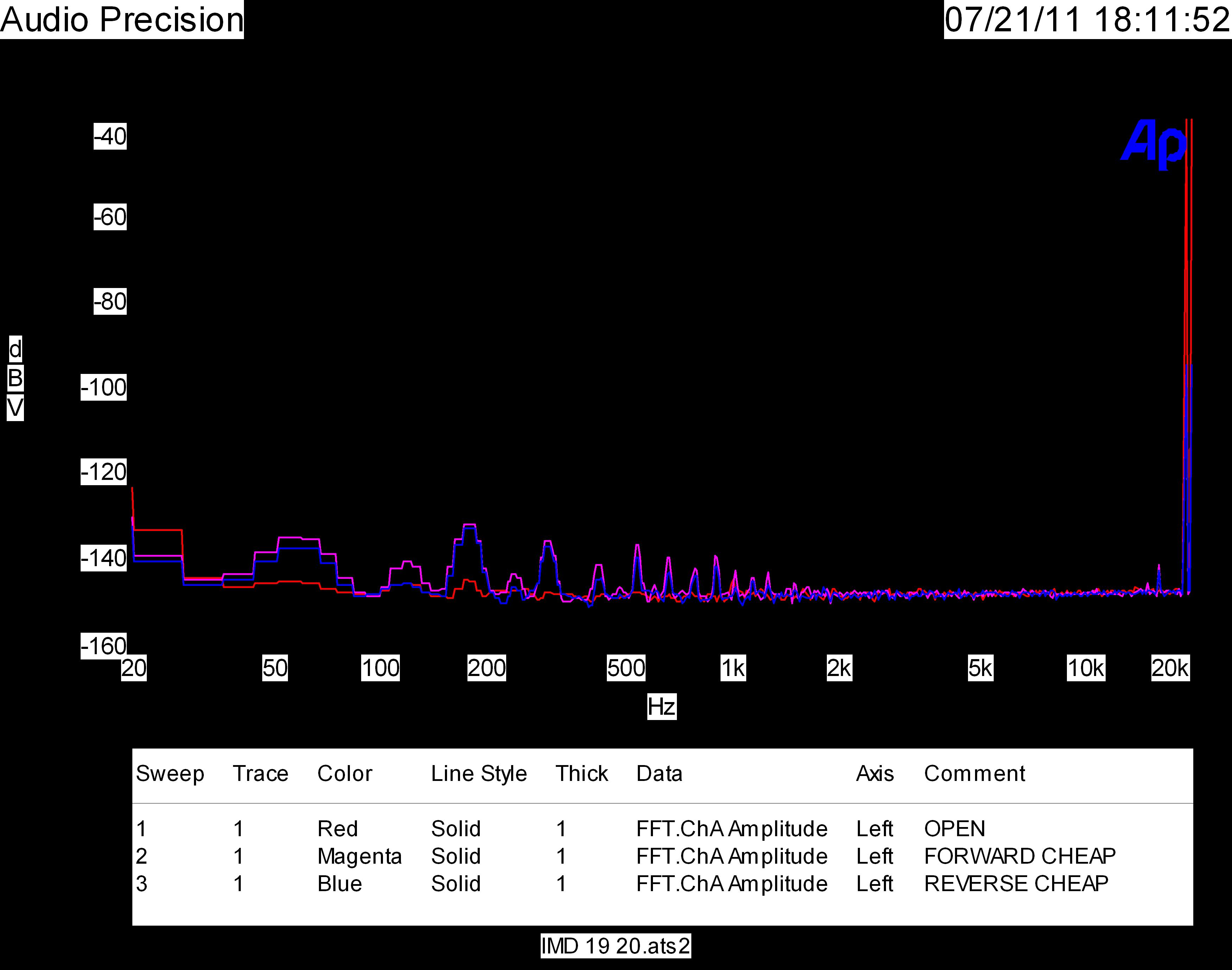

So I set the output to .03 volts at 19 & 20 khz at a ratio of 1/1.
I averaged 32 fft's of the adapter open, shorted with a cheap RCA cable and then with the same cable reversed.
Here is the result. (Colors get messed up in translation)

What is interesting is that you must have inversed the image in PS or something, and the legend does not change automatically.
OK, so it's completely unremarkable. No significant difference in cable direction, and noise pickup from the loop down in the realm where newborns couldn't hear it.

attached color not reversed.
What I find interesting is that everything seems to be correlated with the red line, albeit at somewhat elevated level. Looks like you are measuring something in the machine that gets amplified by this setup. But it is already there. So EMR is the most likely explanation to me.

I agree nothing but trivial changes and nothing much but mains harmonics.
Exactly! There is nothing showing up! The interesting issue is how low the 60hz harmonics are! You have to look lower than this to see any interesting effects. There is no IM showing up at these levels.
So to me this is a good baseline. If there were say a 1K or other frequency showing up that would be an IM product a skilled user would pick that out and ask if it were from the test setup or the device under test. If you did THD then you would might look for different frequencies, but you would ignore the 60hz junk.
So if you want to look for interconnect distortion you need to look lower!
That raises the very valid issue of who actually hears stuff that low? Is there some actual application issue that makes stuff that low more important? Etc?
Personally I think using high impedance loads with high gain on small signals makes the problem worse. I expect to see interesting stuff about 20 to 30 db below the levels shown. So The question of why don't you see these cable distortions on an AP is I think answered by the limits of the test.
If everything is testing the same then your test probably is not sensitive enough!
