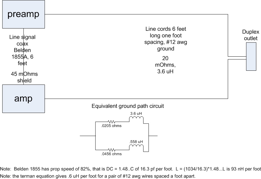

If I follow correctly, the net voltage emerging from the cable screen will be significantly reduced by the ohmic drop of the loop current caused by the near short circuit of the chassis. The voltage induced on the inner will not be reduced because it has no loop current. Thus, as has been said, it will not function as a full coax cable but merely as an electrostatically screened cable. Any changing magnetic field will induce a voltage, including any field from the equipment being used. If the equipment is phase-locked to the test signal then it is quite plausible that the field will contain harmonics.
One small correction...it appears that the shield is connected to one of the differential inputs. So the total shield loop resistance will be the sum of the shield R (perhaps 50 milliohms), the contact resistance of the connection (perhaps 10 to 100 milliohms), and the differential input resistance to ground (it looks like several thousand ohms.)

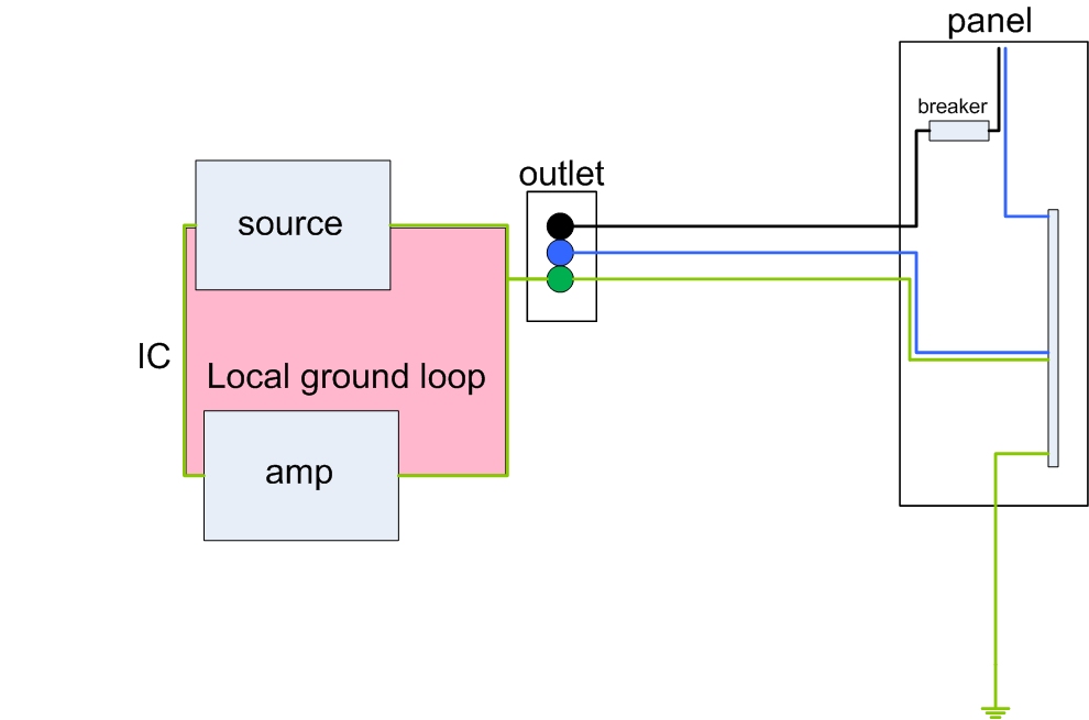

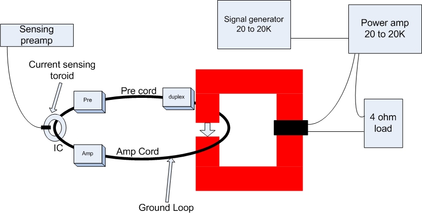

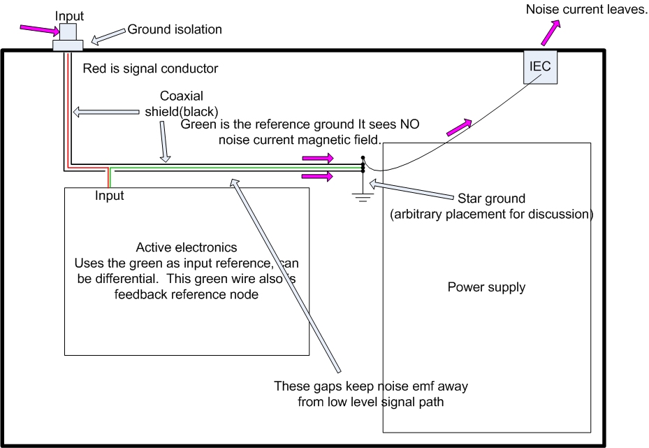

Pics attached..edit..sorry about the pdf, I gotta change that to a jpg..
I believe most of this is self explanatory.
Cheers, John

Look at the schematic for the 1700B..specifically, the summing amplifier. Note that the input reference node to the summing opamp is directly connected to ground. Does the test current that made it to the input differential tie directly to the same point at the same location? Is it a star geometry? Is it just a simple trace? Is it a ground plane? Can it alter the performance of the summing amp? Can that current affect any other part of the equipment?
Honestly, I'd punt and install a transformer. However, the exercise of tracing through the current return path provides good input into how one would do this in a power amplifier as well, so the effort is never lost.
