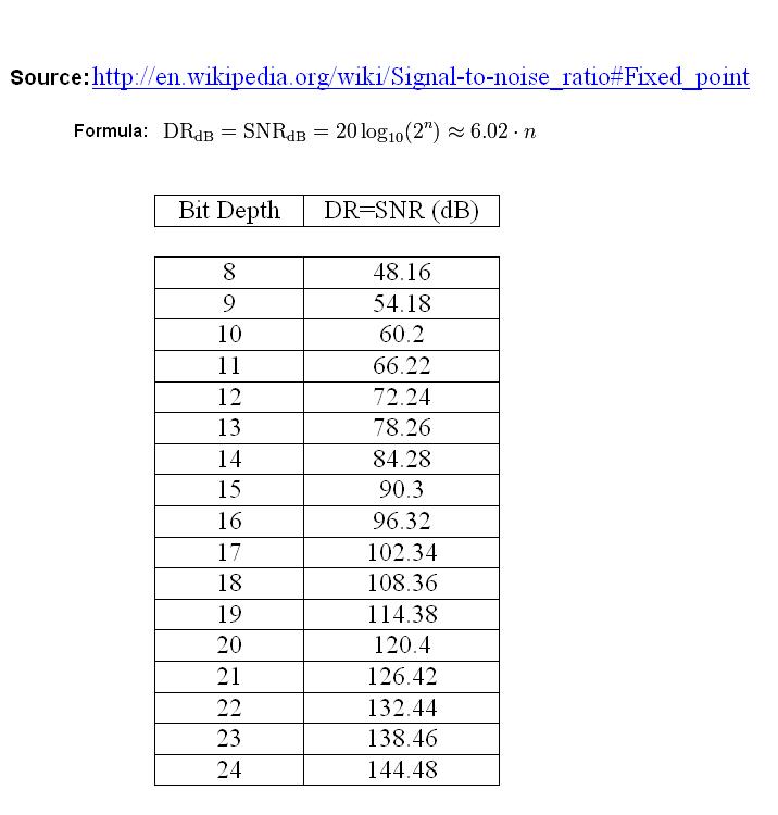

Scopes usually have 8-12 bit resolution.
Wrinkle, thank you.
Although my mind was on analogue oscilloscopes, your response made me consider the dynamic range and the expected lowest measurable signal using anything that contains an AD converter (e.g. a sound card).
So I compiled a table (bit depth vs Dynamic Range or SNR).
It seems that with 16bits one can not look lower than -96dB (ref. 0db of card). It takes 20bit to reach -120dB.
George
Sure you can. Dither and signal average.
Averaging, yes.
Now dither. Hm, I was under the impression that dithering adds to the noise.
Am I wrong?
I have to read on the subject.
Regards
George

Dither adds to resolution: This is important when I do analysis in the frequency domain (harmonics analysis). But is dithering beneficial also when observing in the time domain?
Depends on what you're trying to observe.
Keep in mind one fundamental thing: ALL of the time domain information is contained in the frequency domain information and vice versa.
The beautiful legs of a woman among a crowd of 1000 people.

A posting above may be unintentionally confusing the issue of dither and noise. Dither is composed of noise, but its purpose is *not* simply to make things noisier. Simply adding noise before a measurement helps nothing and detracts from measurement sensitivity.
Dither, on the other hand, is added during the quantization process because it allows signals smaller than the smallest quantization step to be "kept" as information. Without dither smaller signals would be lost. With dither the smaller signals are kept, although they may be below the new noise level. Averaging over longer periods of time favors (repetitive) signal over (random, non-repetitive) noise.
To sum up, dither *makes possible* low signal level measurements, but sometimes at the expense of having to look for a longer time.
Hope this helps some - it's a wonderful subject and a joy to learn about.
