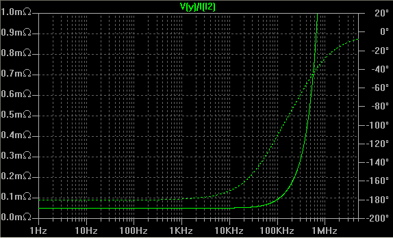

Not to unload refs but to dont load the RC filter by a bjt, and to get a low impedance for the shunt bjt . Drain resistances are used to reduce the voltage across the fet (Low Vds)
Justcallmedad said:
First schematics, those posted by flg where only intended for learning, trying and illustration purposes…
Last ones in post 93 are fully functional Zout is about 0.5R from 0 to a few tenth of Mhz(I cant measure beyond) noise is -150 db from 100hz to 100 kHz (can't measure beyond neither ) and decreasing to -130 db at 10Hz of course there is no feedback "loop", for me the shunt bjt is 100% “feedback”.
New PSU
Really, that last shunt regulator can't be considered "local feedback", but full blown global NFB. The error amp is now the JFET and the open loop gain of this "opamp" is about Beta*(Gm-jfet/Gm-bipolar). Hence, the output impedance (essentially 1/Gm-bipolar) is divided by the loop gain and is at the end of the day about 1/(Beta*Gm-jfet). The bipolat shunt regulator acts as a Gm-jfet multiplier (by Beta).
I agree this discrete regulator has very good frequency response, but still the LF output impedance is nothing to call home about. I am surprised by the noise performance you measured. Anyway, a wideband, low noise opamp like THS4031 in the same configuration and a bandgap reference instead of the LED will do a much better job.

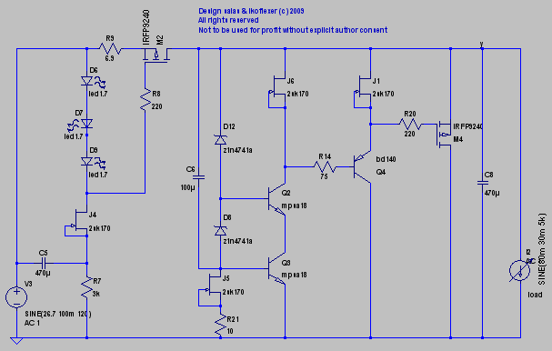

syn08 said:
It might be semantical 🙂
Like in this one. But the jfet is the load in this case. Has a cascode and a buffer, and it does not oscillate, its a working example.

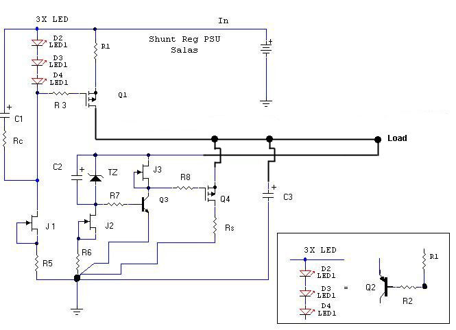

But we believe in Janneman's local current loop benefit and why shunts can do better bcs of that if near the load thing. 😉 So when far, remote sensing! Better than nothing.😀
*A remote sensing example of the simpler non cascoded and non buffered version.

KSTR said:
EDIT: BTW, only one Vbe accross J5+R21?
- klaus
Yes just because J5 is a very low pinch off part. Vbe can be lifted higher with a resistor under the lower cascode bjt to ground if needed. It works as it is with 2SK170. (We had many of them left out from matching in an open loop Riaa stage😀).
You are learning fast 🙂 N channel JFETs have negative pinch voltages; depending on transconductance as well, they can reach incipient saturation at very low Vds. The rule of thumb is: two pinch voltages away from the (negative) pinch voltage is good enough. That is, for 2SK170 parts, Vt=-0.5V => Vds=0.5V is already good enough.
