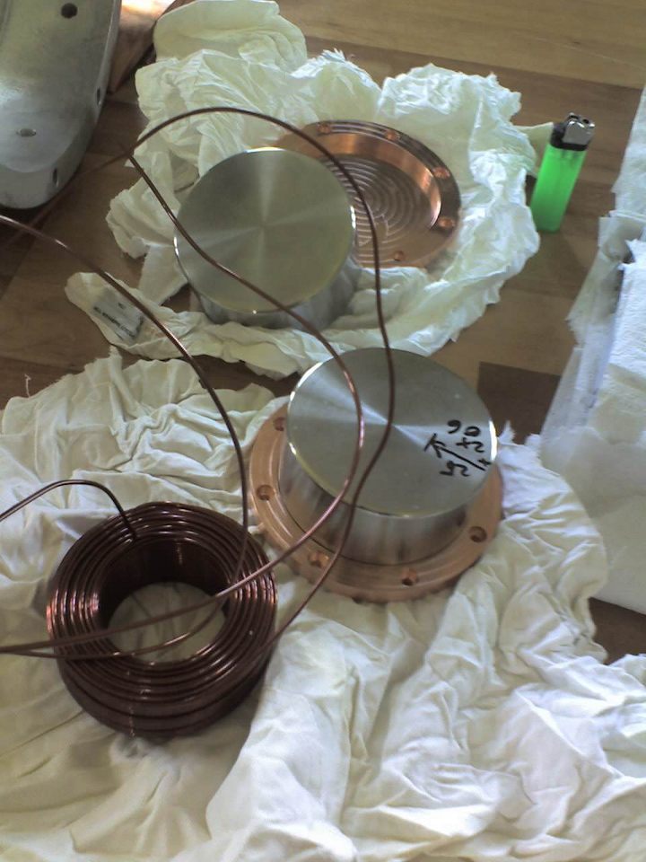

It's actually not all that to shield an inductor. With some help from Dimitri, I made a 5mH shielded inductor for a power amp PSU, some time ago.
It's a mix of ferritic stainless steel and copper shield.
Magura 🙂
Did you characterize the effect on the inductor of shielding it? You would see the inductance change and it would have a saturation point as well. When saturated the shield effectively vanishes so you need to be sure you stay below that limit. Also it will affect the HF performance but the coil pictured will not have the best HF performance anyway.

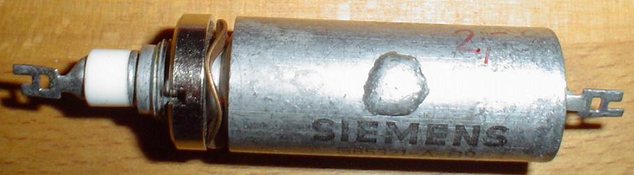

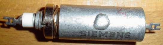

Jacco, he was afraid of quality of a cap used in a feedthrough, so I suggested to make own with a good cap 😉
Hi Pavel,
Given the values you are looking at with a feedthrough capacitor, any low K ceramic material should be fine. Talking about power supply feeds and amplifier outputs, they are low impedance circuits, so even a high K ceramic shouldn't represent any problems. Input circuits should be easy to deal with as well. Wouldn't a length of shielded RF wire act as a feedthrough capacitor the shield was grounded at the point of entry through the casing?
I have used these off and on, usually when dealing with higher frequency circuits. RF amplifiers and switching power supplies certainly rate here.
Magura 🙂

Chris, I use professional HF feedthroughs, they are also a part of my current preamp design, to clean DC PSU output wires thru an Al wall.
The inductance stayed the same, due to the mix of copper and ferrittic stainless steel.
I have not had a need to push it past 10A, till that point no saturation occurred.
Magura 🙂

Magura said:
Thanks Bear.
Ferrittic stainless steel is the type that is magnetic. It's rather rarely used, but for this it made sense.
Magura 🙂
Wondering if the alloy is one of the ones with a high hardness - making it difficult to machine??
