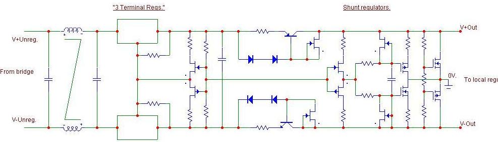

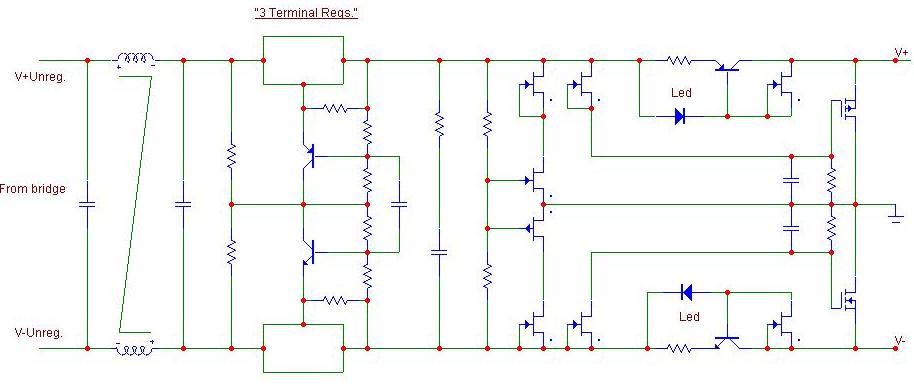

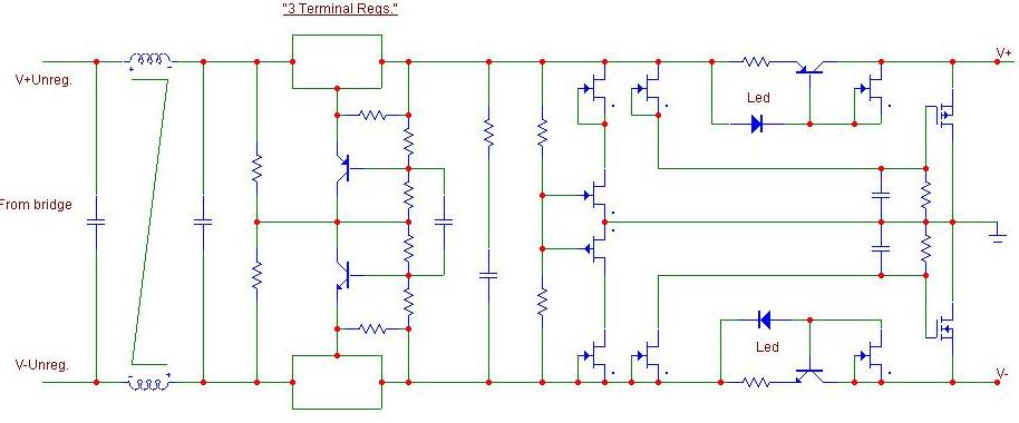

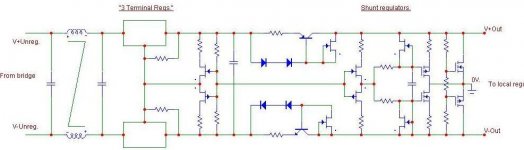

All the above pics were captured on Sept 23rd, 2006.
My filenames were;
PSU_Study_1Blowtorch
PSU_Study_1More accurate ideas
PSU_Study_2 John Curl Wow
PSU_Test1
PSU_Test1Good
in that order.
Hope all this helps

My posted pics were in refrence to the requests for Richard's Schemos from page 23,24,26 possibly, of the original Blowtorch thread. These were the ones I thought worth keeping for future refrence. Just thought I might be able to contribute in some small way for once.

flg – Thank You! I appreciate all the help I can get. Now to link the text comments to the schematics. Should be interesting.

Thank you flg for showing us these old schematics, I lost them when my server “crashed”.
Since then, gradually, I came to these configurations:

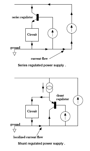

Series PSU
Shunt PSU
Series PSU
Shunt PSU

Jung super regulators are often called Jung /Didden regulators since you are co-author and PCB designer. They have almost perfect measured specifications, lowest noise and output impendance. Inserting open-loop shunt between Jung series regulator and audio stage, as you suggest, will degrade measured performance.janneman said:
No, after! The great advantage of a shunt is that it lets you localize the return current, rather than running it back through the ground wire to the supply input, with the risk that it contaminates the signal ground.
Jan Didden
Well, I would never use an open loop shunt (I'm not sure I know what that is even, is that just a fixed DC current source?). But a shunt can be very usefull if placed near the load because it allows you to keep all ground currents local.
Even with a perfect series regulator, the ground current varies with the signal and has to go back to the supply caps. If more than one stage shares ground wires that can increase noise and distortion.
The ground current with a shunt back to the supply cap is constant (DC) because the sum of load current and shunt current is constant (= the CCS current). So mutual influence between stages is much less. But it anyway depends a lot on the implementation, you really have to know what you are doing of course.

Perhaps someone could explain the function of the the series pass transistor and fet combination that seems to sit on the rails in post http://www.diyaudio.com/forums/showthread.php?postid=1870157#post1870157 ??
I suspect that many readers are unsure how this bit functions without an external reference, or what it is intended to do...
