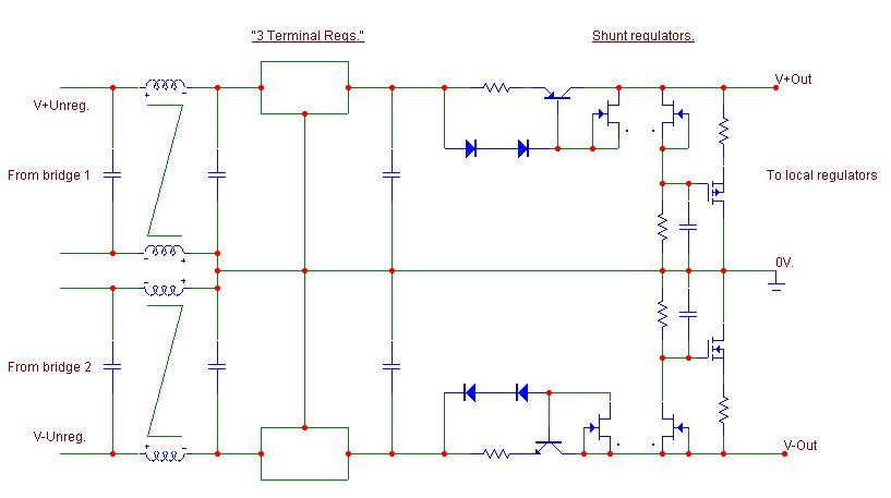

Can anyone post the three schematics that Richard Perez posted way back on the original thread, post 563. There is a lot of reference to them in the following posts and the conversations are obscured without them. Please excuse my ignorance if there is another post that contains them - I hate to intrude, but I’m really impelled to. Sorry to say I just stumbled onto the original thread last week. I didn’t even notice how big it was until it closed and I had to remove my jaw off of my keyboard and put it back in my head. Truly phenomenal, must be a record of some kind. (801 pages-yikes!) Thanks.

Unfortunately, the review of pages 20-30 or so will be difficult for many, because many schematics are not available. Still, most is there, enough for anyone, but 'lurkers, voyeurs, and cloners'. Amateurs, you can't reproduce this design properly, anymore than you can make a hi end sports car, just don't bother.

Opps – Correction and sorry if I stepped on toes, the post by Justcallmedad was post 565 NOT John’s 563 post. Very sorry for the mistake. The link that doesn’t work is "LM317/337 datasheet example". There are a lot of specific references to the three examples in that post. Of course, who wouldn’t love to examine John’s work in detail, but I’m satisfied just to understand what is being shared as are many. It’s certainly more difficult without the once published picture to follow the logic. That's my error for not paying attention.

"No, after! The great advantage of a shunt is that it lets you localize the return current, rather than running it back through the ground wire to the supply input, with the risk that it contaminates the signal ground. "
Good point. If you keep th e shunt localized (i.e. around th e imeadiate gain stage), th e great benefit of this is the reduction in ground line noise.
I think if you drive the shunts with a constant current source, rather than a voltage source and dropper resisters, you get further bennefits.
True, but the current source has to be as good (HF wise) as the regulator itself. Otherwise, stay with a resistor, it's better. A LM317 connected as current source is fair, but a LM337 on the negative side is a disaster.
