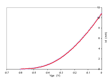

A question about JFETs in general, and those from Toshiba / Linear Systems in particular.
Many JFETs (including those from NXP and Sanyo) are symmetrical, i.e. the drain and the source can be swapped.
I have tried this on BF862, e.g., and it works perfectly.
Does this also apply to the likes of 2SK170s or LSK170s ?
Or any JFETs for that matter ?

You are right.
I was curious, and remembered that I had a few samples lying around.
So I measured one of each.
LSK170 is not quite identical when reversed.
Left (11mA Idss) is 2SK170.
Red line is as per datasheet. Blue crosses are D-S reversed.
Patrick

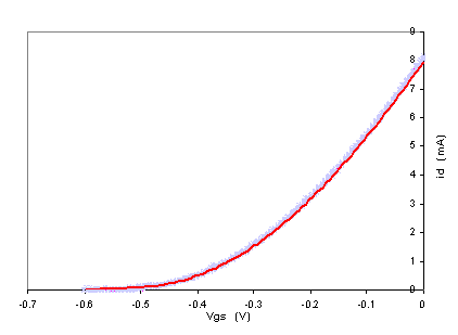

Patrick

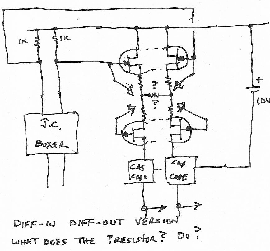

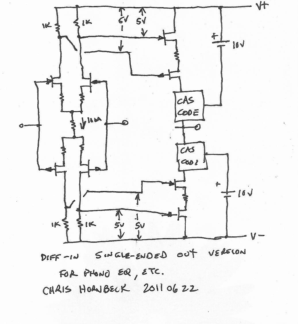

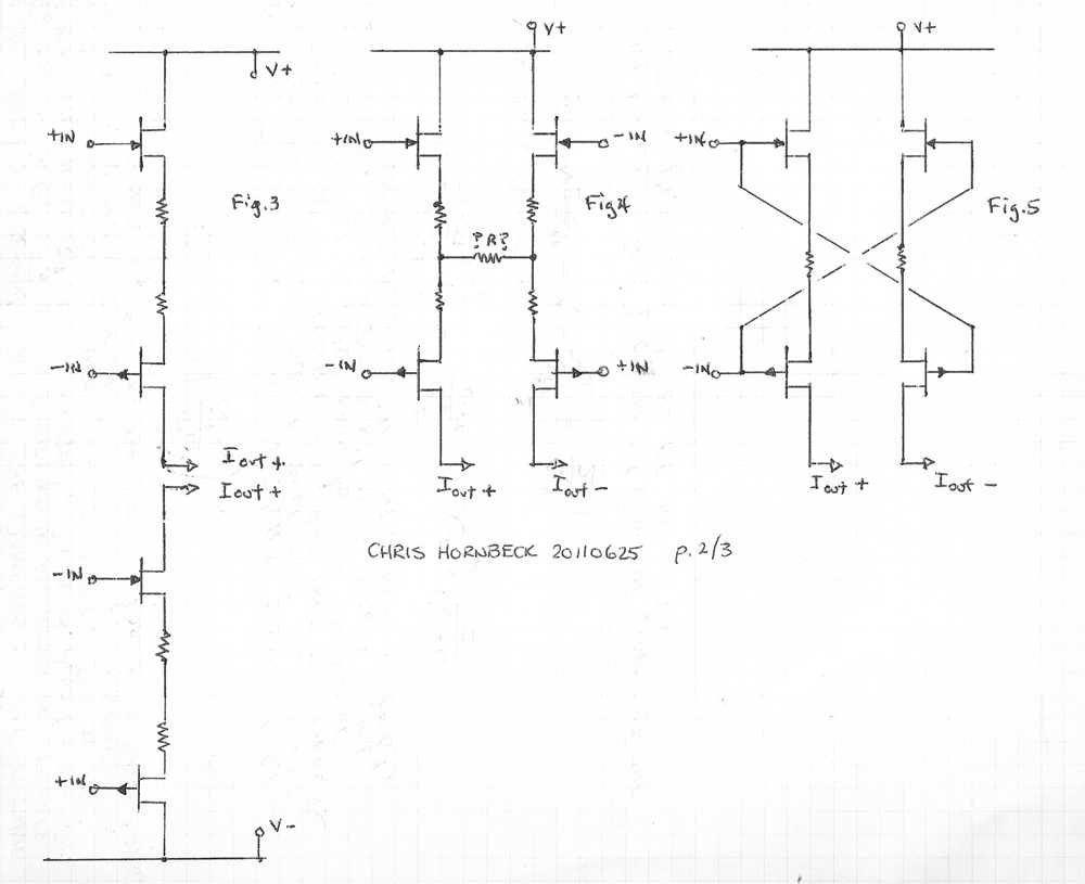

Any comments on the topology above?
An obvious limitation is the difficulty in degenerating transconductance enough for a no-long-loop-feedback line stage. Much more suited for a phono equalizer or a conventional loop-fedback line stage.
The cascoding is important both for linearity and for power supply immunity because inputs are referenced to supply rails.
I've never seen this in print, but probably *somebody's* thunk it up before. Any previous mentions would be appreciated. Thanks,
Chris
Chris
The resistor with ?? marks just came to me
Without the resistor, very little happens.
The resistor allows adjustment of transconductance independent of quiescient current. If the resistor is not there there is no gain at all. 🙂

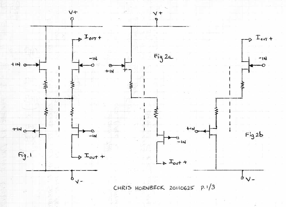

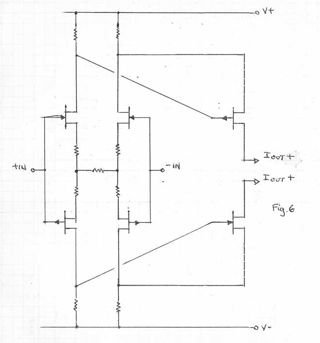

My earlier pictures were terrible, so maybe these will help show signal polarities that are causing my heroes some consternation.

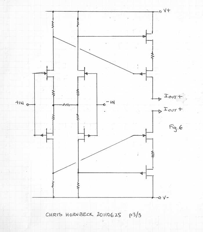

Figure 1 is a simplified John Curl input stage, drawn to emphasize its four quadrants. Figure 2 shows it divided in half and is redrawn in figure 3, diff-in single-ended-out. Figure 4 is the top half of figure 3 doubled for diff-in and diff-out, including the (bad idea, sorry) ?resistor. Redrawn for clarity in figure 5. Figure 6 is a simplified high gain topology drawn with the cascodes that keep it linear. The source degeneration resistors in the second ("VAS") stage must be chosen for proper DC conditions leaving transconductance to you'll-get-what-you-get-and-like-it. Hoping someone might see a way around that foible. Thanks very much for any comments.
I like the "series differential" concept. I saw it somewhere eons ago but this is a good application. Getting this to work will be a real balancing act given the number of matches that need to be sorted out.
I like the use of the Rush Cascode. In order to gain more control about the transconductanceone might deliberatly add some DC between the two gates of the Rush Cascode (tapping the resistors) to either minimise or maximise transconductance, however, I not necessarily see this as being appreciably superior to John Curls original topology shown below.
Ciao T
Ciao T
Ciao T
I don't particularly like the asymmetry of the second stage, what goes up and what goes down are no longer one in the same.
