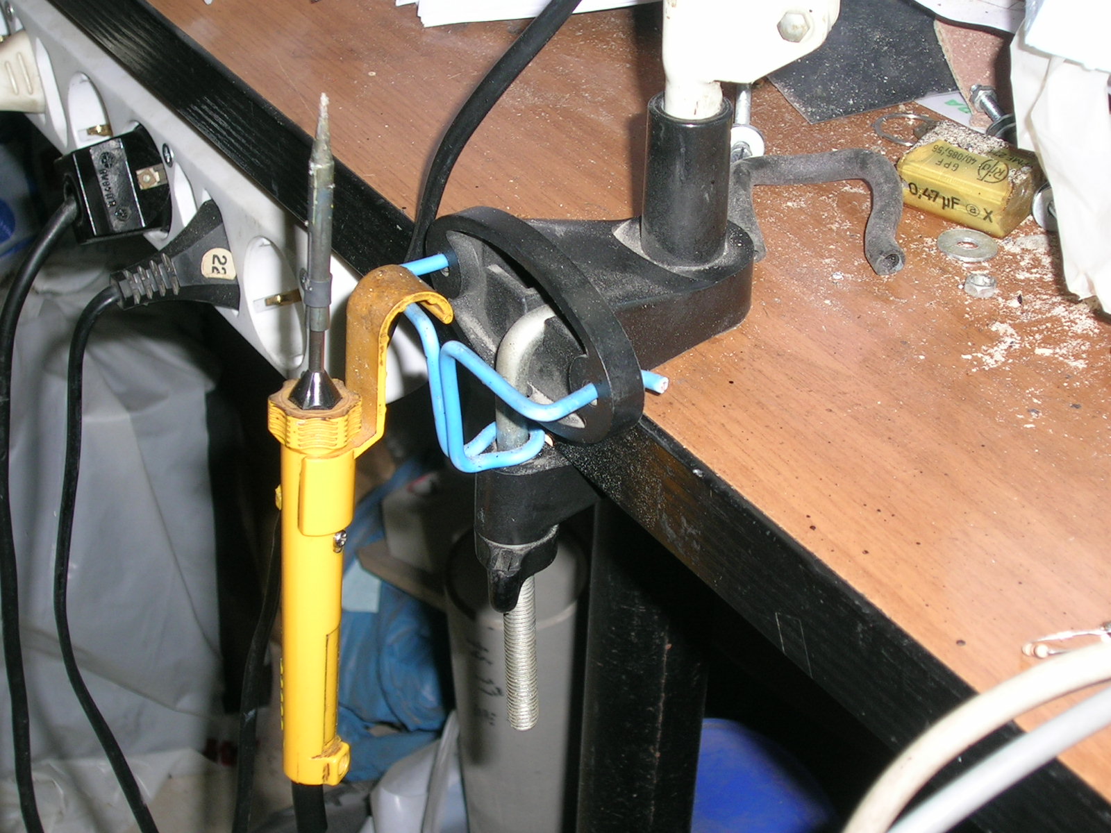

ANTEX anyone? Standard soldering irons --- Antex
I use the same 18W for more than 25 years. 3 heating elements and 8 tips are what it has cost me.
The tips are all iron coated. They last long, they are cheap. The different size/forms work from SMD to speaker binding posts (plus the wire).
When it’s not in my hand, I hang it in vertical position. I haven’t put up a fire yet ( I keep on forgetting it plugged in for days (and weeks).

No thanks. Had one, went and bought a Weller Magnetostat... Actually two (by accident).
Ciao T
It may not meet the eye, but for me, the “beauty” of the Antex is that it achieves good thermal balance without temperature sensing or switching elements. It keeps a proper tip temperature from 5 minutes after powering on, up to days. It doesn’t cool down when I solder and it doesn’t burn the solder when it is powered for long.
The solder flows - over nicely and has a shiny surface
But you may don’t fancy the yellow colour 🙂

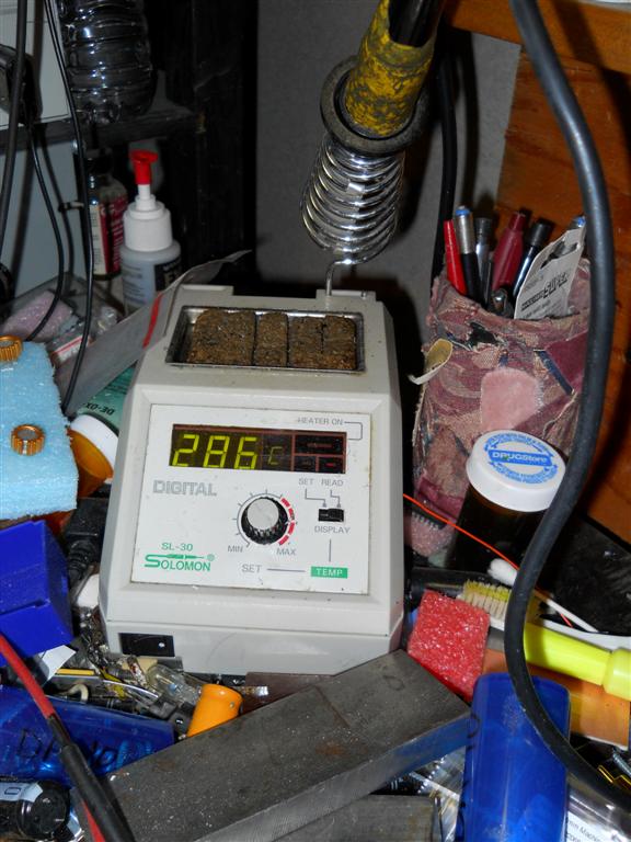

Hi kamis,
Ceramic heater, thermocouple sensored irons have bad temperature recovery and unstable heat output.
I'm sorry, but I don't agree with this statement at all. Why would you make this claim? For example, the station I am now using (for over 15 years) is exactly the type that you describe. So are some temperature standards used in cal labs (although an RTD sensor is common on the better ones). See the attached picture of one cheap but excellent iron.
This unit has a switchable display for both the set temperature and the actual tip temperature. It was possible to calibrate the system in fact. The recovery time for attempting to solder a chassis is pretty quick and in line with what you would expect from a 50 watt heater element. I wonder what the reason for that could be? Hmmm. However, if you allow the barrel nut to loosen, the tip to heater interface to become fouled, or the iron to base connection to become a poor connection, I would expect you to suffer exactly the fault you mentioned. What??! Soldering irons need to be maintained? Say it ain't so!
If too small a tip type is used, you will experience a lack of heat to the tip as well. I have found that the 3mm screwdriver tip is perfect for surface mount work (use the side of the tip for single type connections). For ICs, some solder flux and the 3mm flat makes short work of the job - and it is perfect once you get the hang of it. This is easier to use than my hot air rework station, which is best for removing parts really. Pretty expensive stuff as well. The proper tip and some skill means that perfect connections are even easier to create than ever. I can still do a great job with the Weller as well. They just fail too often for my liking.
Is the RF method better? Probably. Can the other irons do a great job? Absolutely. Don't forget that in the 60s, the recommended method to solder a PCB was to use the wood burning iron with heavy copper wire wound tightly around the tip. You solder with the copper wire tip. It worked well enough for most hobbyists. Better stations existed, but they weren't normally seen unless you were in a factory or rework area. Of all people, John should be able to remember that. A 25 watt soldering pencil was heaven by comparison.
I am extremely unlikely to buy any other iron unless my current one and it's backup dies. It may not be the best, but it is more than serviceable and certainly it is dependable. Sadly, for how much I have spent on maintaining one Weller station over the years, I could have bought a Metcal had I been able to see into the future. Probably still would have bought the Solomon.
It makes adequate solder joins (a lot of Irons do).
But it really struggles even with ground connections that are not massively thermally reliefed (something the Magnetostat Wellers have no problem with) so you end up owning a lot of them. The elements go quickly, as do the tips, compared to my Weller's I have yet to replace an element).
The colour is okay, in my view all soldering irons should be red, to warn foolish people "Hot stuff"...

The electronically controlled versions (as the one i posted a piccy of) had the downside that if you damaged the sensor behind the tip, the more sensible might be to replace the entire solder station.
Excellent point!
Always check to make sure replacement parts are available. They are for the station I use. I was even able to get a schematic for it! Also the iron itself and heaters can be had. I have a new iron assy still in it's packaging - so I should be good.
This model was just discontinued. The new one probably uses a newer chip set (CA3161E and CA3162E in this one).
