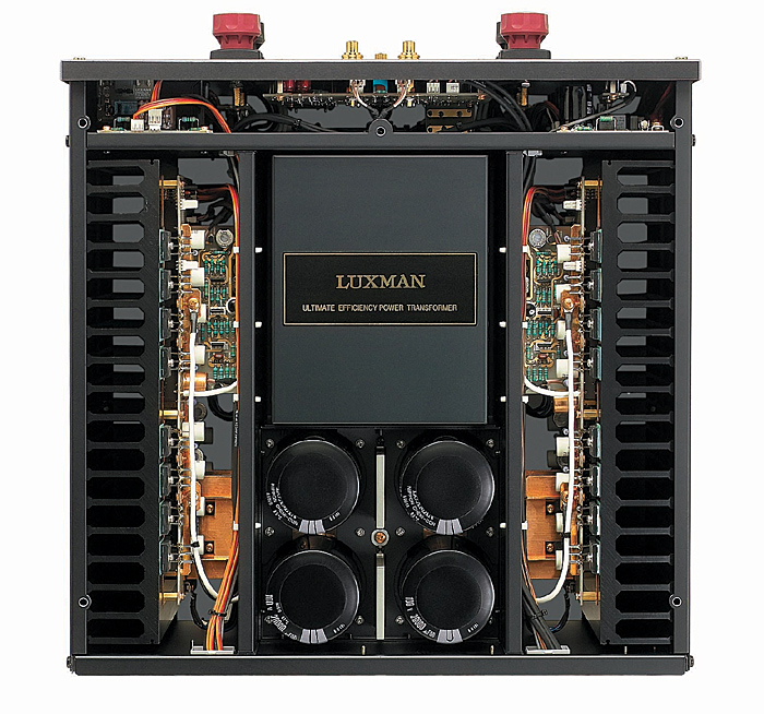

John,
So far, so good, but the 'essence is in the 'triangles'.
The Design is the same "Only Distortion Feedback" as the B1000.
MJ had pretty extensive articles on this. The "Op-Amp" shown is actually no op-amp, but a discrete ciruit.
The "forward" path of the Amp is a simple single ended 2-stage open loop BJT Circuit, driving one side of the output stage with high impedance.
The "Op-Amp" only receives the extracted error, amplifies it suitably and applies it to the other side of the output stage.
Both "Distortion feedback" and "Signal" are mixed at the input of the output stage.
I personally would suggest that contrary to OSTrippers comments the design is quite unusual and interesting. I can see the possibility for it to provide better tradeoffs between "zero feedback" and "ton's of feedback" without attracting the undesirable side-effects of either...
