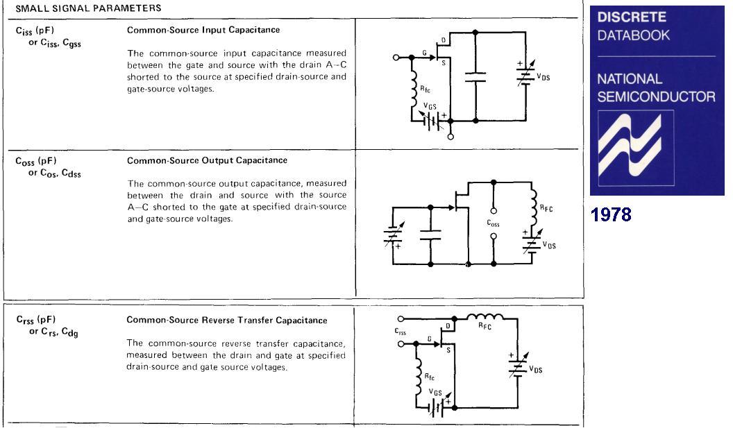

Looking up intrinsic capacitance values in datasheets one often sees the 1MHz stated, I guess that's the frequency most manuf. tests their semis with, and some Vds value, often 10 or 25V.
Found some drawings in an old NS databook, maybe these circuits may help to design a capacitance measurement jig.
some links:
http://pessina.mib.infn.it/Biblio/Biblio_Articoli/NIMA V A469 p 116 126 2001.pdf
https://www.maximintegrated.com/en/app-notes/index.mvp/id/5086
some links:

re measuring C ... with a known series R.... you can figure the C value by the RC time constant you get when dc applied... monitor the charge time.. exponenetial charge curve/time.
