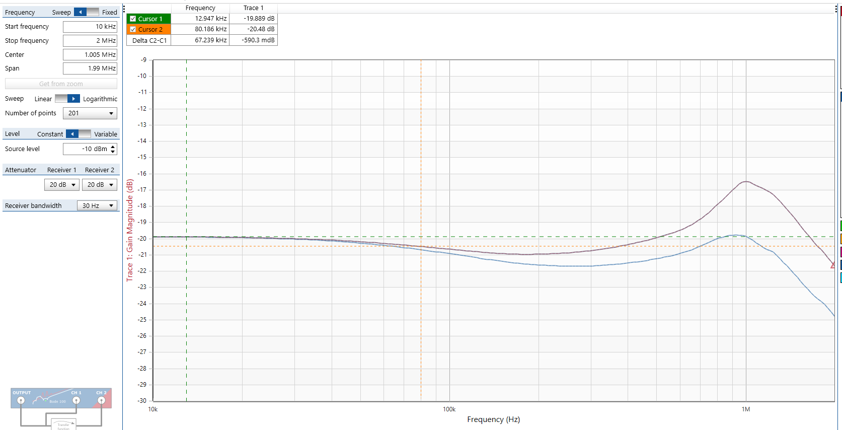

Determine Cout
Can I come back to how to measure output capacitance of the HV amplifier. Not trusting the cheap cap meter I have I tried an indirect way.
In the attached, the smallest BW graph is with an external 56pF cap attached to the output.
Since neither curve goes to -3dB in a smooth way I compared roll-off frequencies at -1dB and got about 80kHz and 135kHz. Can I infer the intrinsic output cap of the stage from this?
Rout is around 2.5kohm.
Edit: accounting for the used test adapters and receiver attenuators, actual mid-freq circuit gain is about 54dB
