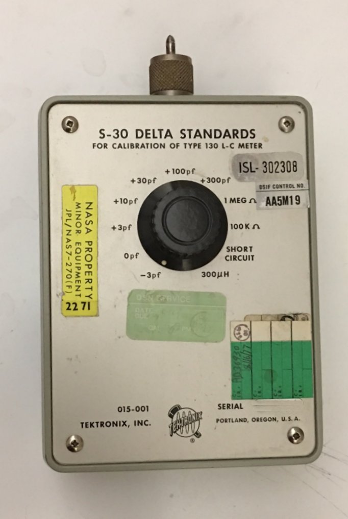

Hemmm, so how does that 130 work? You send the 100kHz signal through the DUT and measure the caps along the way?

Would I be better off taking you up on your offer for borrowing the plug in units?

The Tek 130 resonates the test cap with an internal oscillator and the frequency shift is proportional to the capacitance. The delta standard is for checking or calibrating the 130. I believe the manual is online. Like all Tek (and HP) manuals of the period you can learn a lot from reading it.

The 130 has two oscillators. If you null it you make the freq equal. Then one is connected to the circuit under test which will change it's frequency. They measure the delta in freq and that is a measure of the external capacitance.
