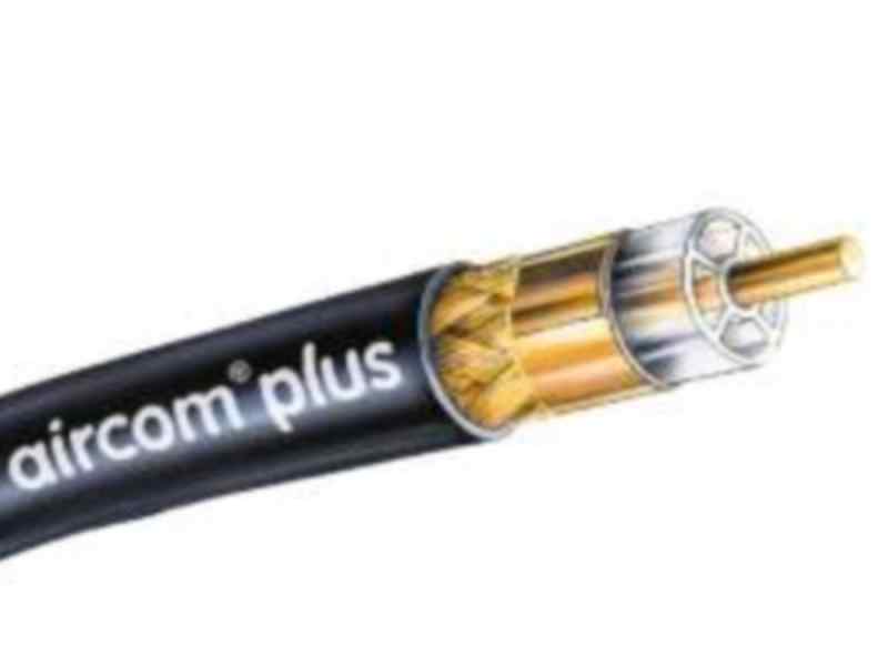

100pF/m for RG213U is more that I might consider sensible for speaker runs unless I was very sure of the amplifier stability. 2.25mm2 centre conductor would of course horrify the meaty hosepipe school of speaker cable as well 🙂
I have once have bought 100 meters of Aircom Plus cable, that is maybe slightly
thicker than RG213 and the center conductor is supported only by a PE star,
most of the dielectric is air. The clerk carried it to the cash register for me
and waited until I had paid 🙂
I used it as a low loss 404 nsec delay line for phase noise measurements.
I put it into a 6 HU 19" crate, using N connectors and then N-to-SMA bulkheads 😀
and could lift that just so.
It is overqualified as a speaker cable, I use just fat twin lead.

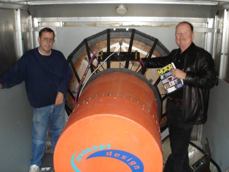

The problem with this line of reasoning is that by nature the transducers have compressive nonlinearities just like the electronics. ...
As we found out when we built the world's largest woofer...
Worlds loudest subwoofers - crank up the bass
We were working with Gene Patronis who had researched the SPL of bombs and other extreme sound pressure sources, and we calculated in the cab of a van we could potentially hit 188 dB, but using his special B&K capsules only hit around 180 dB. Two problems inhibited achieving that goal: the custom 2" thick plexiglass windshield kept blowing out, and more interestingly the air became extremely non-linear since it can theoretically be compressed to infinity at room temperature, but only rarefacted to a vacuum, or 1 bar. This asymmetrical non-linearity of speaker cone movement caused offsets and really odd stresses in the speaker's structure...and it causes an asymmetrical non-linear movement of less extreme speakers as well.
God that was a nightmare project...when we first fired that thing up sitting face down on the floor it began hopping around until someone killed the power...
Cheers!
Howie
n.b That is Richard Clark on the left.
