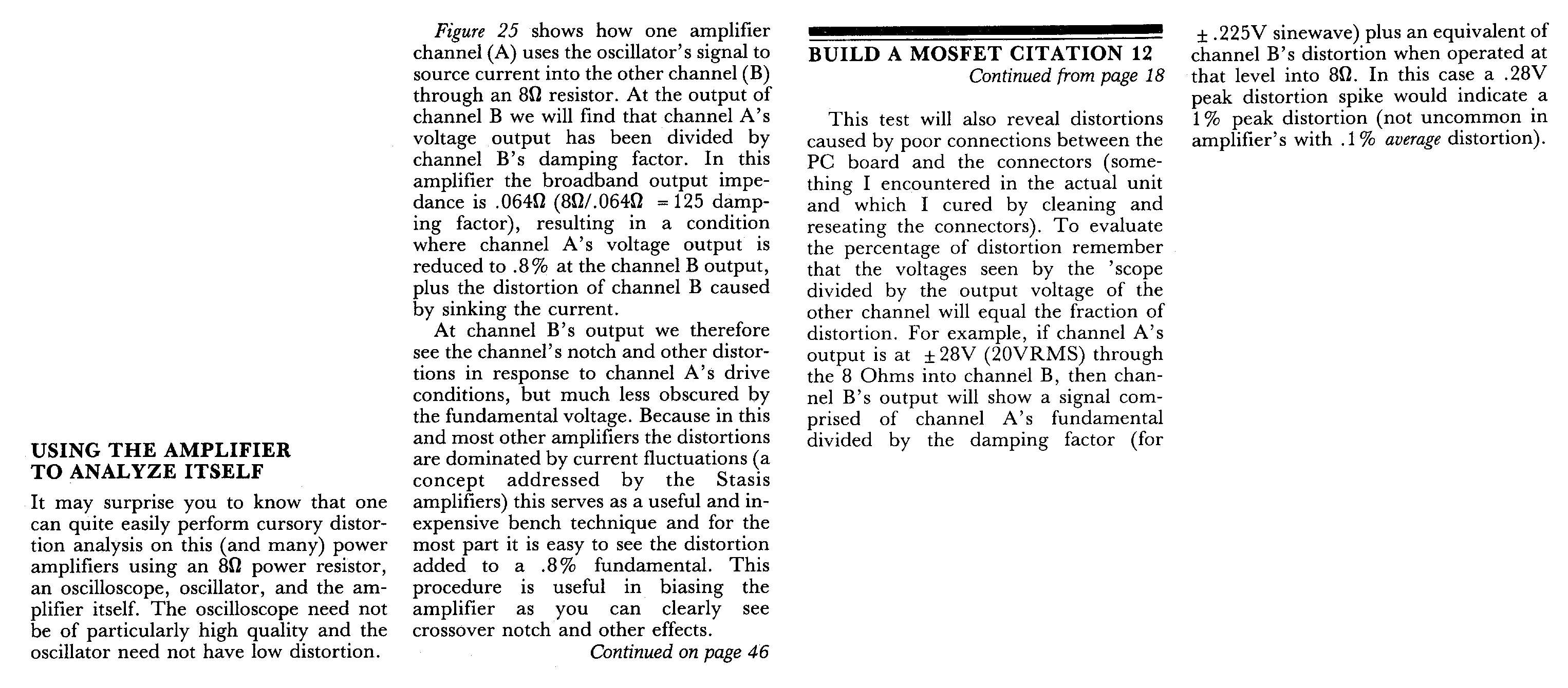

I remember having first seen this use of a stereo set to measure the output impedance of an amplifier in an AP publication (named audio.tst) back in ~1990/1991, but i don´t know if they or someone else invented it.
Here is a chunk from my Audio Amateur HK-12 article from 1981.

Thanks a lot, not only for the information but for the nice idea too.
Who has invented it? Ricola.......err, um... Nelson 🙂
What affect does the non-linear Z of the source have on the data of the DUT output?

First order, it is reduced by the ratio of it's output impedance to the
impedance between the channel outputs, aka DF.

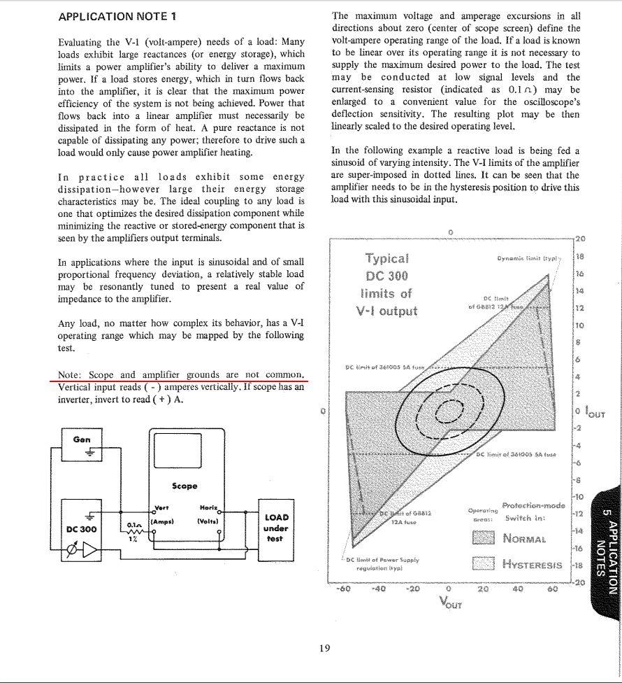

I thought I saw the technique in the mid to late seventies but not clear where. It may have been in the original Crown DC300 owners manual. Not the later version that had lots of material removed.
No but what you remember is a very useful test nevertheless
Pdf page 22 (19 on original)
https://adn.harmanpro.com/site_elem...C-300-Instruction-Manual-dc300im_original.pdf

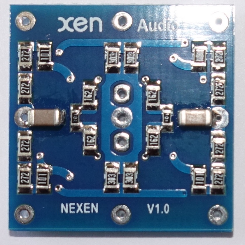

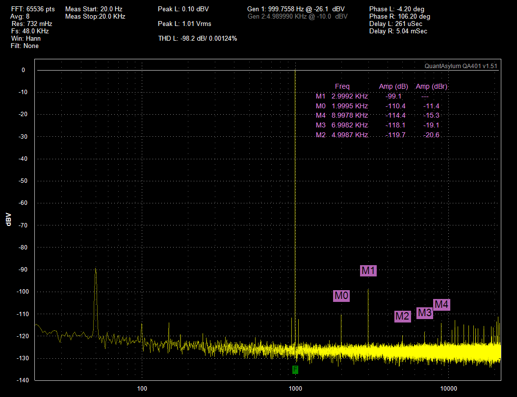

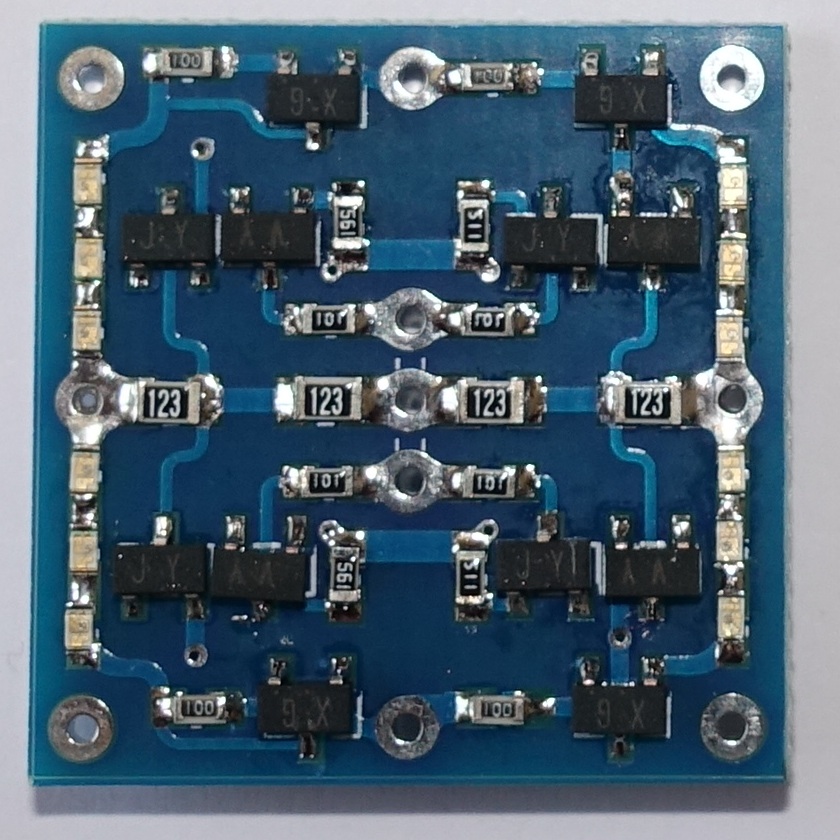

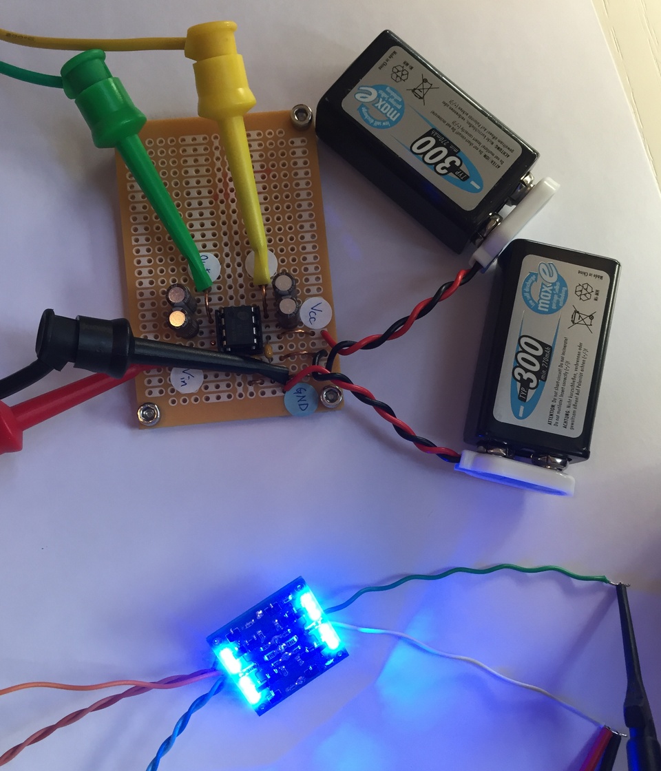

Wanting to know how well a Blowtorch-like topology built with lower gm FETs might perform, we went ahead to get hold of and matched a bunch of 2SJ106Ys, 2SK208Ys and 2SK209GRs.
The frontend diff pair is biased at 1mA, the IV resistor is 15k, and the output is buffered by a pair of 2SK209GR source followers.
Performance exceeds my expectation, especially the low output noise.
And most important it was a lot of fun.
Patrick

The FET models are already in the Spice file.
There is no point in specifying the resistor values as they depend on the Idss of the devices as well as the desired gain.
For our test build, we chose FETs for the gain block around 2.5mA, and degenerated them to 1mA.
The exception is the output source follower, which have Idss~5mA, but the exact value is not important.
As already mentioned, the IV resistor is 15k, and the resistor between the front end diff pair is trimmed to the required gain.
In our case, we used a gain of 10.
Patrick
