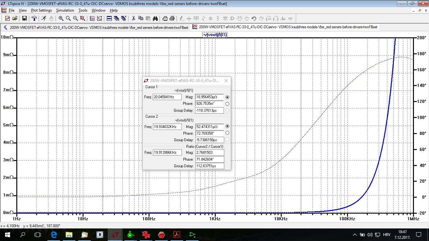

What kind of "nonlinearity" do you expect from an amp able to produce 0.00024% of distortion at 100W 1kHz (100W 10KHz 4Ohms = .0057%) under load ?
BTW, what are the dumping factor and slew-rate (with no input filter nor output L) ?
Yes this is an evil CFA.
I am not sure if second question was for me, but here is output impedance (simulated), no difference with and without output inductor. I use low inductance, just 0.5 uH paralleled with 2.2 ohm. SR is more than 400V/usec.
By the way, the real THD is just 4 to 5 times higher than simulated one.

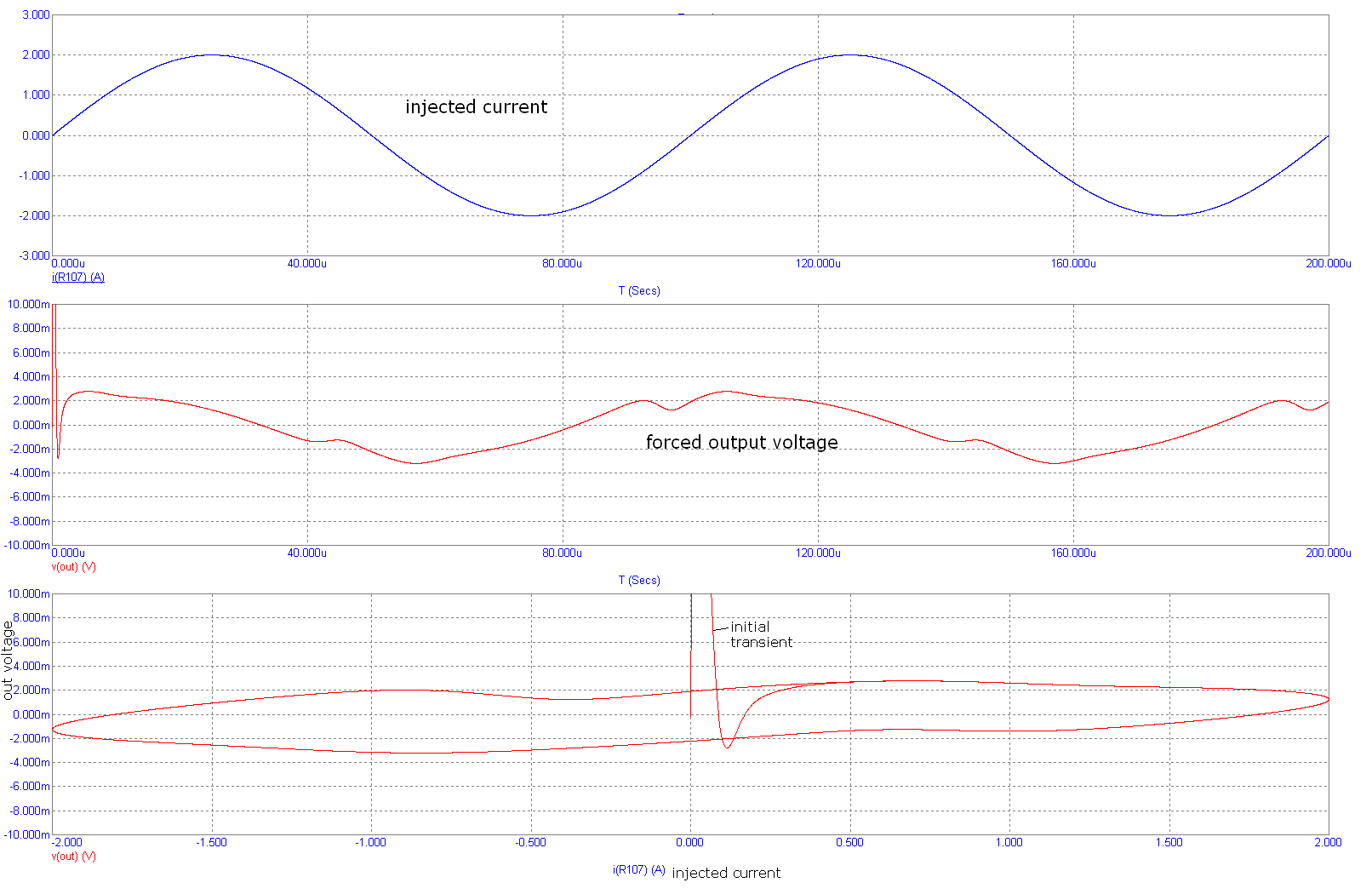

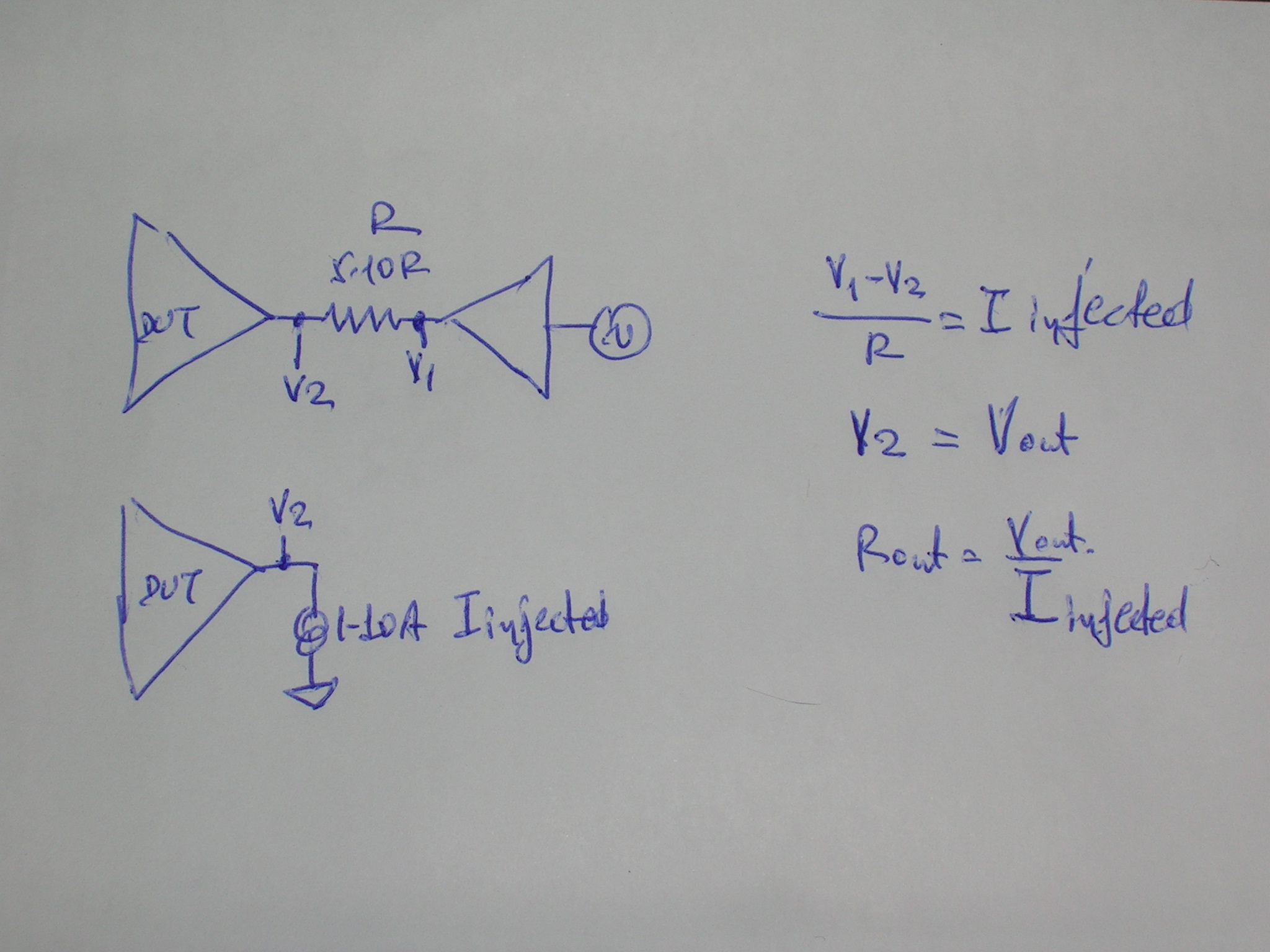

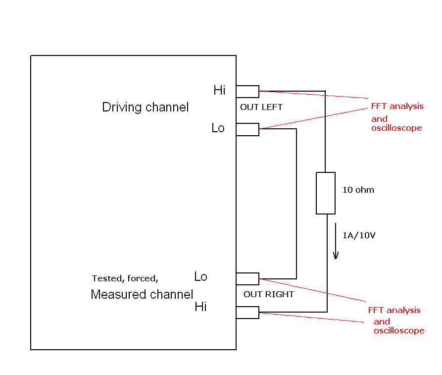

This does not reflect output impedance non-linearity. It is just OL output impedance divided by feedback factor, no level dependence shown.
In case you are interested not only in nice plots, but also in something more useful, put the voltage generator not to the input, but to the output, via say 5 or 10 ohm resistor. Inject sine current of 1 - 10A into the output, measure current injected to the output and voltage at the output terminals of the tested amplifier. You can also make an X-Y plot of output voltage vs. injected current. Make this at several frequencies and then you will see output impedance nonlinearity.
