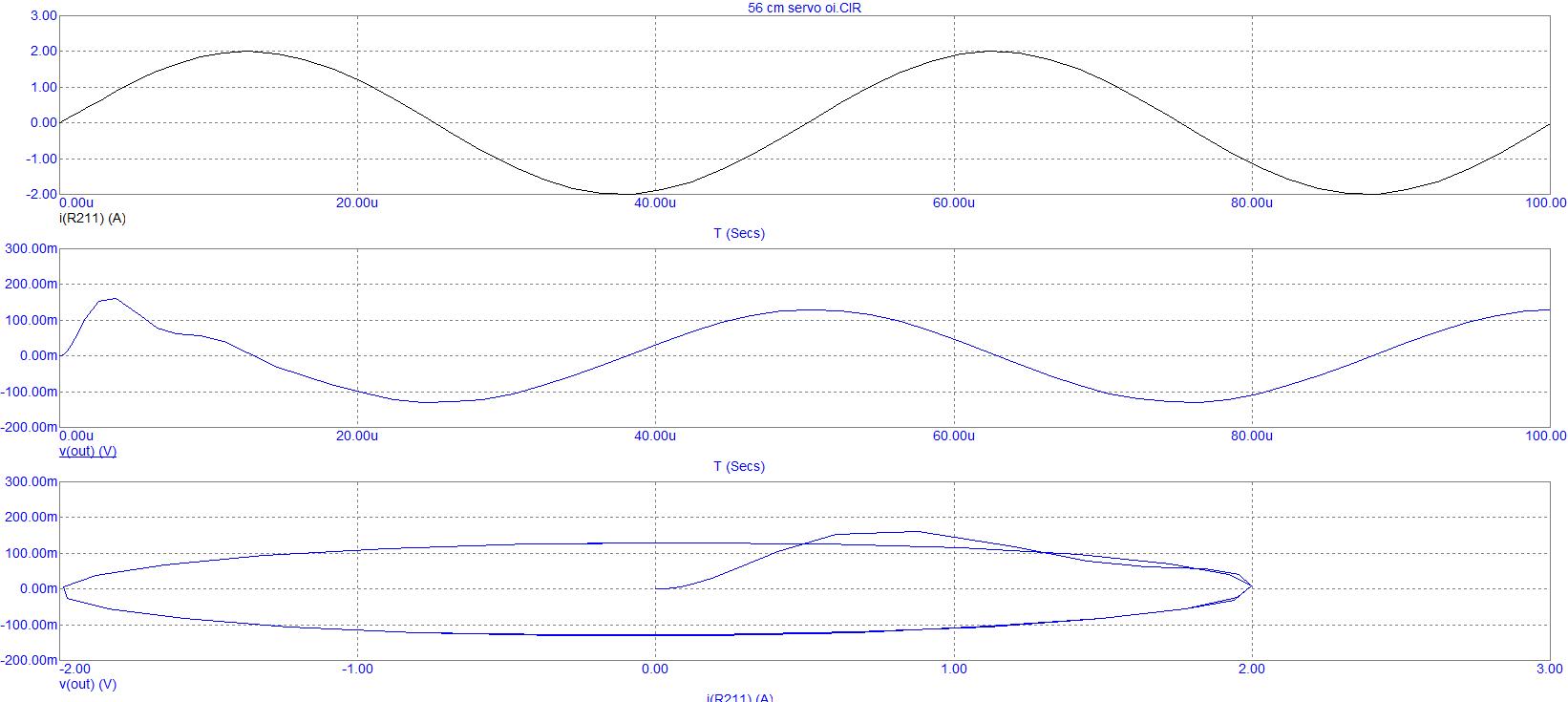

In case you are interested not only in nice plots, but also in something more useful, put the voltage generator not to the input, but to the output, via say 5 or 10 ohm resistor. Inject sine current of 1 - 10A into the output, measure current injected to the output and voltage at the output terminals of the tested amplifier. You can also make an X-Y plot of output voltage vs. injected current. Make this at several frequencies and then you will see output impedance nonlinearity.
Hi Pavel, could you please comment this results, it`s with 2 Ohms load at 20KHz. What could you say of this amplifier by these results? Thanks.

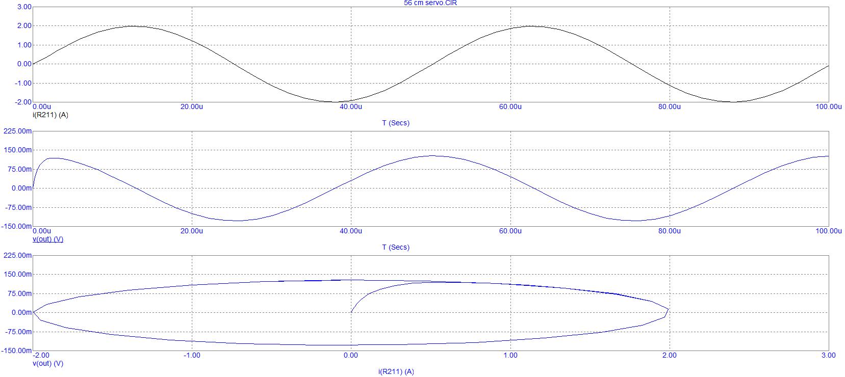

This is the same conditions but with (worst case) 2uF parallel to the load, like in Dado`s schematic example.
Why there is distorted Vout signal only in the first periode and after that looks good?
Measuring the output Z by driving the amp from another amp leaves one question that is not obvious. Does the amps output Z and all its nonlinearities change with voltage? The measurements are with the output at 0 volts. If the output is at +1 volt you might see some different aspects. Also same signal into test and source amp with a phase shift to emulate the effects of a reactive load. Look at the signal across the resistor. This can really stress transistors as well.
The output inductance should be relatively constant since it is mainly determined by compensation. More so with beta enhanced or cascoded VAS.
The output resistance depends on whichever component causes the largest fluctuation in DC open loop gain. This may be the VAS transistor Early effect, output stage Early and Hfe fluctuations, and the bootstrap would play a role if your amp has one.
Output impedance, like distortion, is divided by open loop gain. At higher frequencies it is divided less due to there being less OLG, hence output impedance rises with frequency. The same applies to fluctuations in output impedance, which are divided less if they are fast. The result is the slow fluctuations are attenuated, leaving the fast ones, and you get a spiky looking load regulation waveform.

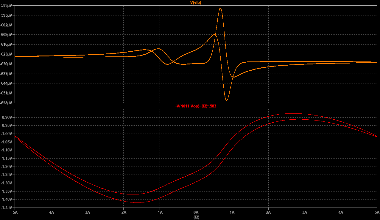

Here is the test done with one of my prototype amps in simulation. Top trace is the output voltage, bottom trace is the output stage error voltage (normalized). It uses lateral MOSFETs. Test is at 10KHz, 5Apeak.
You may think this looks bad. But you should consider that, if I were to lower OLG to smooth it out, I would not be reducing it - for this distortion would still be contained within the new resulting distortions. That is to say, it only covers them up by filling the oscilloscope screen with signal so that you must zoom out and then it looks tiny. But it certainly does not reduce them.

I guess the top curve is the feedback error, bottom is Vout?
Jan
Top curve is the output voltage just like in Damir's test. Bottom is the voltage difference between the input and output of the output stage, but normalized so what you see is the deviation from an ideal resistor.
