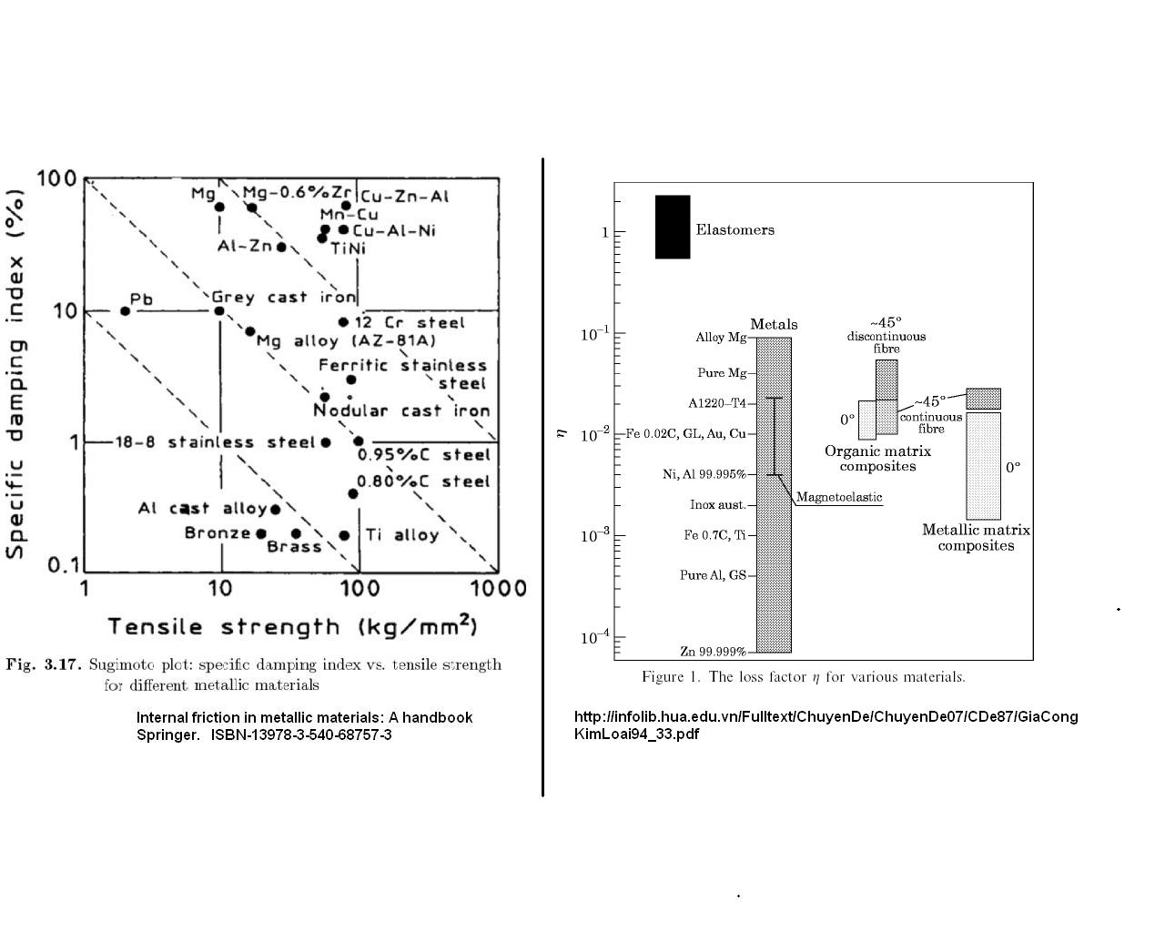

For example, in what order would you place the following metals in terms of its specific damping capacity, from highest to lowest? Aluminum alloy, stainless steel, cast iron, titanium, bronze, brass, mild steel, magnesium, and manganese-copper alloy.

If I understand the chart a U shaped Zinc casting (like a cartridge frame) would have the highest Q and a magnesium casting the lowest? (I'm way out of my depth here) or is it Magnesium vs. Bronze? Or is it not so simple?
It's not so simple. A particular metal will employ one of several different vibration damping mechanisms and the effectiveness of some will depend on amplitude, which is obviously very small in a cartridge. Unfortunately, experimentation is probably the best way to determine which material will work best and that will be tedious to say the least. Considering the large variety of materials used in cartridge bodies, I'd say it hardly matters at all.
John
