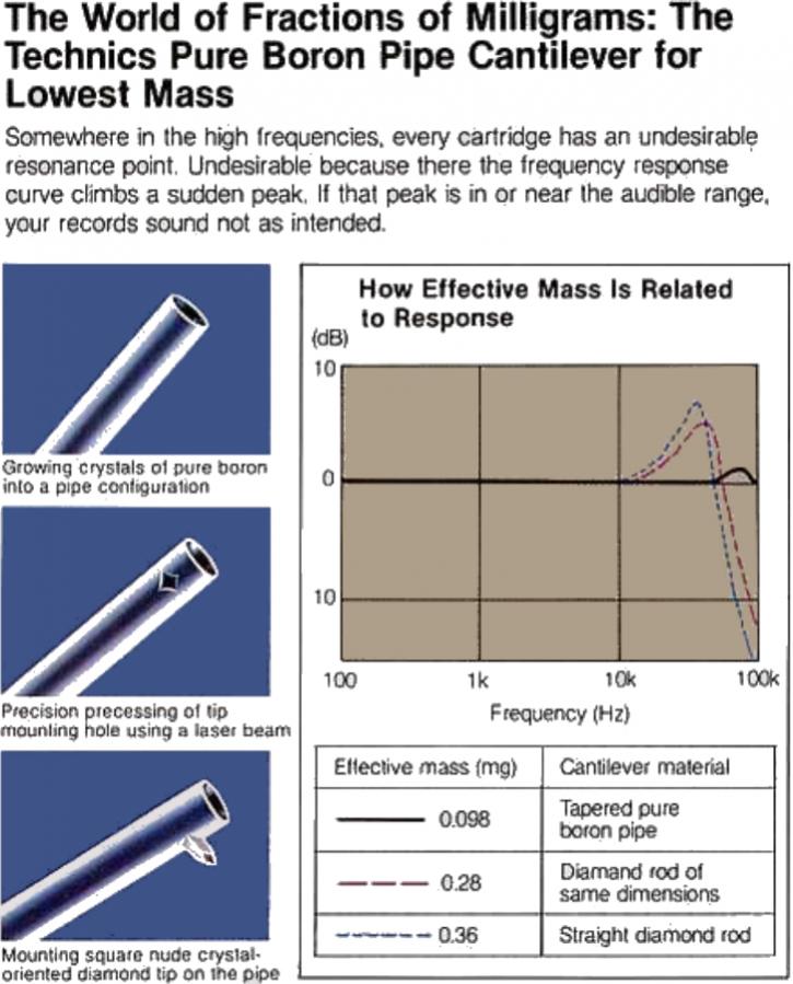

Interesting- the oddball Technics cartridges I've favored (and the Audio-Technica that I have on deck as a potential replacement) were indeed boron cantilevered.
I wonder if the benefit of the diamond coated boron (rather than pure diamond) derives from the lower density of boron?
Boron is de rigueur for high-end cartridges because of it's superior stiffness/density ratio. Apparently it doesn't damp vibration well and different companies have tried a variety of coatings to improve that. AT has used gold and titanium. I believe the titanium was an attempt to add damping without adding too much mass compared to the standard gold plating. Maybe the diamond coating damps without sacrificing stiffness or adding too much mass.

Boron coated cantilever and special elastomer pivot points is good cartridge engineering to me.
But gold-plating soft iron pole plates, or claims that extra exotic magnet composition make a magnet’s field short or long are really depressing.
John, a stiff material like titanium can never provide any damping action.
They could try boron nitride instead.

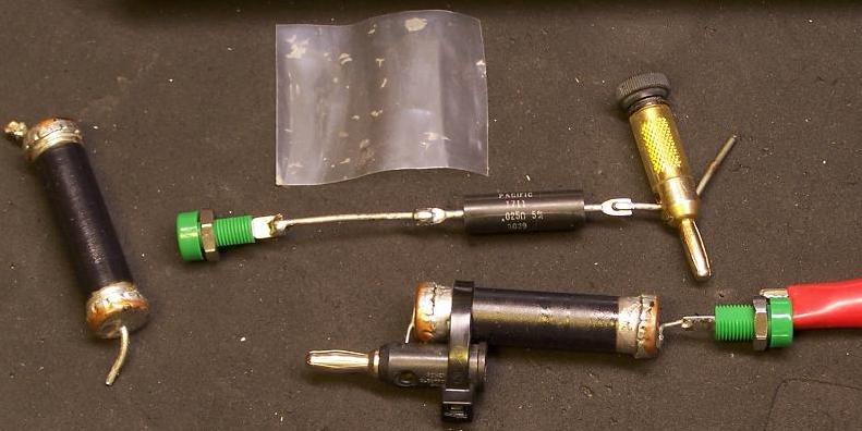

johnf, you should contact Michael Percy, but I would bet that they are .025 ohms. Have been for a long time.
Percy Audio has new stock and the means to measure low resistances. This pair measures 0.0240 and 0.0249 ohms. As someone mentioned, Cal Weldon (who closed the thread) must have purchased the slipstream devices. SE posted the difference in size (shown below).
The leads and body (these large QPs) are not attracted to a rare earth magnet. (Same magnet reveals old Holco resistors non-magnet and newer devices lightly magnetic, inexpensive resistors very magnetic.)

If they deposit with a coating with inherent compressive forces built in then the effective stiffness wil be higher. the trick of controlling the tensile/compressive built in stress is used for engine bearings with good effect for different duties.Interesting- the oddball Technics cartridges I've favored (and the Audio-Technica that I have on deck as a potential replacement) were indeed boron cantilevered.
Wrinkle
Ah, yes. That would explain the diamond coating. However, AT's literature states that the gold plating on their pipes serves to damp resonances.
