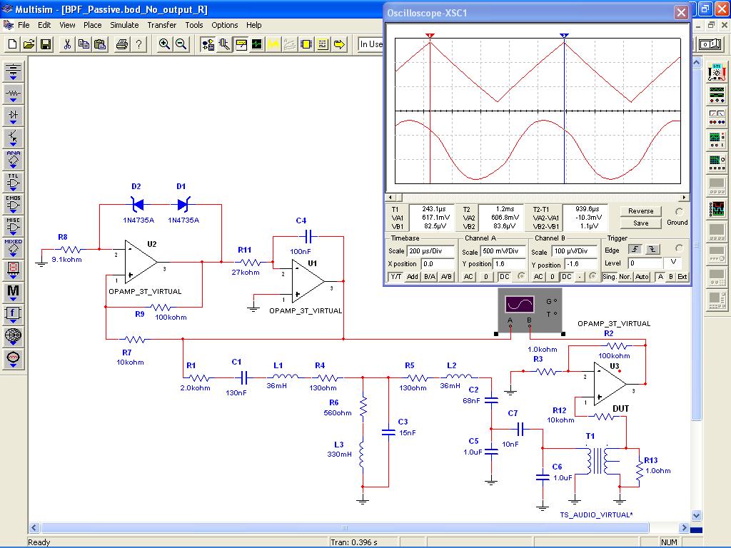

In the mean time this is my thoughts on creating a very low level test signal to try and find the elusive yeti gap. As my scope does 128 averages every few ms it only needs to be 512 times better than that. I decided to start with a triangle wave since that is very easy to get constant level. Also to only look at zero crossings, distortion is not of great concern. As 1/f noise may be a problem I tried to avoid active components and resistors in the signal attenuator.
I show an extra gain stage on the output as the simulator scope really doesn't show nanovolts.

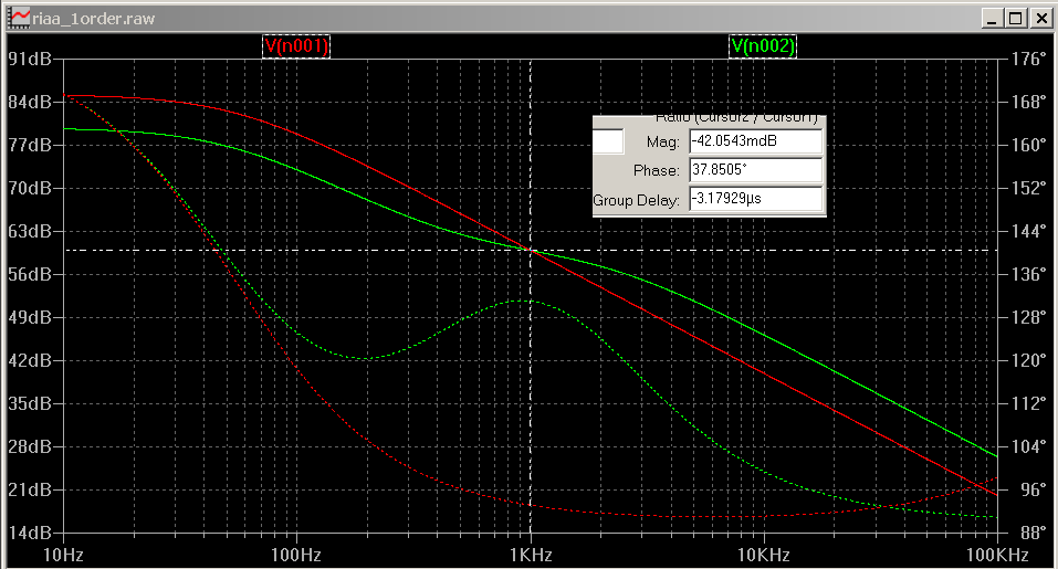

simple Bode asymptote aproximations: ~ 1:4 zero-pole "flat spot" is going to give ~ 12 dB difference from the expected pure 1st order slope of a uncorrected strain gage cart response
could be viewed as 12 dB mid/high cut or +/- 6 dB at low/high vs 1 kHz matched level
but in any case "celarly audible" by just about anyone in ABX comparison with a accurate RIAA played on the same system - pink noise anyone?
it could be excused on not doing level matched comparisons, by just walking into a demo room with unknown speakers/room frequency response - still I would be suprized that anyone with truely trained ears - even many "lesser trained" ears than recording/mastering engineers, techs wouldn't pick up on that much error even if they weren't sure where to place the blame
red single pole response - I assume even though strain gages give DC response any audio system won't like it so I kept the 50 Hz corner
green RIAA, the curves level matched at 1 KHz
looks like 38 degrees, 3.2 uS phase, time errors - where our hearing is pretty sensitive too

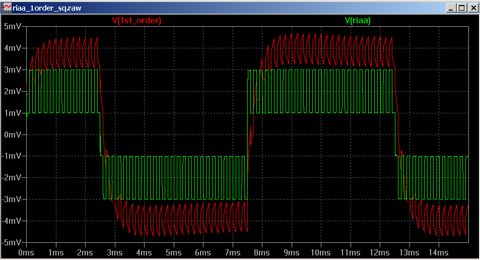

I pre-emphasized 2mV, 100 Hz + 1 mV, 5 KHz square waves and put them thru the 1st order 50 Hz LP and full RIAA eq
with 1 KHz matched EQ levels for minimum FR error you can see red single pole "uncorrected strain gage cart" response is wrong at both low and high frequencies
but what's +/- 6 dB error as long as there's a good audophile story attached?
